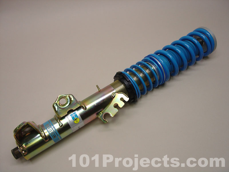

Hi Wayne,
I do not have a photo of the M3 suspension, but here is a picture of the standard e36 front suspension. I hope this will help!
Please let me know.

Now I see your confusion - that's not even close to a stock E36 configuration. I see the problem - you're missing a locking plate on the coil over adjustment. The PSS9 kits have this part - I'm not sure what coilover adjustable shock setup you have (it's not stock), but you need another locking collar.
Let's see if some pics help.
Here's the front setup from a stock E36:
And here's a pic of the front PSS9 kit:

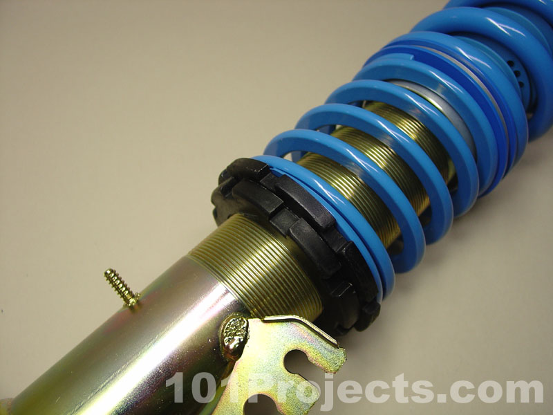

What you clearly need is a locking collar that will mesh against your single collar that you currently have. See this close-up pic:
Does this make sense?

Essentially it is double nutting the lower locking collar. Is that right?

Yup, double-nutting is one way it's often done.
Some threaded adjustable spring perches have other methods of locking them. For instance, the Weltmeister kits sold for the 914 rear springs have a set-screw with a plastic nub on the end that acts as a lock.
