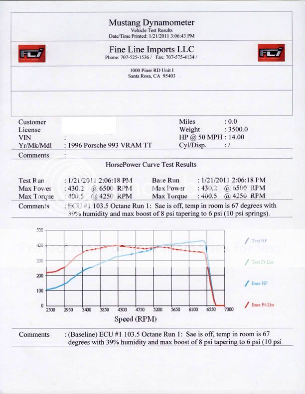

I’ve been around a bunch of turbo 993’s, 930’s and turbo’d SC’s. The latter always seemed to be the most engaging and entertaining. Using a single twin scroll turbo, good cams and proper intake manifolds will ensure a broad powerband and make for a happy response engine.
While I enjoyed the built 930 I drove it seemed to miss the mark on my vision of the 911 as a corner carver. Even my previous 993tt with K24 hybrids had soft response. My current 993 C4S turbo conversion build focused on broad power curve and engine responsiveness. While I give up some power to my previous build the current one trumps it in every other category. It’s VERY snappy and responsive! Lean into the throttle and just a few psi of boost the car responds. Floor it and it jumps to life!
Previous dyno is on wastegate springs only at 8psi peak tapering to 6psi. I now have an EBC set to 10psi. It now holds full boost to redline so it should be closer to 475- 500whp.
Best of luck on your build! You don’t need big numbers to have a fun car. I would trade response for HP any day.
