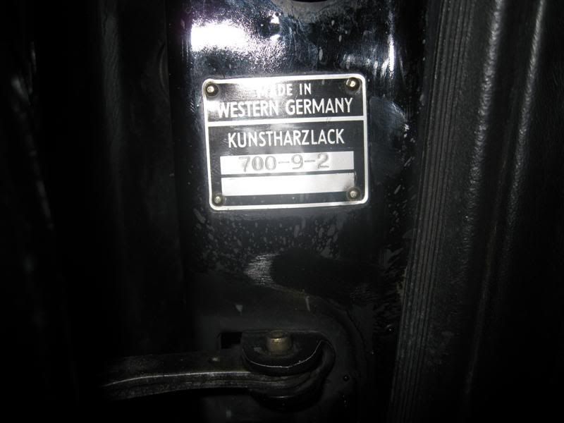

Hello
I just bought a 1976 Porsche 930 from CA. The car is in a mint condition, but there is one thing that is strange. The plate located by the drivers door shows the number 700 9-2. The car is born black with blue carpet. I bought the book 911, 912E & 930 by Mark S. Haab. I can’t get the numbers right? The color black were the number A1 A1. I can’t find the numbers 9-2? The seats are black leather and the side panels are black leather.
The VIN of the car is 9306800480
Can anyone please help?
Thanks
Jesper, Denmark

xxx-y-z
xxx = paint code
y = factory
8 = ??? perhaps Karmann or other coach factory
9 = Porsche factory
z = paint supplier
1 is for Lesonal
2 is for Glasurit
3 is for Herberts
4 is for ?
The A1A1 code is a different but parallel series probably used by marketing. The code on the car's paint badge is the important one. Trying to research this stuff is difficult . A1 and 700 both refer to black.

Thank you so much guys, big help. So the 700 is black, ok I think A1 A1 is the same just later. Then it is the 9-2 number on the plate. It must be black leather and blue carpet? As you ca see, there is not a sticker in the front trunk underneath the carpeting on the inner passenger side front fender.
