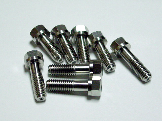

new found respect for Tial products...
Ive been searching for this hardware high and low and found some interesting information. The fasteners that come with our F46 Tial wastegates (direct bolt on) are not stainless as one would think, but titainium. I looked up the prices to these bolts and they are costly. This earns Tial even more respect from me because I see the quality of vendors they use and from a business point of view it is costly to implement hardware like this in their products. Hell yea!

sorry for the bite sized picture...
Whatever you do, do not lose these bolts when you have your car apart! They are expensive.

Are you implying all Tial wastegates use titanium fasteners?
More likely stainless steel if anything..
I really really doubt it.
Maybe ones sold for competition use, but the expense of machined to size titanium bolts is huge compared to regular steel bolts and the weight difference in this quantity is small.

No man- look at the hardware of your F46 gate- this is what comes with them. I have searched the web up and down and finally found the comapany that makes these. Also, the may use them to prevent any bonding issues that may occur between using like metals for the gate housing and bolts. Your right they are big money- about 12$ per bolt. However if buying in bulk, I bet they get them cheaper...
I mean I could be wrong, but I dont think anyone else makes this style of bolt out of stainless-I've looked all over trying to find them.

Titanium is mined mostly from from Russia and hardware made from it is machined to final shape and dimension which also raises the price.
I used to work on Preston Henn's Porsche 962 104, the 4th one made and all the fasteners on the factory cars were made from titanium so I'm familiar with it.
Real easy test:
Take a spinning grinding wheel and touch the small end of one of those bolts to it.
If you see alot of really bright long white sparks it's titanium.
Do the same with steel and there will be fewer sparks and they will be shorter and orange.

No way you can buy titanium bolts legally for 12 cents each.

you know what lol- I got two of them holding my I/C to the mounts- I am going to try the grind test-
I can imagine that it would lighten the hell out of a car if they were used throughout. Did you ever get to drive that car? It is one of my wet dreams to obtain one someday...
The bolts were $12.00 each- not 12 cents, that would be impossible.

Sorry to burst your bubble TiAL uses stainless hardware. The give away is the weight. Titanium would be very very light.

Well Yasin- you didnt have to burst my buble- I did... I did the spark test and got orange yellow sparks which were consistant with my stainless bolt from the corner hardware store...
Then when comparing the weight with the stainless bolt of roughly the same size, they had identicle weight.
Well I am disapointed to say the least, I was really hoping they were Ti, not only so I wouldnt look like an idot, but so it would prove to me that there are some manufacturers out there that are using exotic material for the sake of higher performance. I still have respect for tial as I use their products where ever I can, but I wished those bolts were titanium like I thought.

Here is the titanium harware supplier that I was mistaken for Tial's supplier: Stocked Titanium Fasteners
