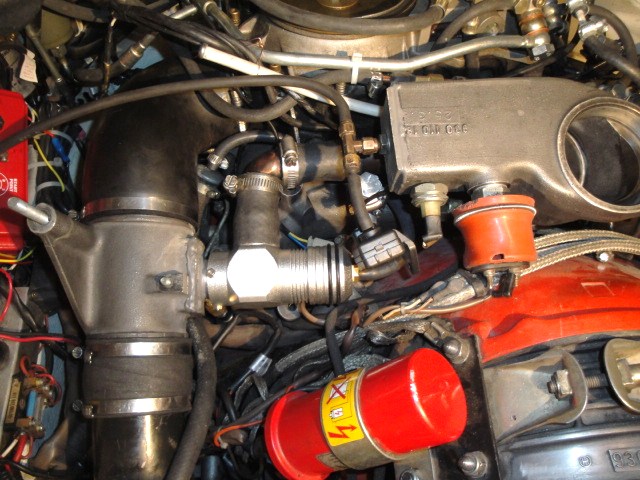

When I took mine out of the equation (well, it's still there but instead of recirculating the boosted air, it just vents it) what I have found is that the rpms drop instantly when shifting vs. hanging up there...which is why I did the mod if the first place. Yes, it will draw air into the mainfold in an overrun condition (off the throttle, vacuum opens the valve). No problem, I simply installed a small air filter on the end. Now, when fully off the throttle, I see my AFR's leaning out as would be expected.
Will this mod make your 930 a ricer and gain all sorts of performance? Not....Just vents a little more boost pressure between shifts and minimizes the 930 "cackle" when decellerating off throttle. That's been my experience anyway.

Now that you've had your decel valve vented to atmosphere for some time now, what do you think? I'm considering doing the same thing to my 930. Mine's a little different because I have an Andial IC. I still have my whole re-circulation valve.
Did you cap off the intake manifold?
Are you getting more or less exhaust popping?
Do you ever have a problem coming to a stop and the engine dying?(something I heard about from doing this)

Originally Posted by 1SIK930 View Post
Mark,
Did you cap off the intake manifold? Yep. See the attached picture of the mouse-nest as I did my recircvalve delete thing. Look at the inner bend of the turbo air intake hose elbow and you'll see the original large vacuum hose capped and tapped with a smaller vacuum hose which I am using to actuate the BOV (in this pict I hadn't yet installed the decel valve)
Are you getting more or less exhaust popping? I never really had any popping prior to the delete, and now I might get a pop or two once in awhile. So I guess maybe just a little more popping but not at all obnoxious.
Do you ever have a problem coming to a stop and the engine dying?(something I heard about from doing this) No issues there. I would think a simple mixture adjustment would remedie that.
I run a small air filter attached to the free end of the decel valve, just as insurance against drawing in any unfiltered air.
