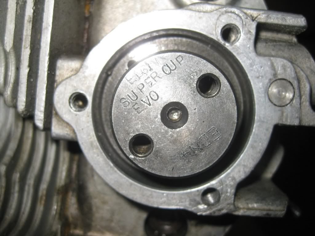

The heads are NA 964 heads or at least I assumed they were. Here are a few pictures of the Long block.

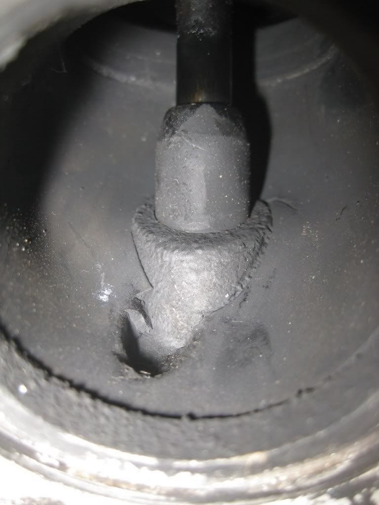

Yes, the stock 964 heads can be reused...
(a) if there is no cracking in the ceramic exhaust port liners, no chunks missing
(b) the heads get some modifications to take the heat: sodium-filled exhaust valves & new guides, better valve springs (always recommended).
Other mods are available, optional but not required at your modest power goals.

I just noticed something that I had a question about. If you look at the picture above with the top of the engine shown, you will see that the cylinders have a spacer about .25" thick between it and the case. I did a vague search on this but didn't come up with anything. What are these spacers and are they normal on a 3.6? Cylinders and pistons were said to be factory turbo units.

That's because someone has decided to use the 993TT pistons & cylinders for this build. The 993TT cylinders are shorter; the top most part of the cylinder is incorporated into the 993TT head.
The cylinder base spacers are unconventional in 911 builds, and common in air-cooled VW builds. The 800+hp car we built had some billet aluminum spacers when it came to us, nicely machined with factory o-ring seals. We reused them, no issues.

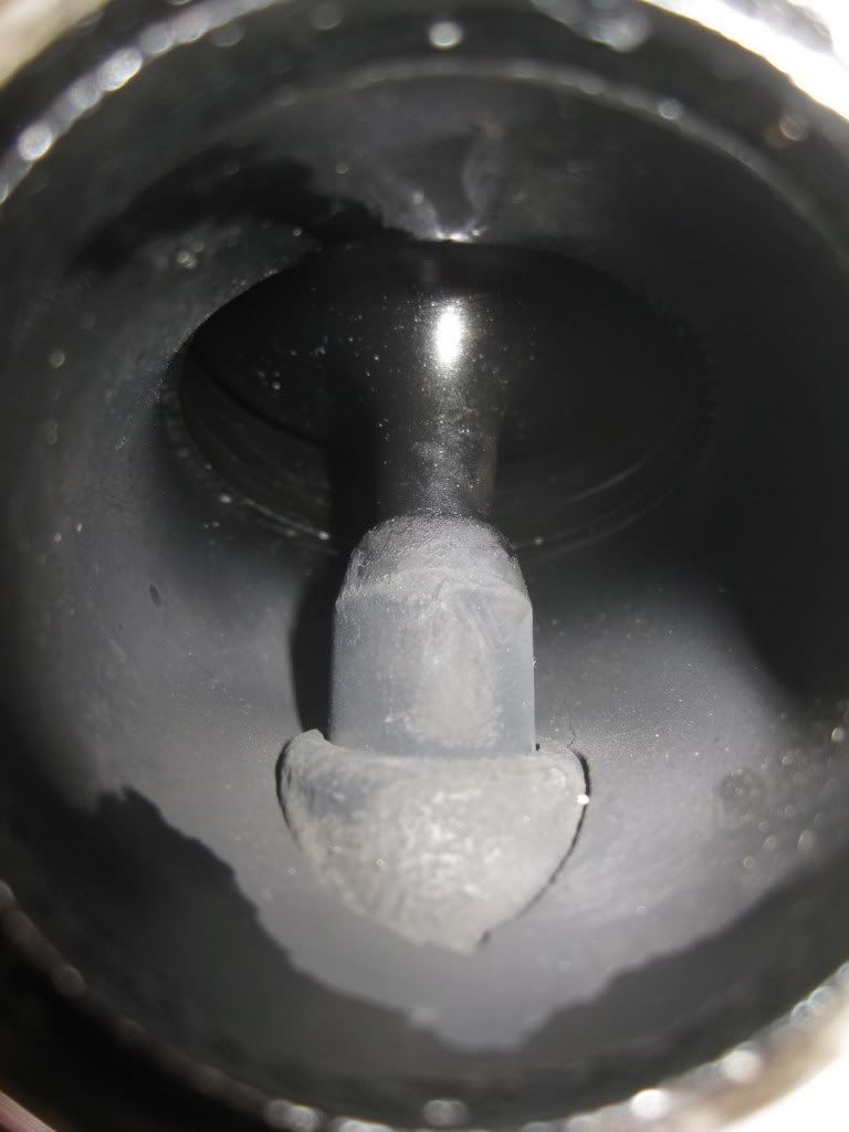

Chris, I just got my engine up on a stand and flipped over. I am a bit worried now but maybe it wont hurt too bad. The front two cylinder heads have some damage to the ceramic exhaust ports. Can this be repaired or would I have to find two new cylinders and have them modified to match the remaining cylinder heads?

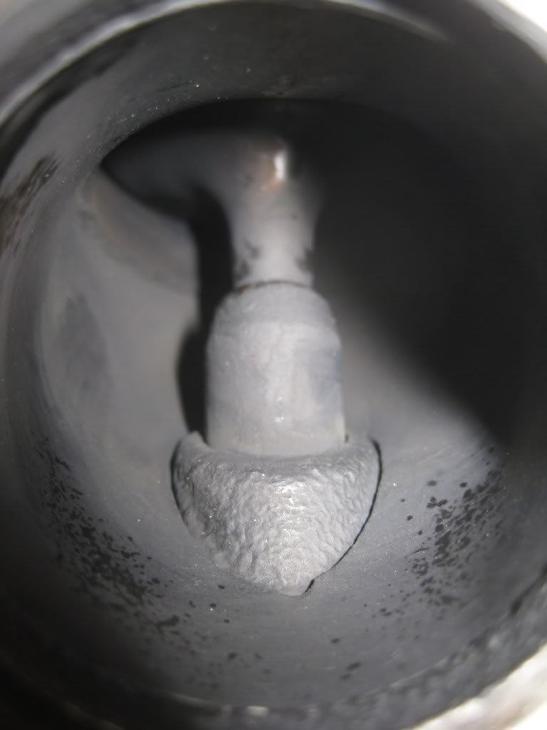

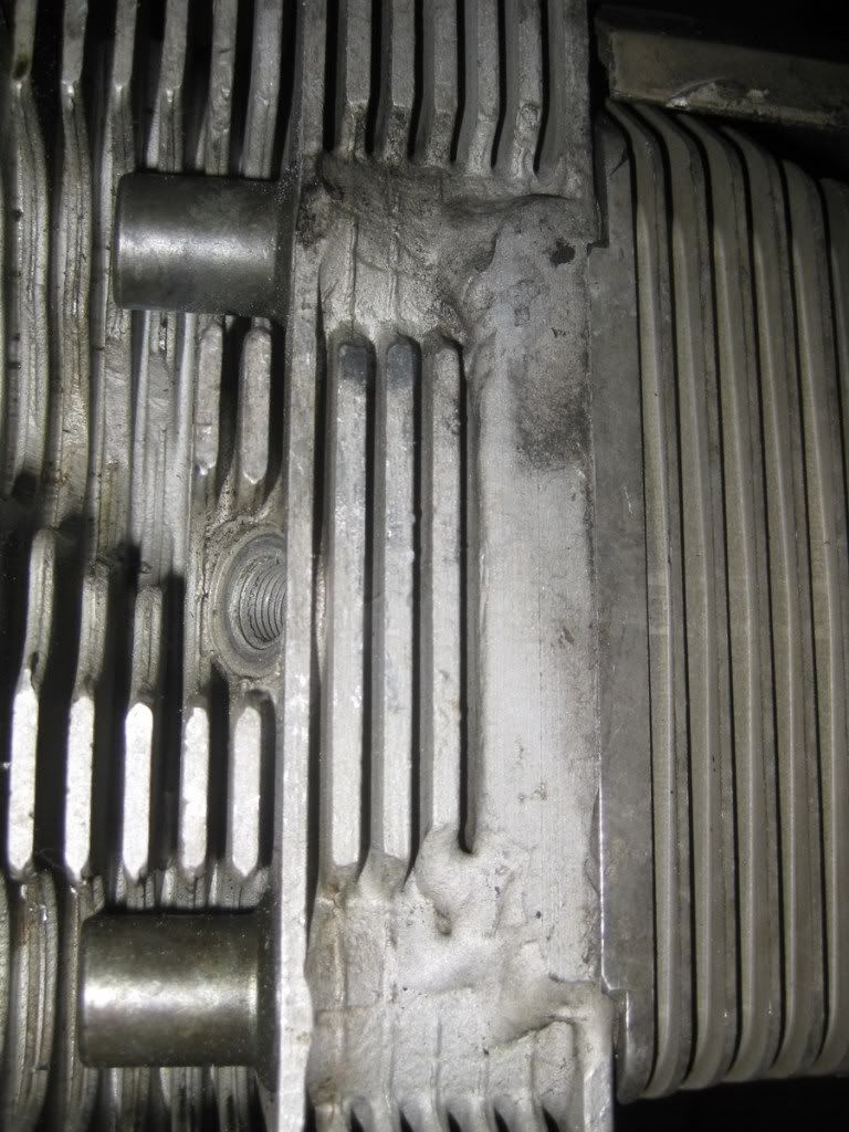

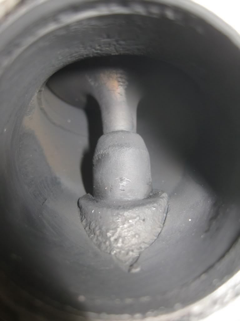

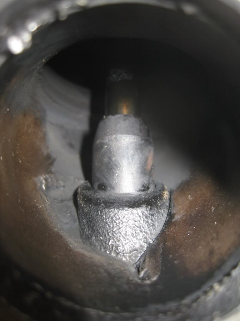

Here are some pictures of the exhaust ports two of which have ceramic chunks missing. This is not the only issue I have with the heads. I just realized that the intake ports have been ported out to 48mm being this engine was used with ITBs. I have some ideas on how to work with this but I need to do more research to see if they will work.
Also, the heads have some welding done on them which can be seen in the picture. This is not factory is it?
