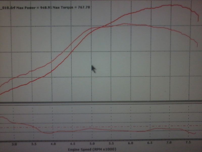

just got off the dyno 27psi 948.9 hp 767.78tq 32psi tomorrow the turbo respond faster than before. it making 52hp more at 3500rpm and 80 at 5100rpm and carries it to 7000.i want to thank FP for all his help GT35 HTA Absolutely the best turbo on the market. i email the dyno sheet to juan

Congratulations, Eddie .. 161 is hauling butt. I know Matt appreciates mention of the GT LSD solving your handling and diff breakage problem. I'd heard about the previous string of bad luck ..

Wow! This is wheel-hp right?
I remember an older dynorun of 1200hp from you but that may have been crank-hp?
Always good to gain lower rpm torque What typ/model were the previous turbo's?
