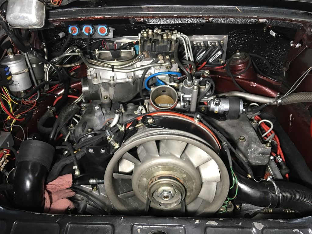

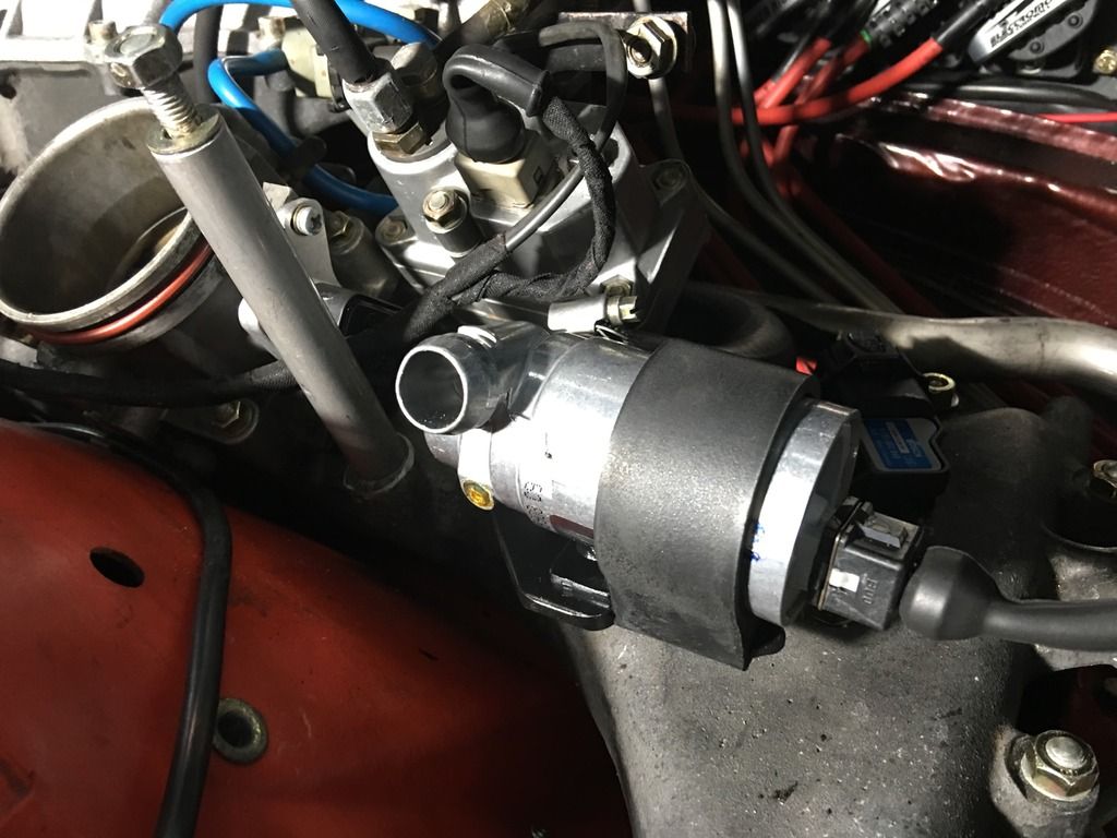

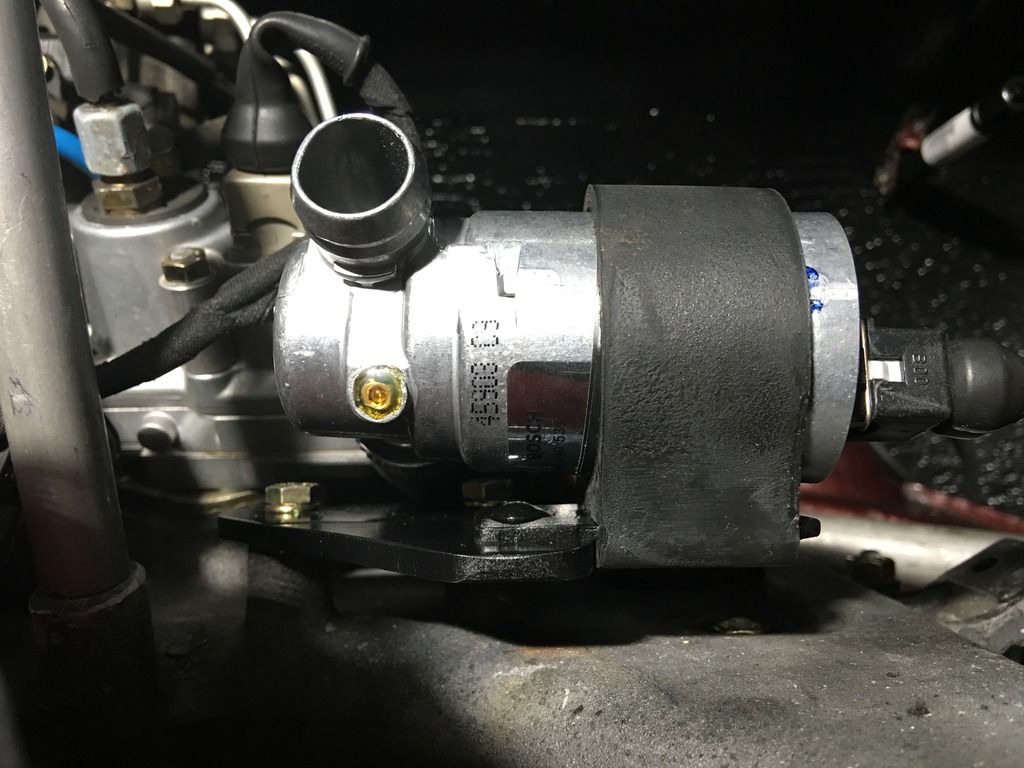

kenikh 12-18-2015 05:09 PM
Going down a game trail on the slippery slope: decided AAR is a stupid design, so replaced it with a factory 964 turbo IACV. The upshot is no more bu!!$h¡t idle weirdness.

kenikh 01-06-2016 01:36 PM
Got the 964 turbo IACV working today. It is just amazing what a luxury a dynamic and responsive idle controller is when you can take temp and throttle position into account.
