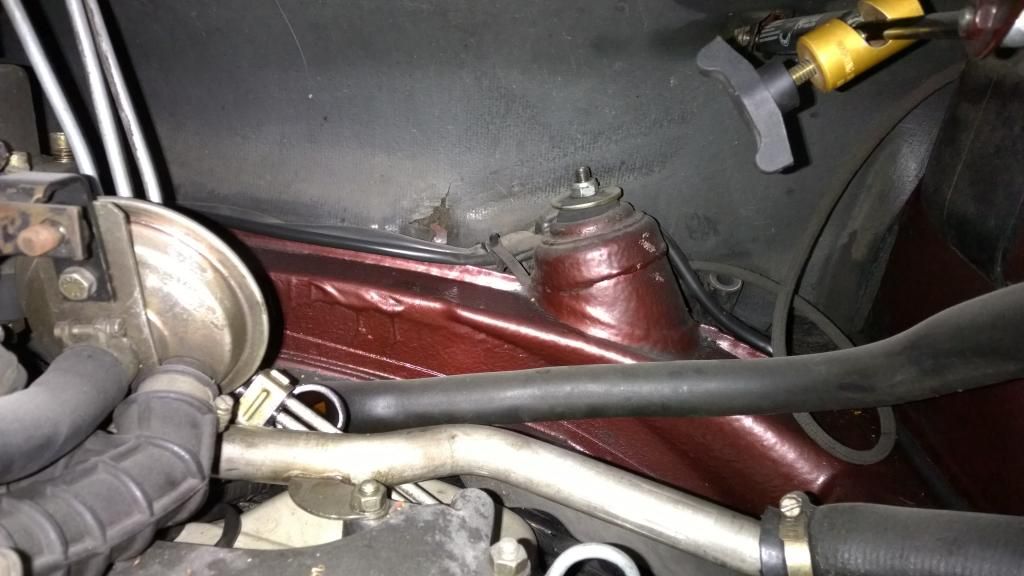

BTW, you will probably be the first person outside myself and Bernie to drive it first, Bryan.

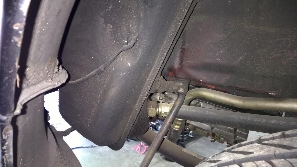

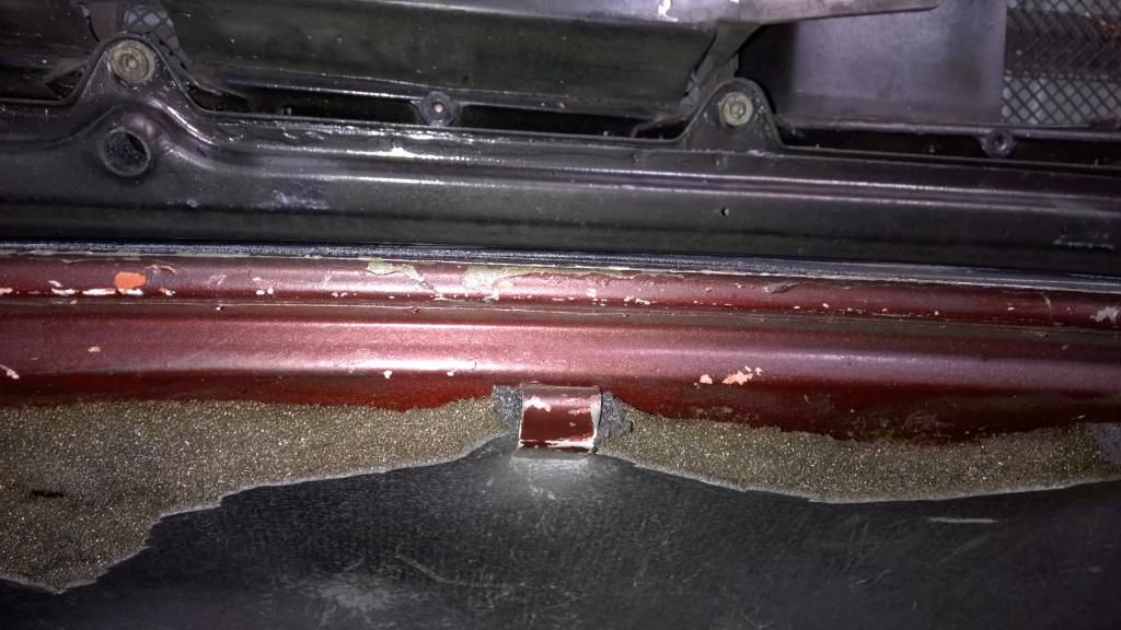

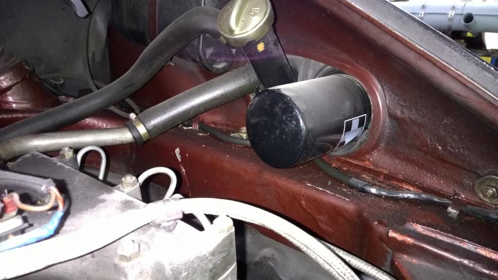

Back to the color. Took some shots today of the areas of the car that you can still see the original. My mechanic buddy (Bernie) is convinced it is a paint to sample color. Here are the shots:

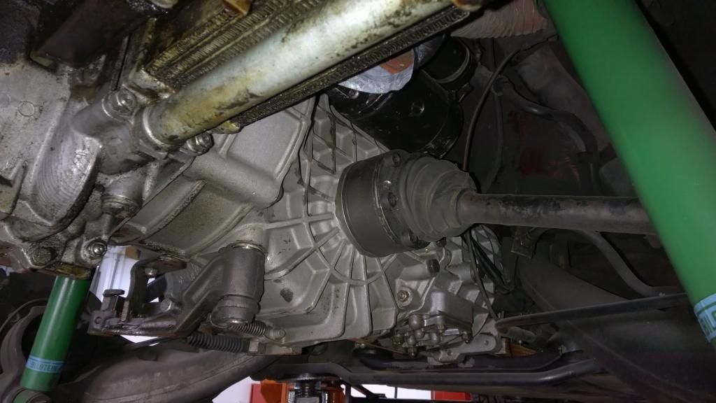

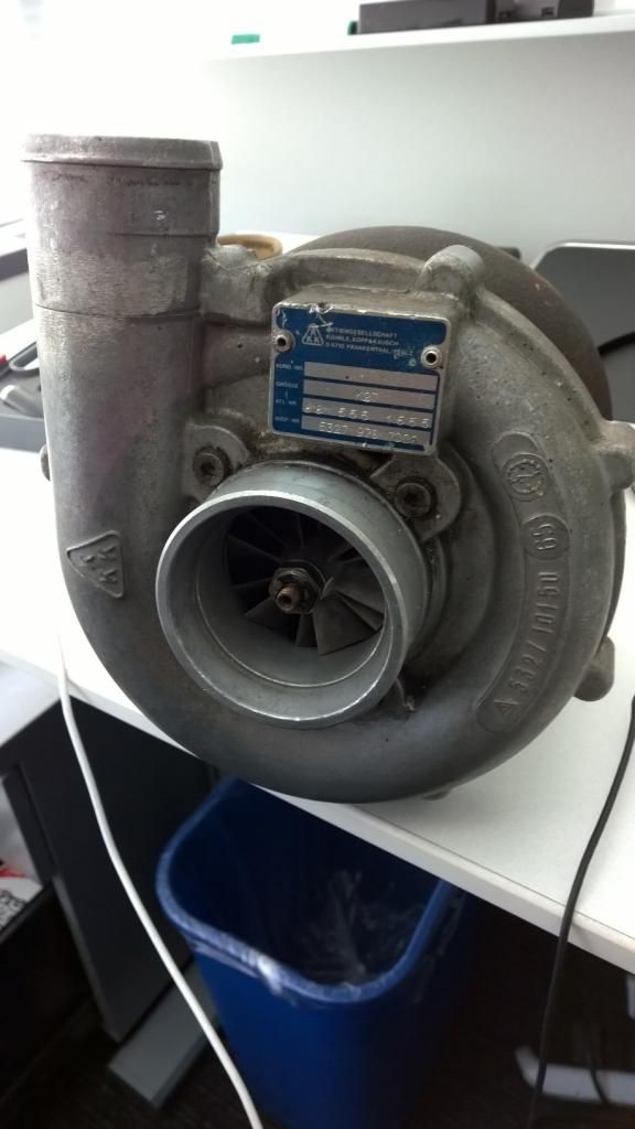

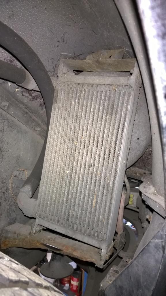

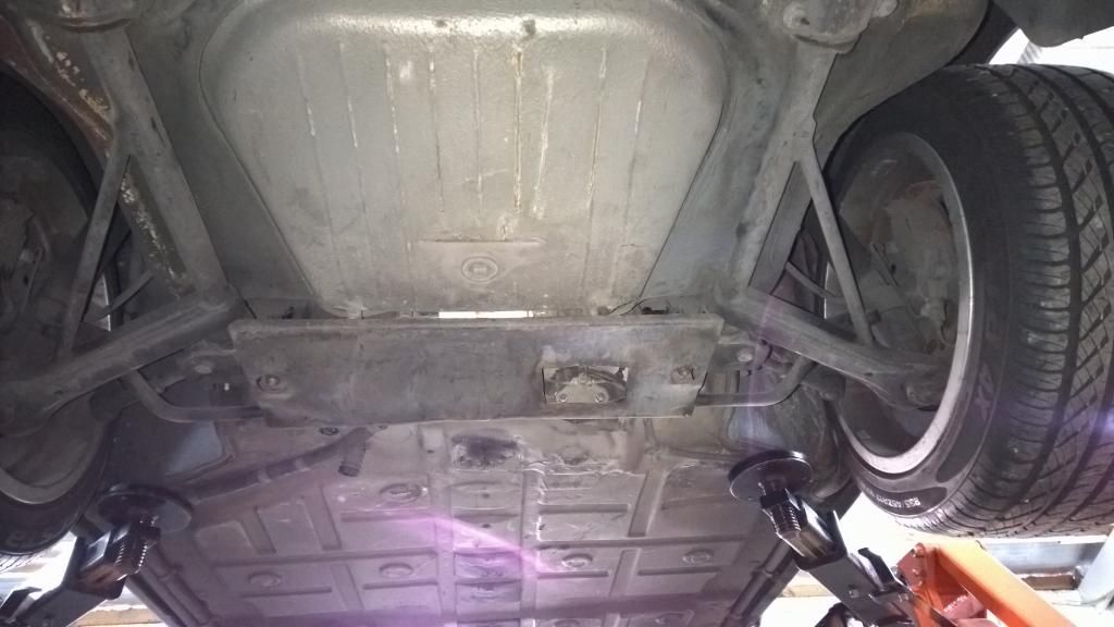

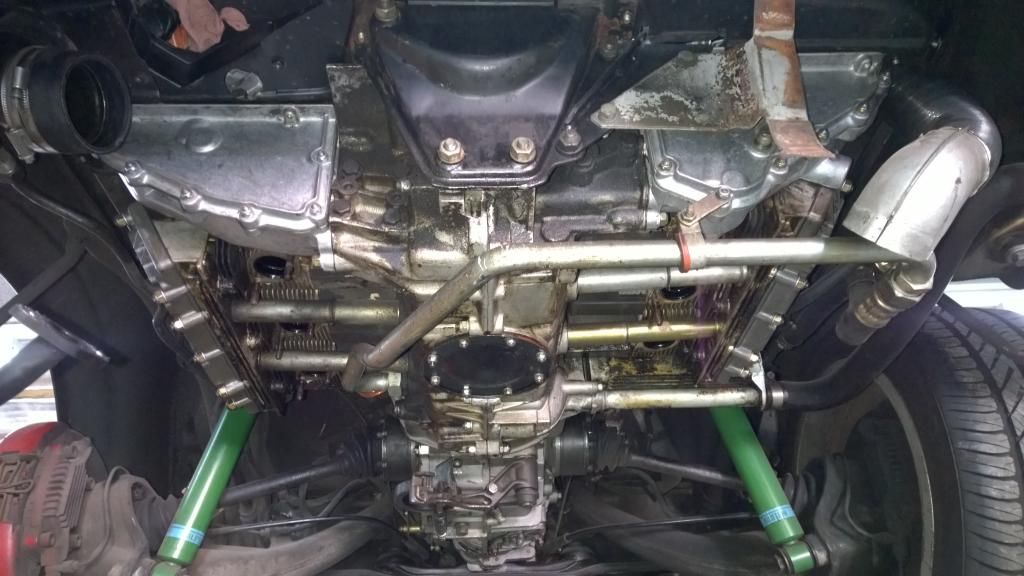

A few other new details today:
  • The turbo in place was indeed a 3LDZ
  • The 3LDZ was NOT leaking - it is fine
  • The passenger side cylinder heads ARE leaking

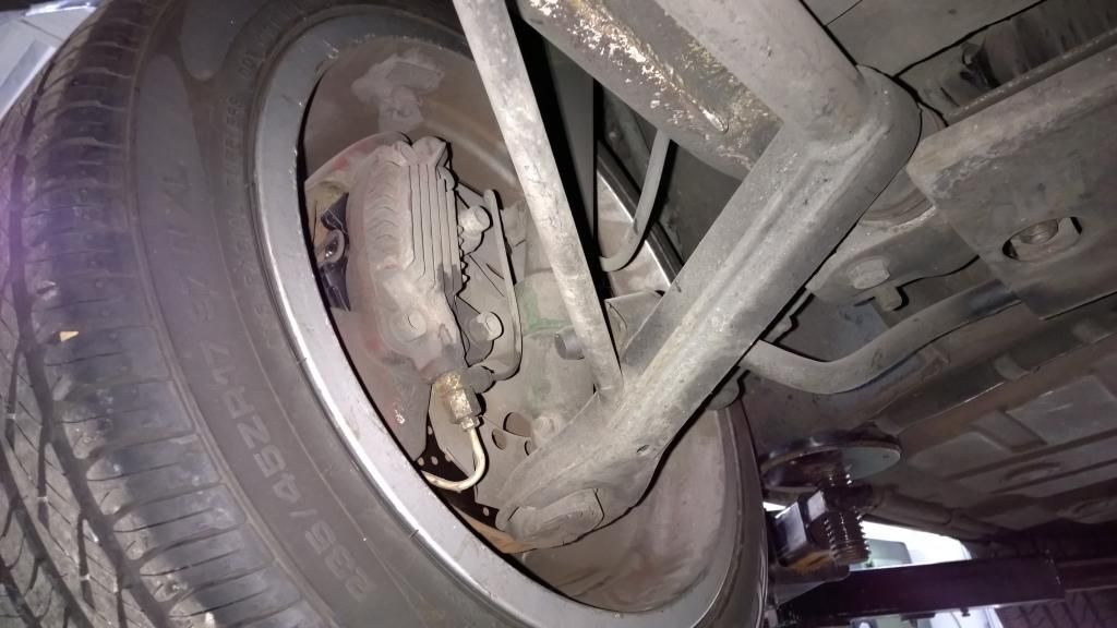

  • The red painted brake calipers were sadly painted in high quality caliper paint. Even nasty solvent wont touch them.
The Ruf wheels are growing on me. They might stick around for awhile until I have nothing better to do than buy tires for my Fuchs and do a comparison. No hurry there. My DC15 regrinds are in process with Dougherty...might as well. Sadly, no LSD
As far as the oil leak goes, we'll have to dig into the heads and see if the guides are shot or if it is the valve stem seals that are shot. The Teflon ones don't leak, so if they are the old rubber kind, no wonder. If not, more money to Ollie's.
If the heads need to come off, do I do it? Do I:
  • Port the heads...and what spec?
  • Twin plug is a given...I have two Electromotive setups waiting to be used.
  • DC15s already inbound
  • Compression bump to 8.x using JE FSRs?
And that's before we get to the transmission, which is hopefully fine for the time being. Would hate to have to rebuild it right now and go to the added expense of finding an LSD to install with my newly acquired 8:41 R&P.
A few more pics:

very cool
That color looks suspiciously like Justin's... which he'd believed is possibly called Ruby Red and was either one of a kind or one of very few. You tell me:
shame someone shot it black (people suck - what a dumb thing to do) - would be cool to restore it to original someday
