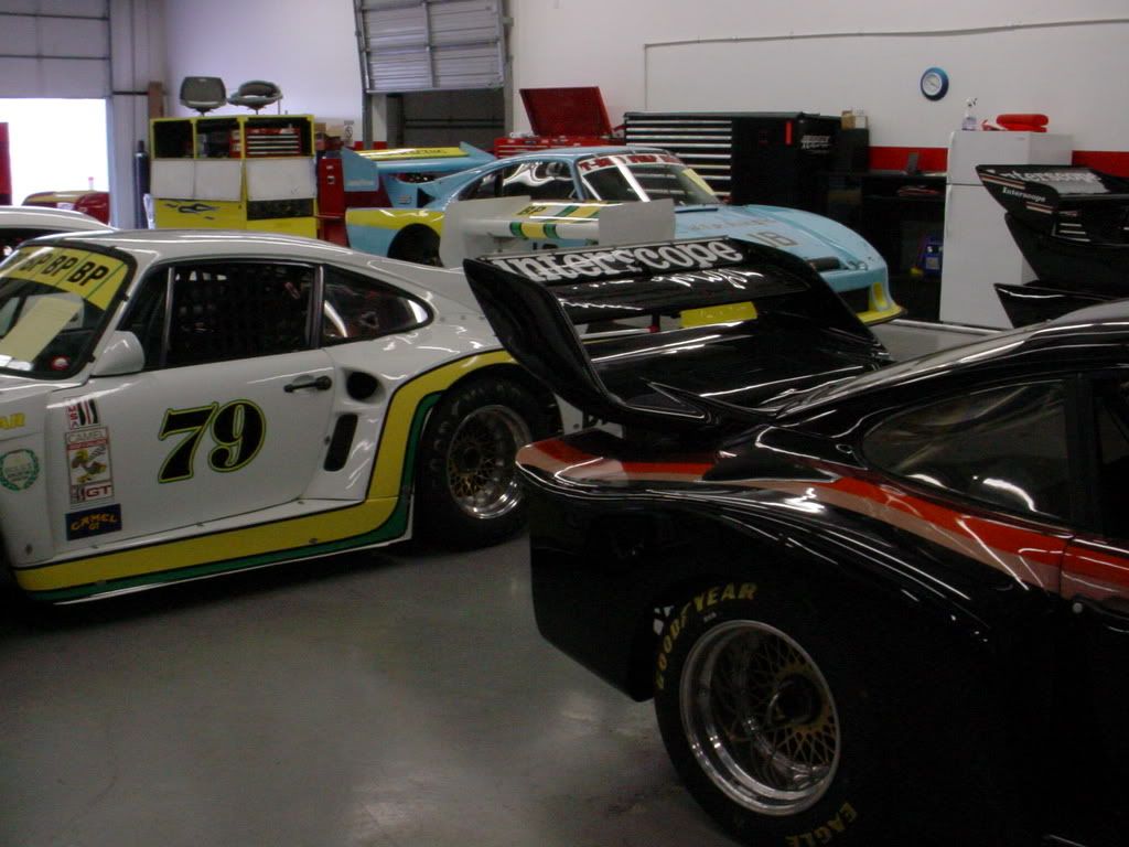

VZ935 02-19-2015 11:59 PM
Here is what that 935 looked like when we pulled it out of moth balls and took it to Daytona
http://img.photobucket.com/albums/v6...5/scan0001.jpg
Then we popped fresh bodywork out of our K3 molds and this is how it looked when you sat in it
http://img.photobucket.com/albums/v6...e/DSC00050.jpg
Really a solid great driving 935 but this is the money shot.. unloading at Daytona
http://img.photobucket.com/albums/v6.../intruckwt.jpg
Have fun with your 930 and thanks for saying hello to Bernie for me. He is a heck of a nice guy
