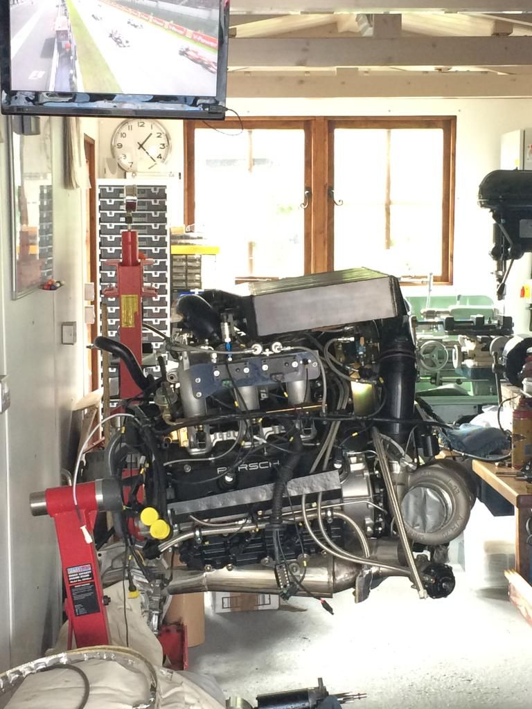

Old 08-27-2014, 10:21 PM
Kartoffelkopf
Spenny_b's Avatar
Join Date: Dec 2010
Location: Hell Fire Corner, near Reg Seat of Gvmnt 12
Posts: 1,661
964 Turbo 3.3 --->
Rebuilt to 3.4 using:
Omega 98mm pistons running 7.93:1
LN Cylinders
Stock Crank & Rods
Ported heads
12 Plugged with Denso Coil-on-Plugs, 4x Bosch amplifiers
Schrick valve train incl Ti retainers
964 N/A cams
Carrera intake
Siemens injectors
997 Carrera fly-by-wire throttle
Haywood & Scott SS exhaust system (but heavily reworked for...)
Garrett GT35R twin-scroll turbo
2 x Tial Wastegates
Tial BOV
TurboKraft full width intercooler
Sachs 997 GT2RS clutch assy
964RS SMFW
MBE Management running traction control, launch control, variable boost (may go for boost vs gear control)
Si-Leck management loom, full Raychem etc etc
2 x 044 fuel pumps
...plus a few things I've probably forgotten.
I have an idea what I'd like to see at the wheels....but who knows.....(apart from Chris!)
1993 (MY92) 964 Turbo 3.3 - Horizon Blue - Follow my 964 Turbo project here... http://forums.pelicanparts.com/911-engine-rebuilding-forum/626572-964-3-3-turbo-efi-conversion-using-syvecs-life-racing-engine-management.html
On Instagram (along with other stuff) as @spenny_.b #spennybengineproject
Old 08-28-2014, 04:19 PM
TurboKraft's Avatar
Join Date: Mar 2005
Location: Phoenix, AZ
Posts: 2,862
Originally Posted by Spenny_b View Post
964 Turbo 3.3 --->
Should surpass the blue Roadster Turbo, past 540whp on premium pump gas.
