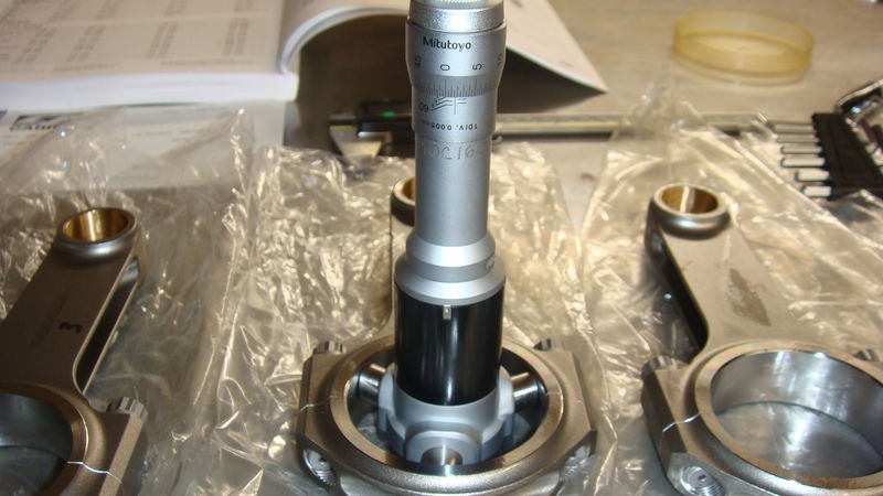

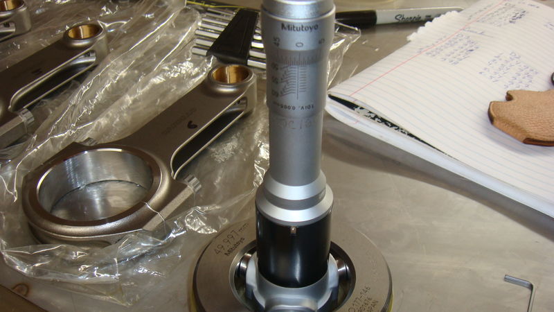

sorry the pic when zeroing the micrometer is a bit blurry...
Old 01-05-2021, 03:19 PM
@reimaginedcoachwerks
Join Date: Nov 2020
Posts: 116
we measure everything at the ideal temps to make sure it is as accurate as possible.
Old 01-05-2021, 03:20 PM
Join Date: Nov 2020
Posts: 116

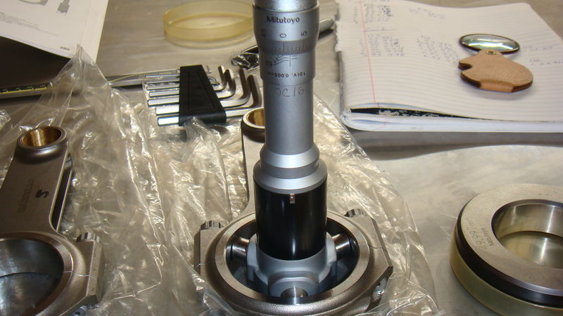

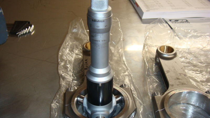

next up are the rods, the big ends first.
Old 01-05-2021, 03:24 PM
Join Date: Nov 2020
Posts: 116

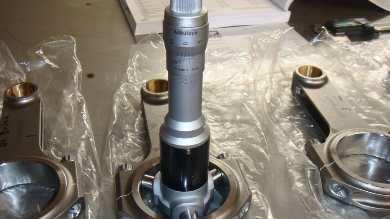

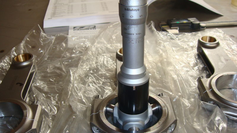

now the small end.
Old 01-05-2021, 03:27 PM
Join Date: Nov 2020
Posts: 116

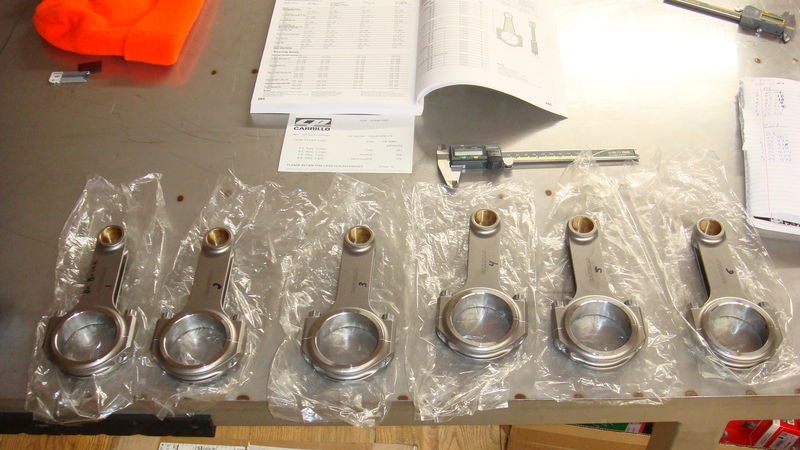

individual rod weights.

these are the weights straight out of the box from carrillo. i will massage them to close the gap but less than 1 gram difference is pretty awesome out of the box!

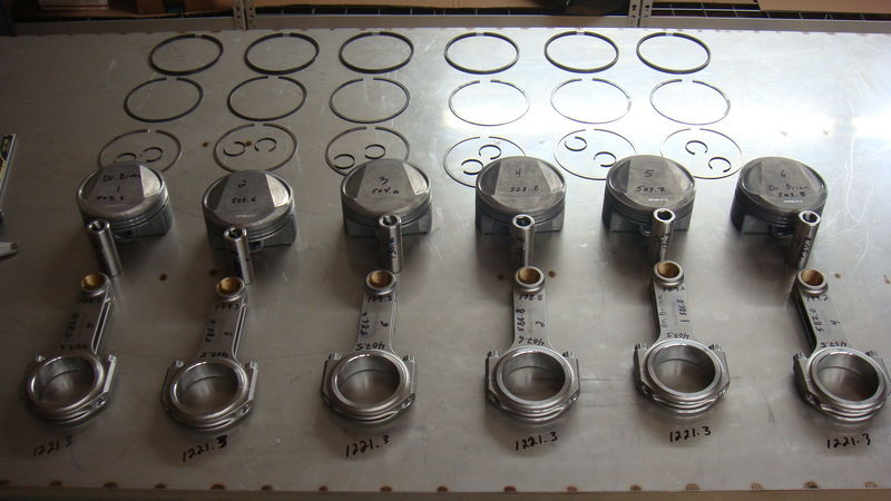

here are the piston weights. i also weigh all of the circlips and rings. they all weighed the same so not posting a pic of each one of those.

now that everything has been weighed we can start to balance each assembly by mixing and matching individual parts based on weight and then removed weight only from the parts that need it.

overall final rod weights. i call it done with 2-3 tenths of a gram difference as there is inevitably more or less oil on each part in the eng. imho zero zero is eyewash and like a peeky dyno sheet, it is something to brag about but not very practical in real life.
in the end you will see i get everything where it needs to be.

here is the final weight and orientation for each assembly.

i had the crank, FW, PP and front pulley all balanced separately down to 0.3 grams so this motor should run smoothly and rev freely!
