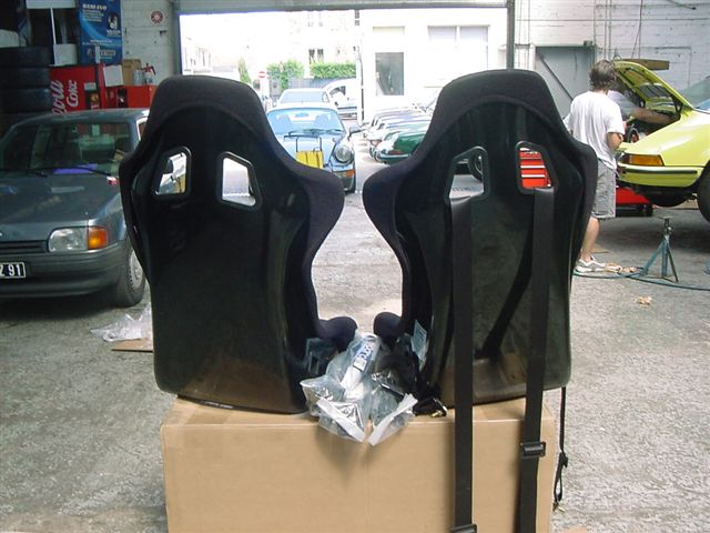

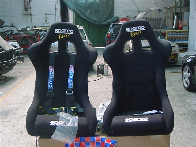

Ok not really engine, but parts are arriving...
8 days to wait....
http://forums.pelicanparts.com/uploa...o-MVC-001F.JPG
http://forums.pelicanparts.com/uploa...o-MVC-002F.JPG
http://forums.pelicanparts.com/uploa...o-MVC-007F.JPG
http://forums.pelicanparts.com/uploa...o-MVC-008F.JPG

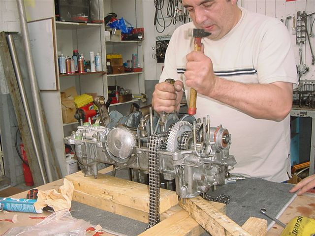

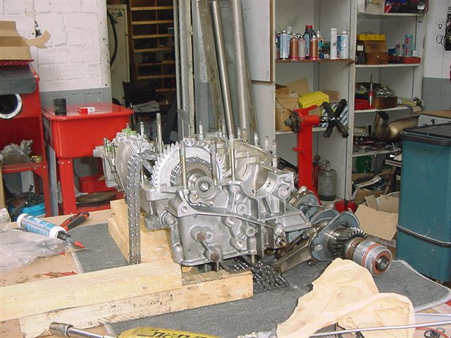

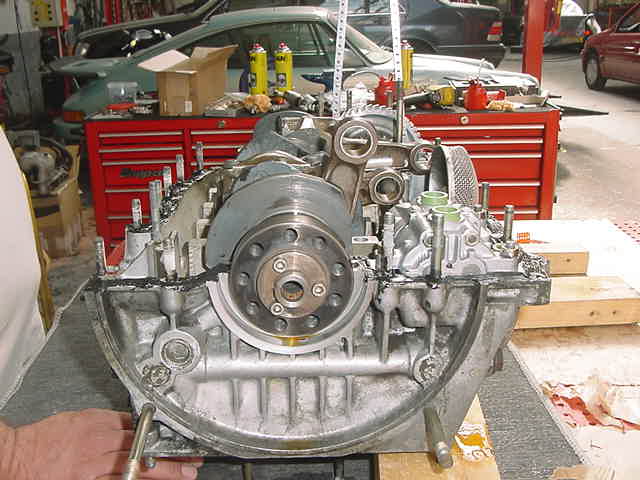

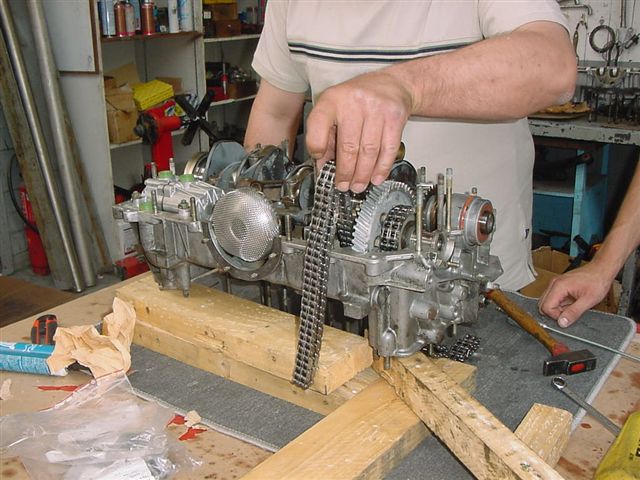

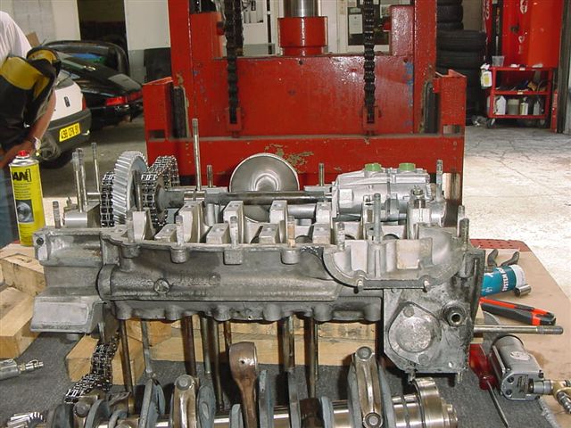

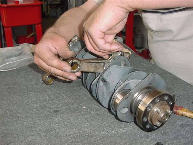

Rebuild Step 1,
http://forums.pelicanparts.com/uploa...1_MVC-001F.JPG
Forget to say fully balanced engine
http://forums.pelicanparts.com/uploa...1_MVC-002F.JPG
6 "rods" weight 702,1gr
http://forums.pelicanparts.com/uploa...1_MVC-003F.JPG

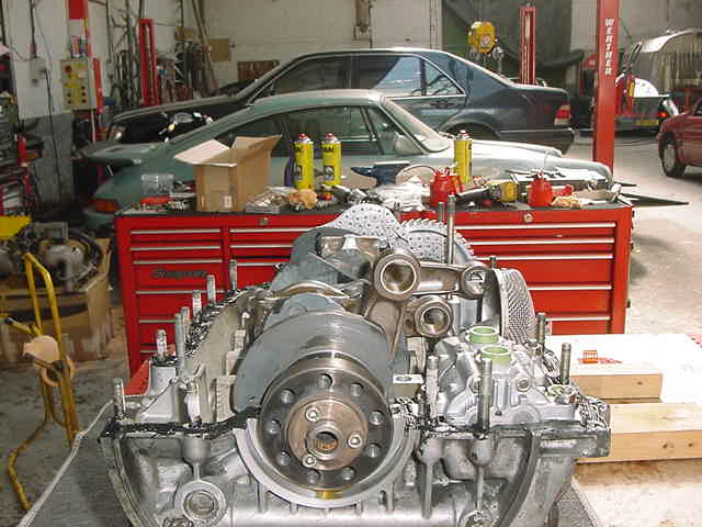

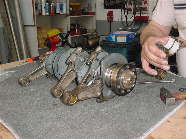

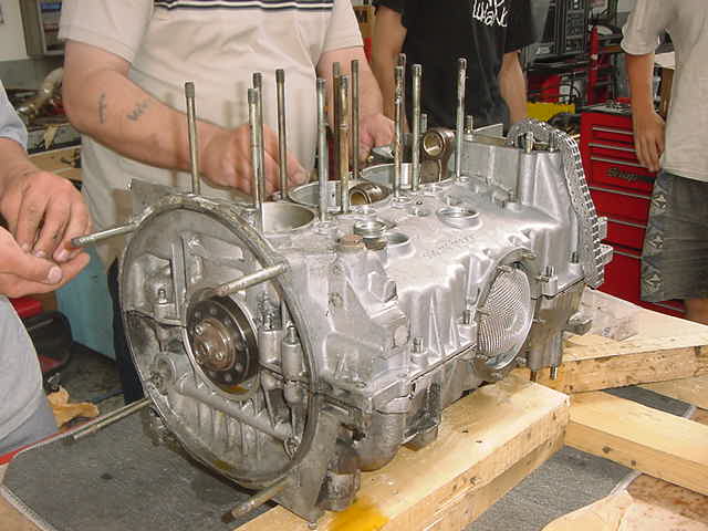

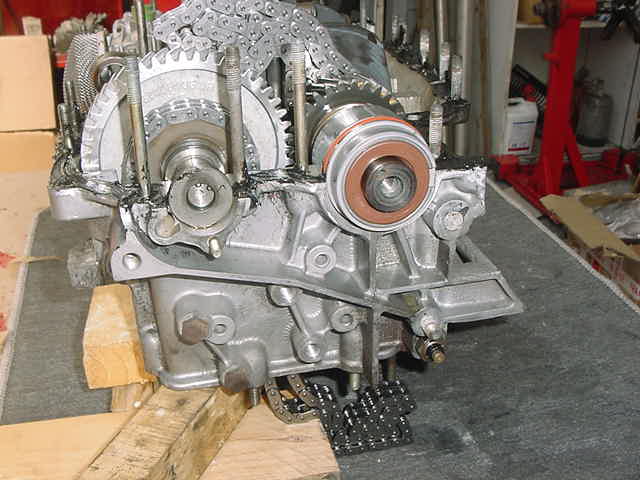

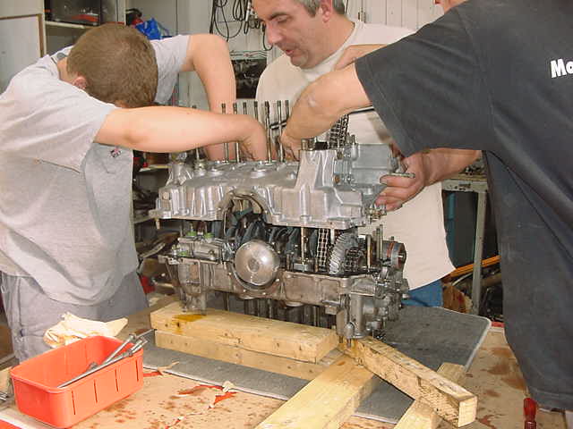

phe 06-24-2003 08:51 AM
http://forums.pelicanparts.com/uploa...1_MVC-004F.JPG
http://forums.pelicanparts.com/uploa...1_MVC-005F.JPG
http://forums.pelicanparts.com/uploa...1_MVC-006F.JPG
http://forums.pelicanparts.com/uploa...1_MVC-007F.JPG

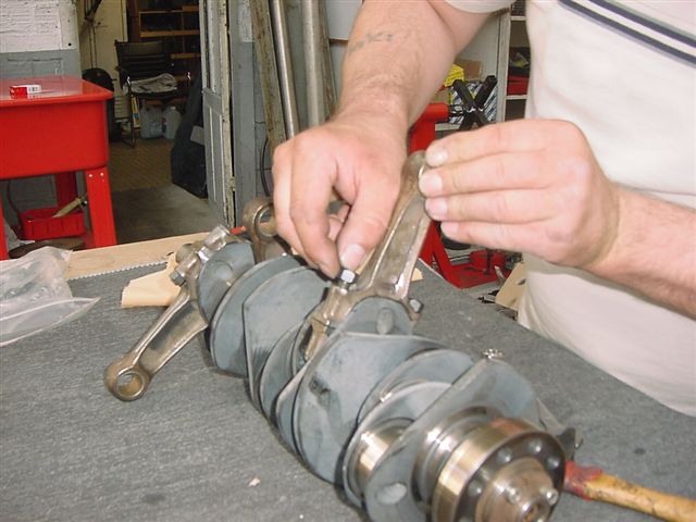

phe 06-24-2003 08:53 AM
http://forums.pelicanparts.com/uploa...1_MVC-008F.JPG
http://forums.pelicanparts.com/uploa...1_MVC-009F.JPG
http://forums.pelicanparts.com/uploa...1_MVC-010F.JPG
This is really killing me, I want to drive my car !!:eek: :eek: :eek:

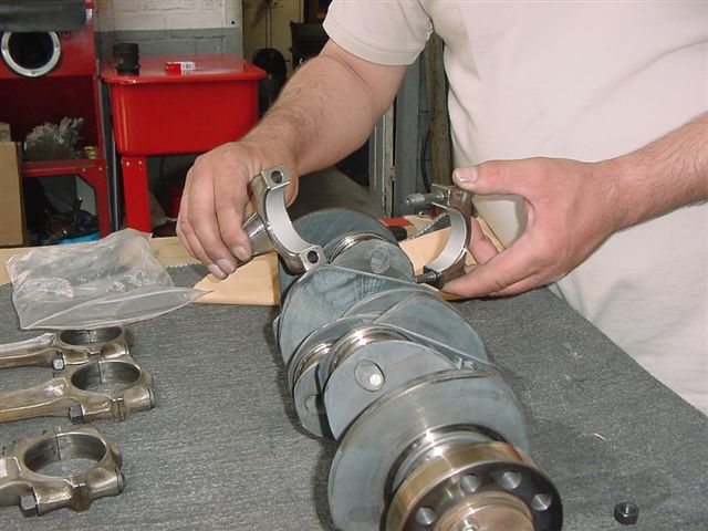

Still working Step 2
http://forums.pelicanparts.com/uploa...1_MVC-001S.JPG
http://forums.pelicanparts.com/uploa...1_MVC-002S.JPG
http://forums.pelicanparts.com/uploa...1_MVC-003S.JPG
http://forums.pelicanparts.com/uploa...1_MVC-004S.JPG
Just a word for wayne's book, really a valuable book in my situation :D :D :D
