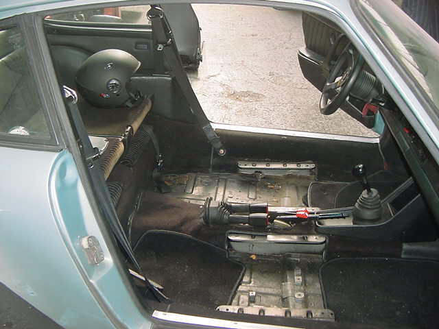

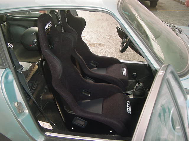

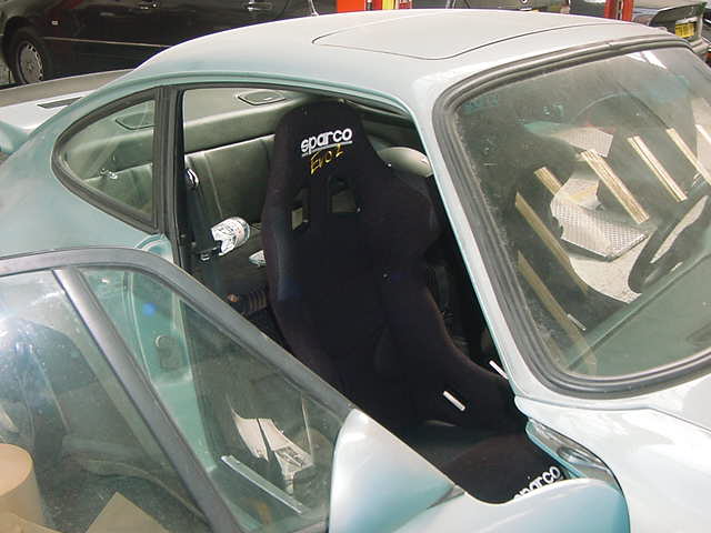

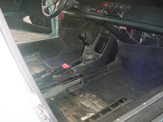

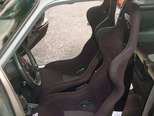

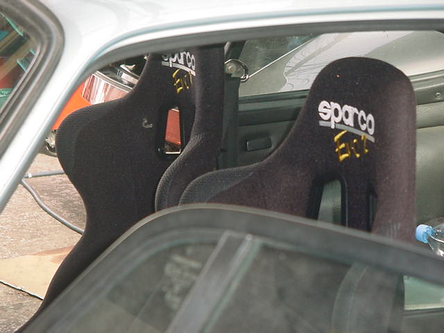

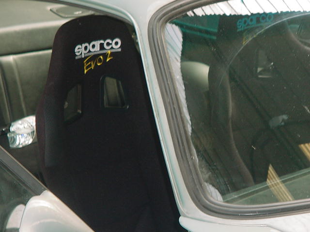

phe 06-26-2003 09:05 AM
some practicing for the seats:
http://forums.pelicanparts.com/uploa...3_MVC-001S.JPG
http://forums.pelicanparts.com/uploa...3_MVC-002S.JPG
http://forums.pelicanparts.com/uploa...3_MVC-003S.JPG
http://forums.pelicanparts.com/uploa...3_MVC-004S.JPG
http://forums.pelicanparts.com/uploa...3_MVC-005S.JPG
http://forums.pelicanparts.com/uploa...3_MVC-007S.JPG
http://forums.pelicanparts.com/uploa...3_MVC-008S.JPG
I will drop the rear seats and the plastic box around the gear stick.
Good no?
phe
ChrisBennet 06-26-2003 09:29 AM
While you have the seats out you should put in the eye bolts for your sub strap belts.
-Chris
phe 06-26-2003 09:34 AM
I do not have them yet, we have done a swith for larger belts.
I will receive that in a few days.
phe

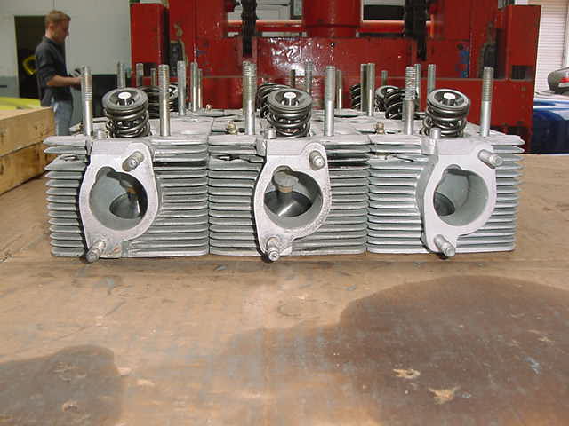

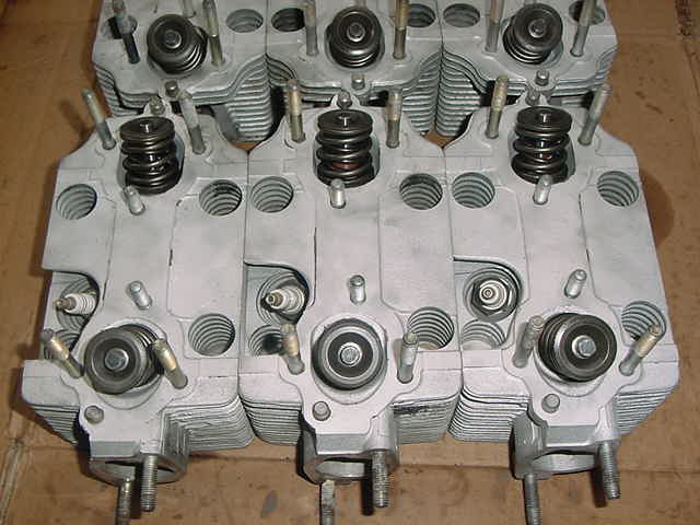

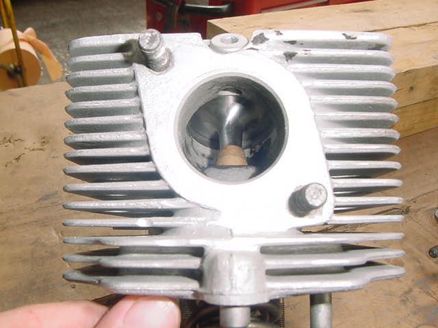

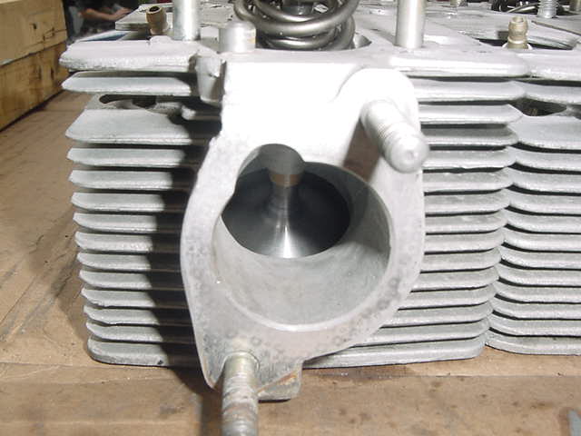

phe 06-30-2003 06:12 AM
Here comes the week-end pictures :
http://forums.pelicanparts.com/uploa..._1MVC-001S.JPG
http://forums.pelicanparts.com/uploa..._1MVC-002S.JPG
http://forums.pelicanparts.com/uploa..._1MVC-003S.JPG
http://forums.pelicanparts.com/uploa..._1MVC-004S.JPG
http://forums.pelicanparts.com/uploa..._1MVC-005S.JPG
phe

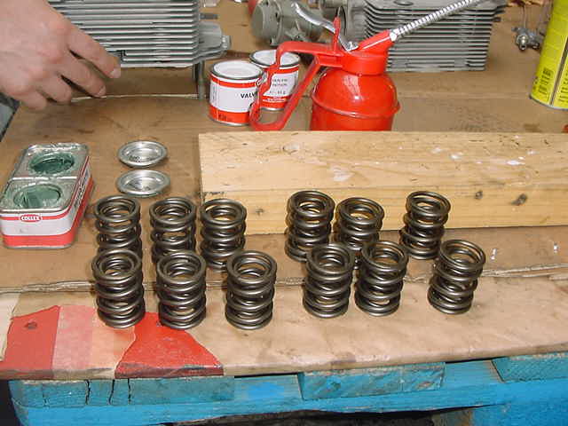

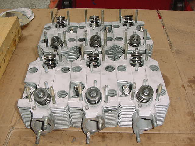

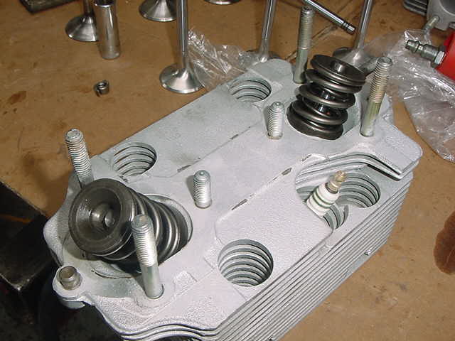

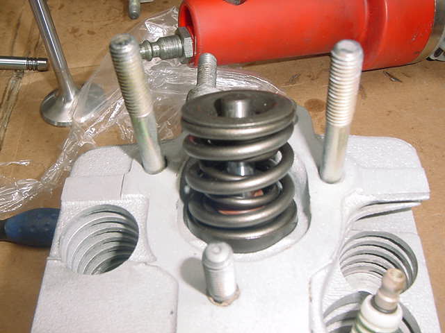

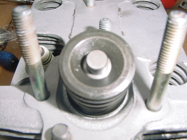

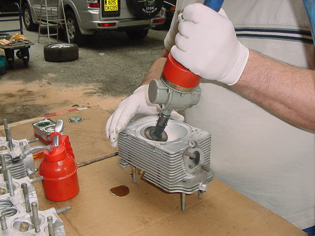

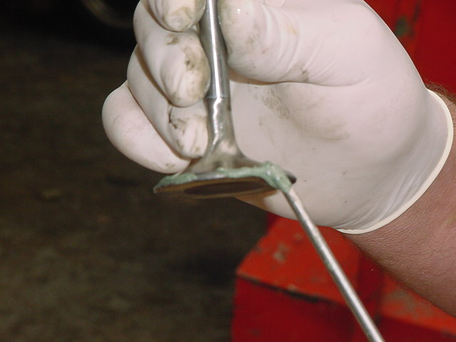

phe 06-30-2003 06:18 AM
how to do the block?
http://forums.pelicanparts.com/uploa..._2MVC-009S.JPG
http://forums.pelicanparts.com/uploa..._2MVC-010S.JPG
http://forums.pelicanparts.com/uploa..._2MVC-012S.JPG
http://forums.pelicanparts.com/uploa..._2MVC-013S.JPG
I didn't imagine that it was so difficult to put the springs in place. I am the lucky boy, the one with the camera !!
http://forums.pelicanparts.com/uploa..._2MVC-001S.JPG
http://forums.pelicanparts.com/uploa..._2MVC-002S.JPG
I have also a small dirty video of someone masturbating a valve but due to morale (and technical) reason I cannot post it. sorry :D :D
phe 06-30-2003 06:20 AM
Last serie for today :
http://forums.pelicanparts.com/uploa..._2MVC-014S.JPG
http://forums.pelicanparts.com/uploa..._2MVC-015S.JPG

Type961 06-30-2003 09:03 AM
Hi Phe,
Well this engine will be soon in the car !
I have few remarks :
Do you use original valves ? It would have been a good idea to machin them, reducing the angle radius : this helps tork at middle ranges. The ports should also have been cleaned.
Did you also check the springs' strength ?
One more important thing : don't forget to check the chamber volume and piston clearence for each cylinder !
I think it's non-sens to lose some time lighting and equilibrating rods if this basic work haven't been done.
Regards,
Luc
phe 06-30-2003 09:14 AM
Luc(snoopy),
valves: 50%new 50% old but checked (for machining too late).Must stay a road car (about 60.000km/year!)
springs: all new.
ports: agree, it looks dirty (I will drop a call)
clearance: schedulled.
phe
Type961 06-30-2003 09:44 AM
re Phe !
This is always my goal to keep an engine reliable.
Machining valve just helps flow at low valve lift and never affect reliablity.
>springs: all new.
Good. Bought all together ?
This is not important. Never polish the ports, it's lost time. But the moulding lines should be removed. It should have been done if the valves, seats and guides were done. So keep them like this, 3.4 engines work enough don't they :) ?
And let's consider you will have a good air/fuel mixture thanks to it ;)
ps. Snoopy is already used by another one on this forum :(
Luc.

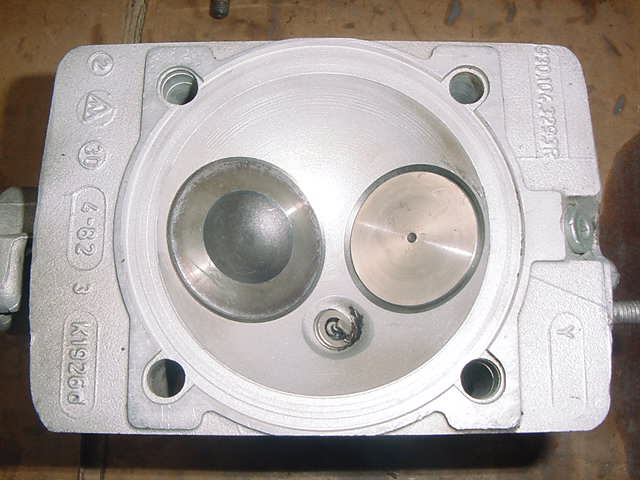

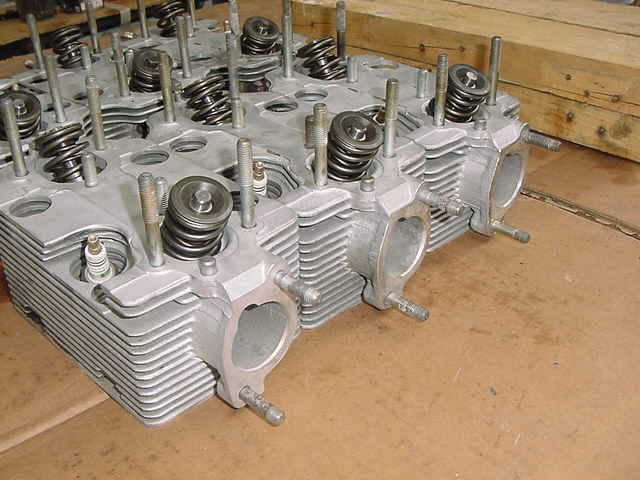

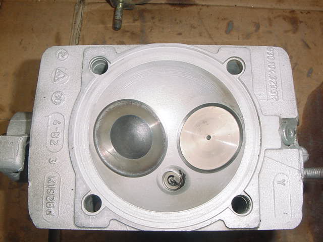

phe 06-30-2003 09:50 AM
Finished (I am getting closer.....)
http://forums.pelicanparts.com/uploa...5_MVC-003S.JPG
http://forums.pelicanparts.com/uploa...5_MVC-004S.JPG
http://forums.pelicanparts.com/uploa...5_MVC-006S.JPG
http://forums.pelicanparts.com/uploa...5_MVC-007S.JPG
http://forums.pelicanparts.com/uploa...5_MVC-008S.JPG
http://forums.pelicanparts.com/uploa...5_MVC-009S.JPG
http://forums.pelicanparts.com/uploa...5_MVC-010S.JPG
http://forums.pelicanparts.com/uploa...5_MVC-011S.JPG
Good work for the day !!!
I know you dont like to do that so (Merci pour l'effort)
phe
Type961 06-30-2003 10:14 AM
Now you *just* have to check for the volume of each combustion chamber. Also don't forget to compare piston heights.
A good trick : if you need to remove material to set the biggest volume you measure to all chambers, remove it around the spark plug.
This helps combustion and reduce detonation risk.
Have fun ;)
Luc.
