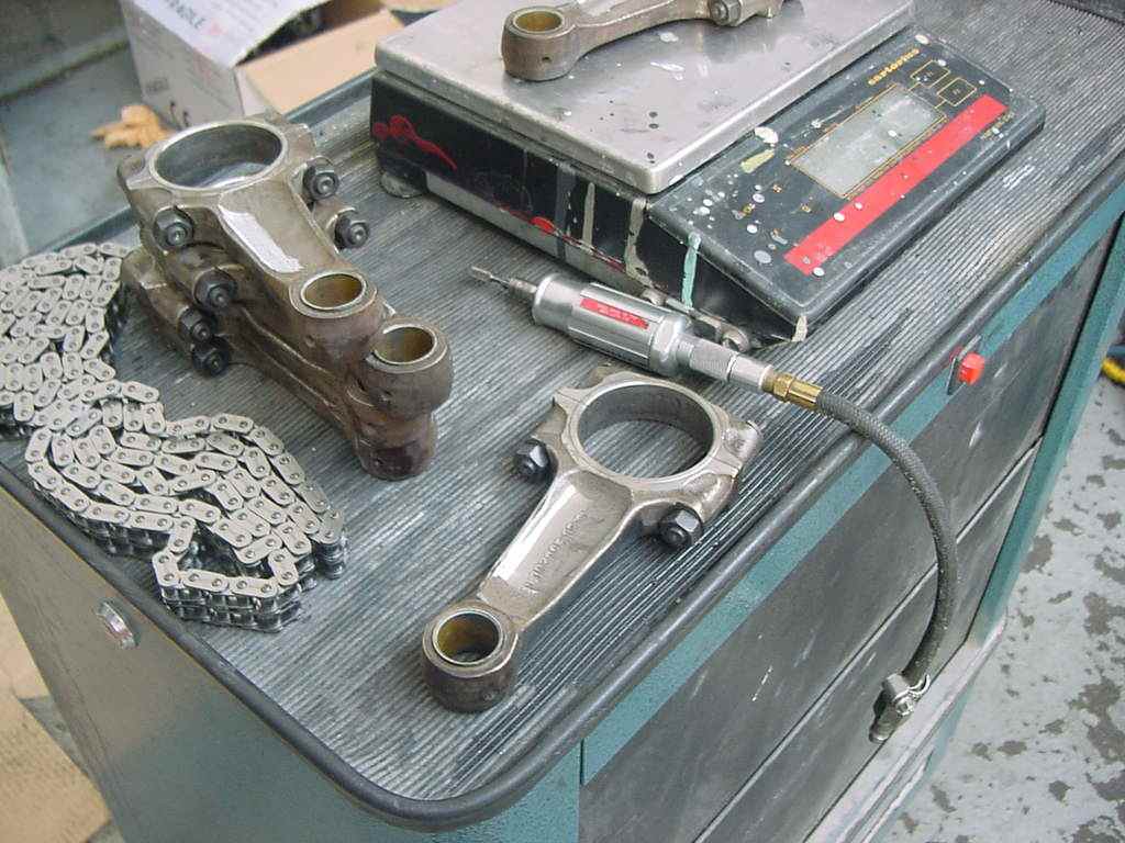

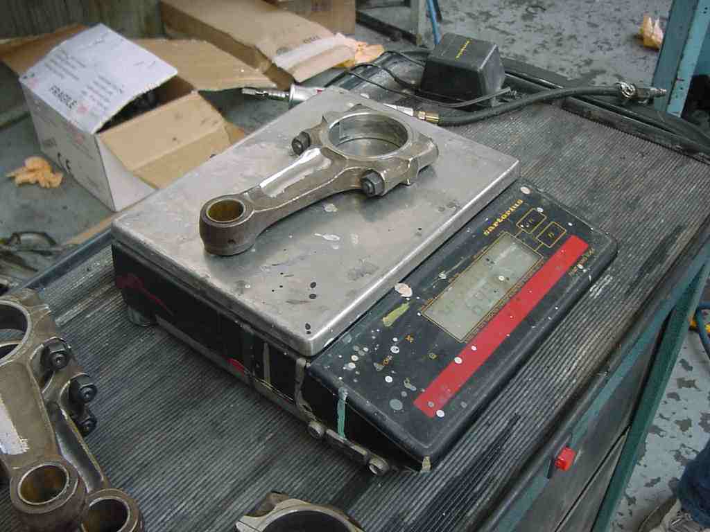

phe 06-25-2003 05:25 AM
Forgotten pics.
The job is done serious, no ?
http://forums.pelicanparts.com/uploads/MVC-aaz007S3.JPG
http://forums.pelicanparts.com/uploads/MVC-aaz007S2.JPG
phe
ChrisBennet 06-25-2003 06:33 AM
phe,
Has you mechanic done many 911 motors? I don't want to alarm you unnecessarily, but the lack of a 911 engine stand, mystery black sealant, and a rather dirty work area is setting off warning bells in my head...

phe 06-25-2003 08:07 AM
Do not worry, the engine stand is coming now.
I fully trust the mecanics, I have seen engines rebuild by him, they are running strong and the reliability is really good for track and street. I am not going there as a blind man.
If you had the possibility to use aerospatial sealent, you would, guess I correctly? I just cannot say where it comes from because this is not official.

phe 06-25-2003 09:05 AM
Day 2 is on the way :
The now famous sealent !
http://forums.pelicanparts.com/uploa...2_MVC-001S.JPG
http://forums.pelicanparts.com/uploa...2_MVC-002S.JPG
http://forums.pelicanparts.com/uploa...2_MVC-003S.JPG
The work look clean
http://forums.pelicanparts.com/uploa...2_MVC-004S.JPG
http://forums.pelicanparts.com/uploa...2_MVC-005S.JPG
Nice cylindres
http://forums.pelicanparts.com/uploa...2_MVC-006S.JPG
http://forums.pelicanparts.com/uploa...2_MVC-007S.JPG
Now the pistons, I really like this picture.
http://forums.pelicanparts.com/uploa...2_MVC-008S.JPG
phe
