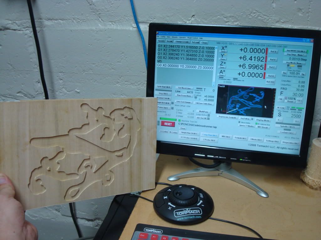

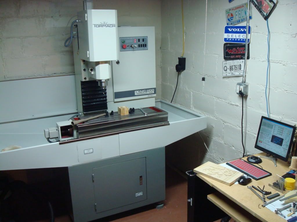

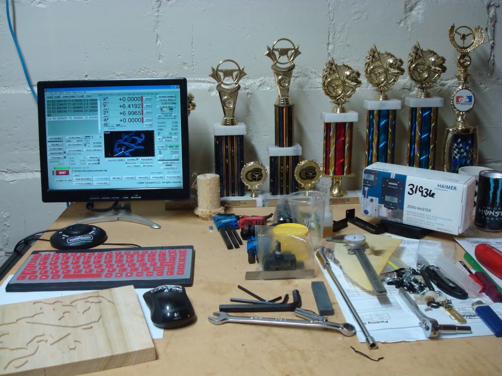

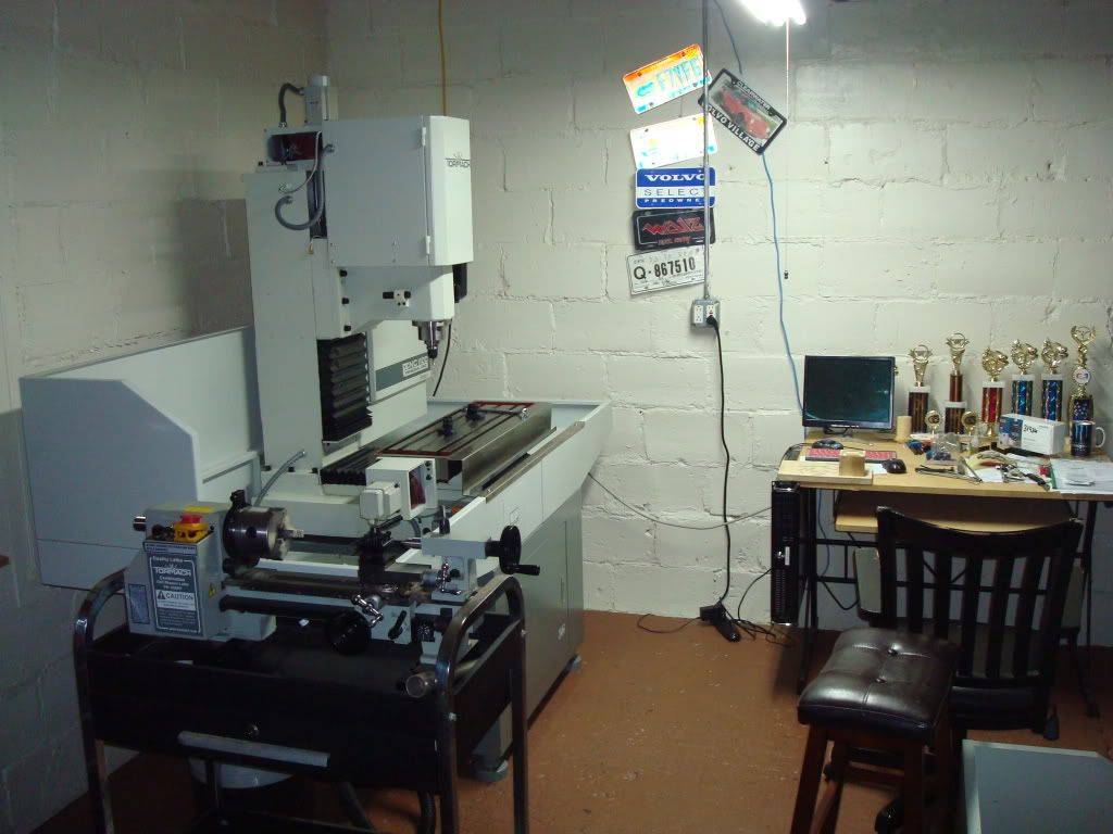

350HP930 06-16-2011 09:11 PM
Hey Rick, I've finally completed spending the investment you made into my former baby.
Garage is a hell of a lot cleaner since the last time you were around as well.
The 930's racing tropies make a nice backdrop for my controller desk too, lol.
http://i1138.photobucket.com/albums/...0/Setup079.jpg
http://i1138.photobucket.com/albums/...0/Setup075.jpg
http://i1138.photobucket.com/albums/...0/Setup073.jpg
http://i1138.photobucket.com/albums/...0/Setup074.jpg
CaptainCalf 06-17-2011 01:06 AM
Sweet looking mill and that can't be the same garage;)

350HP930 06-17-2011 07:05 AM
Rick, I can no longer remember who manufactured them, hopefully they might have some markings on them somewhere to identify the manufacturer. I bought them online from a guy who caught the twin turbo bug after he had already purchased this set.
And as far as my own manufacturing project goes, I'm working on designing and manufacturing some small turbines and stirling engines for the purposes of waste heat recovery and power generation. Between burning waste cooking oil and building a solar concentrator I hope to eliminate my power bill in the next year or so and possibly even get a check instead of a bill as I turn up the capacity. If my personal use prototypes work well I'm hoping to move on to creating a production unit in the several killowatt range so that a business like a large restaraunt or any facility with a small furnace could recover a portion of their waste heat energy stream.
