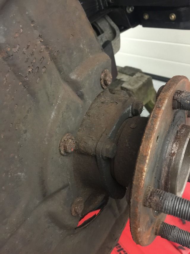

The rear nuts on the end of the driveshafts are the same as the old ones I've just removed, but upon speaking to the guys at my OPC, they confirmed that none of the superceded part numbers for the front nuts have ever included the p/n of the rear nuts; they've never been the same item.
So, it looks like somebody in the cars previous life has grabbed a pair of nuts off of the rear of another car and fitted them to the front of "my" car. Also, the threads were coated with copperslip. The Porsche workshop manual calls for the use of Optimoly HT which is aluminium in colour and to my knowledge, Porsche have never used copperslip on the 964. Bit of a giveaway that it's been apart before (thanks for the info on the Optimoly HT, John; a long historic reply of yours that I Googled earlier!). If you notice in the previous side-by-side pic, there are witness marks on the left of each face on the hex...which look suspiciously like impact/hammer gun markings.
So, mind was at rest to go ahead and fit the nuts I had; the p/n was again confirmed by the OPC that it is the latest revision.

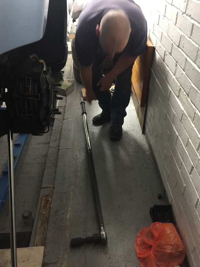

My mate Ian very kindly borrowed the biggest torque wrench I've eve seen from his work - a Dunlop item and regularly calibrated.
http://img.photobucket.com/albums/v2...792A9A4AAF.jpg
http://img.photobucket.com/albums/v2...BBF6DDF251.jpg
Threads lightly coated, along with the flanged faces of the nut, and it was a doddle to re-torque everything....me on the end of the 3ft breaker, him on the wrench.
Nothing remarkable about a picture of a nut, only that it may help somebody in the future with a similar question as I had...

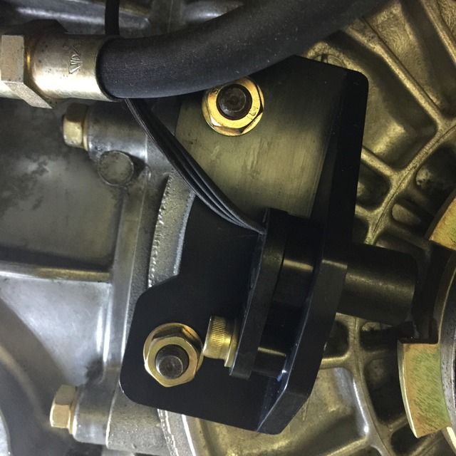

I now have the hall effect (HE) sensors back from Simon, who's done a great job of re-terminating them with the correct Sureseal plugs to interface with the ECU loom. Proper job, double sleeved with Raychem DT25 for robustness and resin bonded ends to seal everything.
http://img.photobucket.com/albums/v2...83D429C1F2.jpg

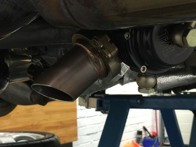

Finally this evening, I finished the wastegate screamer pipes, cutting them down to the length I want. Long enough to ensure that the hot gases/flames don't damage anything, but short enough to maintain ground clearance....
http://img.photobucket.com/albums/v2...52779CE947.jpg
http://img.photobucket.com/albums/v2...D4CB5A6302.jpg

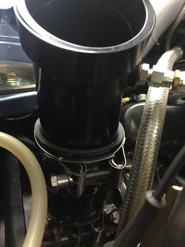

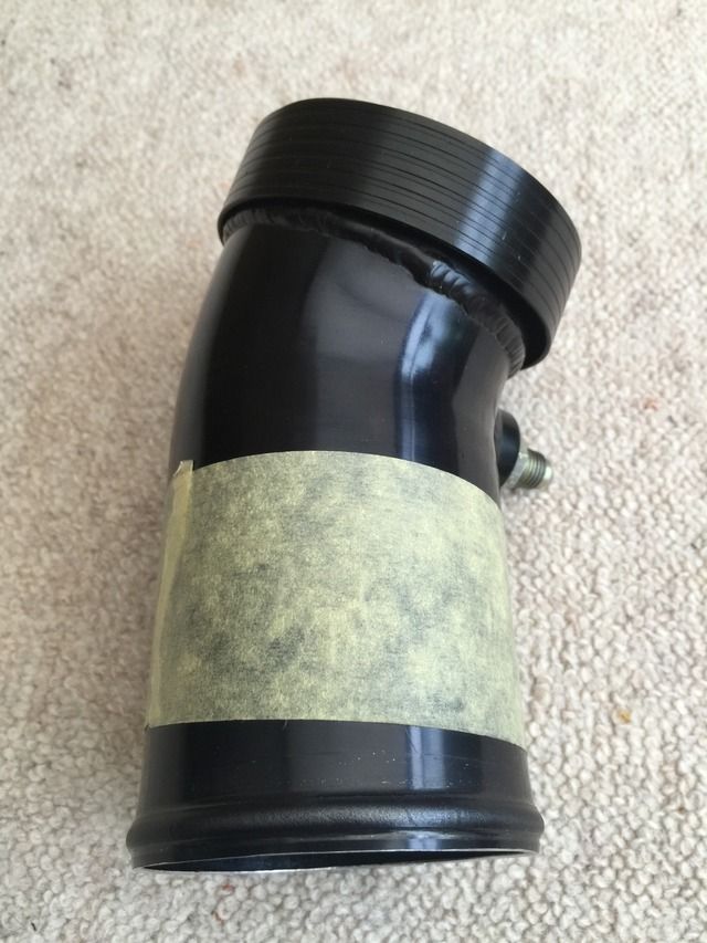

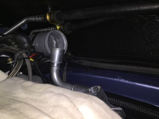

The hot-side silicon hose arrived during the week, a step-down (or step-up...) straight coupling from 63mm > 76mm and 125mm long.
Next job was to cut the pipe down a little, from this...
http://img.photobucket.com/albums/v2...63ABF4AFE4.jpg
To this, with the raw end swaged. Tape is just marking the top of the new hose with it set at it's max lowest position on the compressor outlet....
http://img.photobucket.com/albums/v2...E5B95F1B34.jpg
And then time to get it into place, set the height correctly, and it's another job finished. The Mikalor clamps are a lot easier to get to now (most of the issue was the reworking of the rear tinware, which severely limited the orientation and access of the clamps), so mission accomplished with nice tight clamping at both ends.
http://img.photobucket.com/albums/v2...78E2223C43.jpg

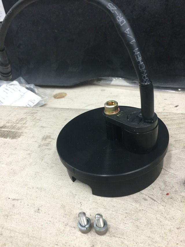

Onto the traction control tasks, the caps and sensor stand-offs were plated during the week - another quick drive down the road to collect them....another great job by Butterworths (Regia) Ltd....
http://img.photobucket.com/albums/v2...97EF92E560.jpg

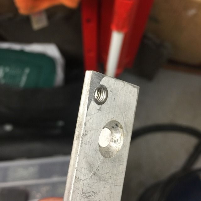

First job was to install some timeserts into the M5 retaining holes. As stock, they're too long for the wall thickness of the caps, and would foul the ABS timing wheel immediately behind the cap. So, a piece of scrap ally of the same thickness, drill & tap the timesert hole and insert the timesert into it....remove the majority of the excess with side cutters, then grind them flat on the offhand grinder.
http://img.photobucket.com/albums/v2...BC5F088DB3.jpg
http://img.photobucket.com/albums/v2...20326899EA.jpg
Then it's just a case of carefully removing them (at this point they're only 3mm thick, so a little fragile) and wind them into the caps, removing the tang afterwards....
http://img.photobucket.com/albums/v2...250FE31195.jpg

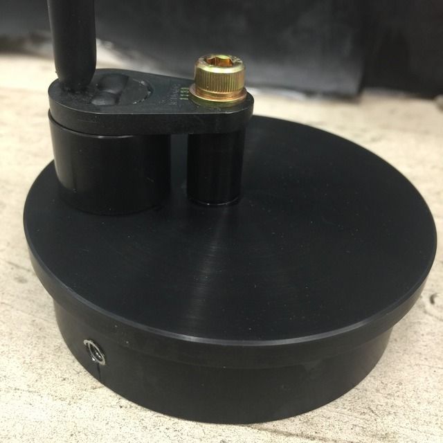

Time to then build them up with the standoffs and HE sensors, along with cutting down a pair of stainless M5 capheads, so that they also don't protrude into the ABS wheel....
http://img.photobucket.com/albums/v2...F20BF3C63A.jpg
http://img.photobucket.com/albums/v2...16C71E28B8.jpg
Installed into the hub....
http://img.photobucket.com/albums/v2...5BBF773EFF.jpg

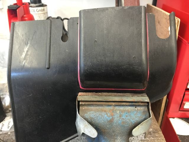

I spent a few hours yesterday messing around with the OE engine fusebox cover. With the new intake pipework, The fuses that were once mounted on the outside of the ally mounting plate have now had to be relocated to the inside, which wasn't too difficult, as there are quite a few items that have been removed, not needed when removing the CIS system. However, the plastic cover has a bulge to cover these external fuses, and needs to be removed. A few months ago I tried to make a new cover from sheet ally, but it looked a bit rubbish and was ill fitting. So, I thought I'd rework the plastic one, it's only a $12 item so no harm done if it all goes wrong.
I started by cutting out most of that bulge...
http://img.photobucket.com/albums/v2...F03014F7F0.jpg
Then had to enlarge it a little, before spending a lot of time making an aluminium panel that will fit behind the plastic. Lots of compound curves, so was quite tricky to make it accurately. The plan is/was to then get it powdercoated in satin black to try and match the plastis, but the lack of photos tells you that I'm not convinced this second attempt is going to look any good either. What I may do, is to install the ally fill-in panel, then use this as a template to take a mould from, then make a new unit, either fibreglass or carbon fibre (Rob, stand-by, I may be giving you a shout for some advice! I've never done any CF work, and very little FG, but you've got the knack mate!)

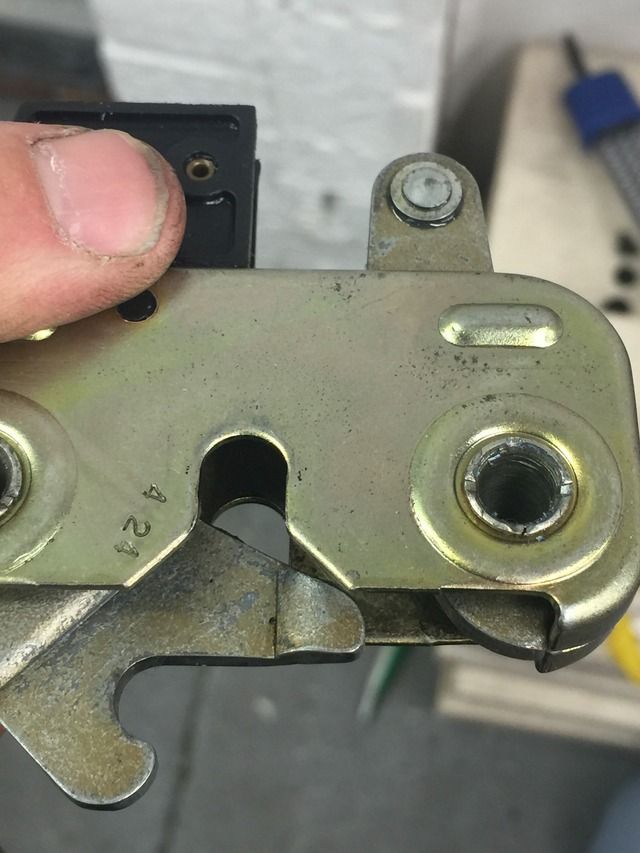

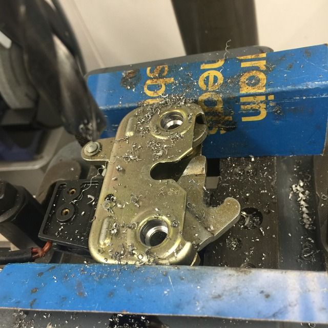

Last job this evening was to address the rear engine lid latch. Really annoyingly, after taking the trouble to source a very nice looking latch from the US and waiting for it to be shipped over, I noticed the other day that the engine bay lamp should be on, but wasn't. Some quick diagnostics showed that one of the wires from the microswitch has fractured...
http://img.photobucket.com/albums/v2...25E6BD0E89.jpg
Terrific. This part cannot be removed without stripping the whole bloody unit, which is swaged shut with 2 tubes that double as the mounting holes. If I was going to go to this much trouble, I wouldn't have bought a new unit, I would've stripped the one I had and got it re-plated (which was all that was wrong with it, it was just looking tired). Now I've got to retrieve the old unit, strip that one as well and swap over the microswitches....the wire sheared right up against the switch housing, so no way to repair without butchering the plastic.
http://img.photobucket.com/albums/v2...B8579A7460.jpg
http://img.photobucket.com/albums/v2...58D3A13412.jpg
http://img.photobucket.com/albums/v2...FF95C04735.jpg

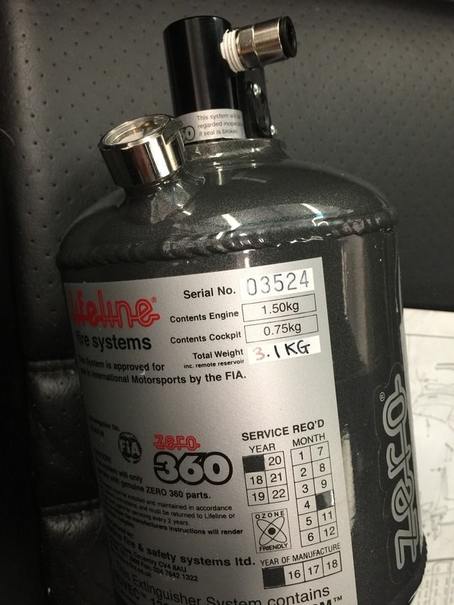

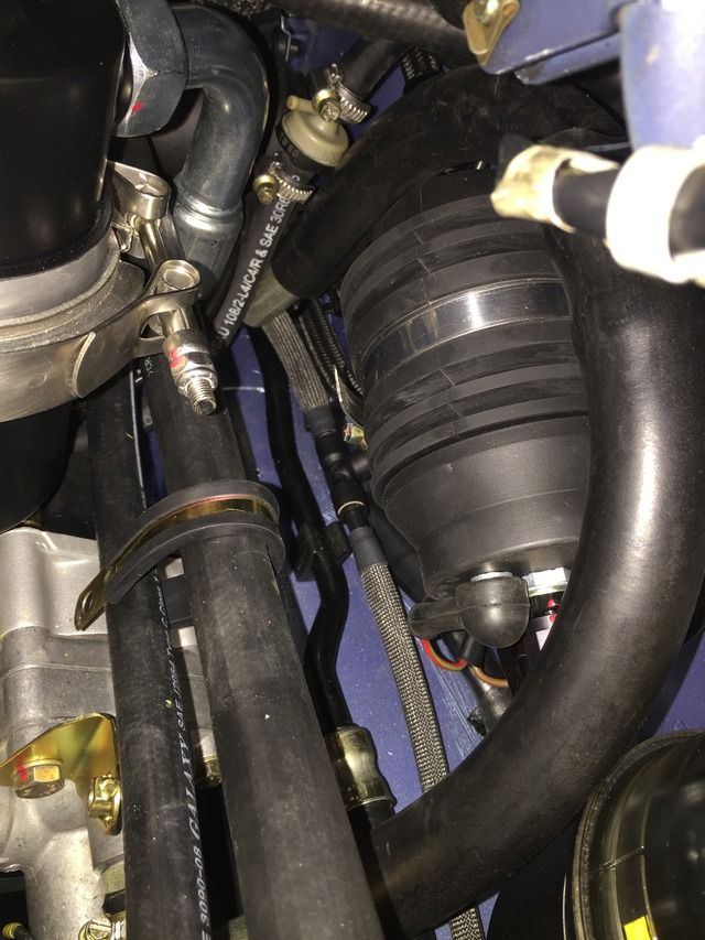

Fire Extinguisher Installation...
...at last...

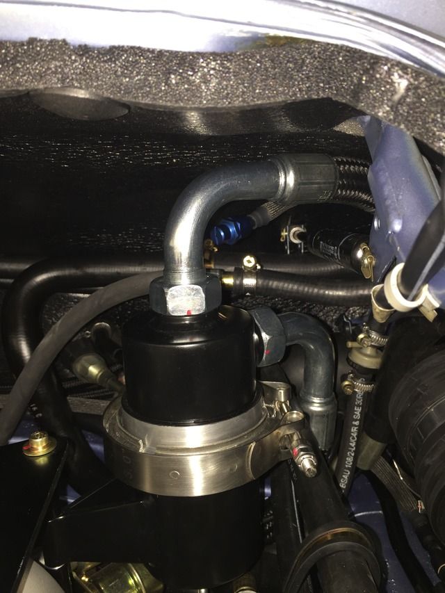

Decided to just get stuck-in this evening, frustrating though it is to undo all the intake system in order to get to the back of the engine bay. I now REALLY wish I'd installed the pipework before putting the engine back in.
First job, decide how to run the hoses, where the T-pieces are going to be and then the nozzle placement....
http://img.photobucket.com/albums/v2...450A57BE4A.jpg

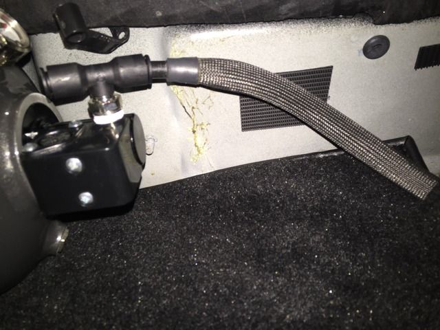

Then, run a mainline from the tank, along the tunnel and through the grommet behind the handbrake.
(none of the hoses are fixed in place yet, nor are the nozzles orientated correctly)
http://img.photobucket.com/albums/v2...50DB5FB851.jpg
http://img.photobucket.com/albums/v2...95C5BE5FF7.jpg
The tank has a dual outlet fitting, intended that one side remains in the cabin feeding 2x nozzles, then the remaining 4 go off to an engine bay. I'm not doing this, instead, the dual outlet will be replaced with a single outlet when it goes for filling, but this does now mean I'm a T-piece short, I need a 5th.
http://img.photobucket.com/albums/v2...67746A0E89.jpg
http://img.photobucket.com/albums/v2...5E826DAAE8.jpg
The mainline will then branch off using 2x T's; the main branch continuing into the top half of the engine bay. The lower branch to the lower half of the engine. Both the top and bottom will further split to feed left and right sides, then further split to supply left rear/left front + right rear/right front.
The lower nozzles will be L&R and aiming at the turbo and wastegate areas.

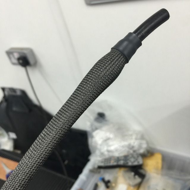

Each length of 8mm ally tubing has to have a heat resistant sleeve applied, and I decided to terminate each sleeve with glue-lined heatshrink...
http://img.photobucket.com/albums/v2...D1FDD1DDC8.jpg
So, this evening I got the mainline in, the continuation run to the top half of the engine, the intake system dismantled and the right hand feed in place, plus both nozzles installed. In other words, about a third of the way there! (albeit, the hardest third to get to)
http://img.photobucket.com/albums/v2...C46DC399EC.jpg
http://img.photobucket.com/albums/v2...EE3A24DE2E.jpg
http://img.photobucket.com/albums/v2...3D72CFBBE9.jpg
http://img.photobucket.com/albums/v2...D806E2C8C1.jpg
Work will continue tomorrow evening....
Spenny_b 10-04-2015 04:15 PM
Evening folks,
Some steady progress for the last few weeks, not much happening during the week, but some solid work being done this weekend.
The nemesis job - the fire extinguisher - is almost done. With so much "stuff" packing the engine bay, it's a chicken-and-egg situation with installing before or after the engine/gearbox goes back in...very easy to look back and regret not putting it in first, but it could have gone wrong with the positioning of the nozzles or the routing of the hoses potentially fouling something....so, I guess I have done it the correct way around...but BLOODY HELL it's a pain in the arse to fit retrospectively. I've lost count how many times I've smashed my head on the gearbox/heat pipes/dampers/brake discs, perfect ingredients for monumental sense-of-humour-failures. Anyway, it's almost done now, so I do feel as though I can start to think we're on the home straight.
I ended up dismantling the whole intake system (well, not the manifold), so that I could route the pipes perfectly, forming them around the chassis and ensuring that they're held in place nicely with either p-clips or the nylon straps that Porsche use onto the chassis studs. Very happy with how this now looks, discrete and OEM like...would look even better if the nozzles were black instead of blue! ;)
All 6 nozzles and their lines are now in, as-is the main run from the bottle. Not a lot to show over-and-above the photo's posted previously.

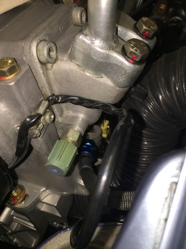

  • Re-coupling the AC lines from the engine bay to the chassis, inside the LH wheel arch

The bottle is away being filled with gas, hopefully will get that back midweek'ish. Next job is to wire the control box>big red switch>bottle....very simple, just a few hours with heatshrink, soldering iron and the multimeter.

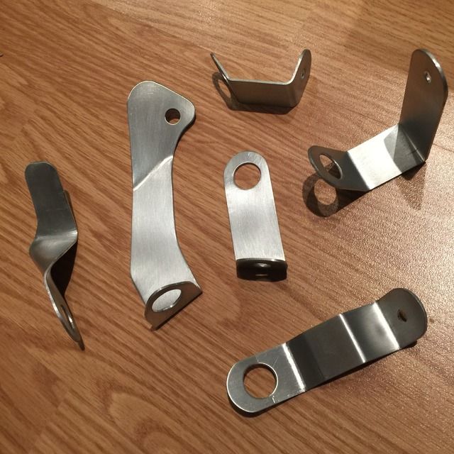

Hey gang, a very brief update this evening....lots of thinking behind the scenes, but not a huge amount of progress that worthy of a detailed write-up or photographs.

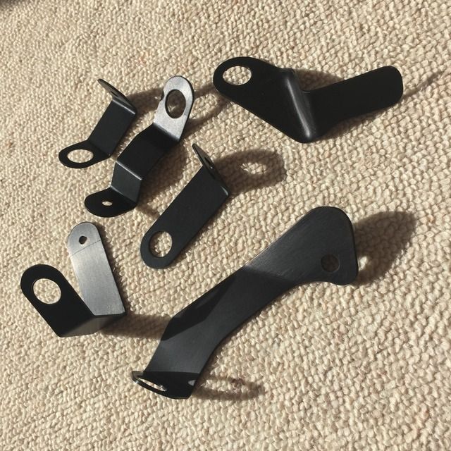

Easy one first - the above brackets are now back with me, nice-n-black and mostly back on the car with nozzles installed and tightened.
http://img.photobucket.com/albums/v2...99C36C8DCC.jpg
The bottle is also back, filled and altered to remove the "T" fitting and install a single outlet...
http://img.photobucket.com/albums/v2...1B82319D9E.jpg

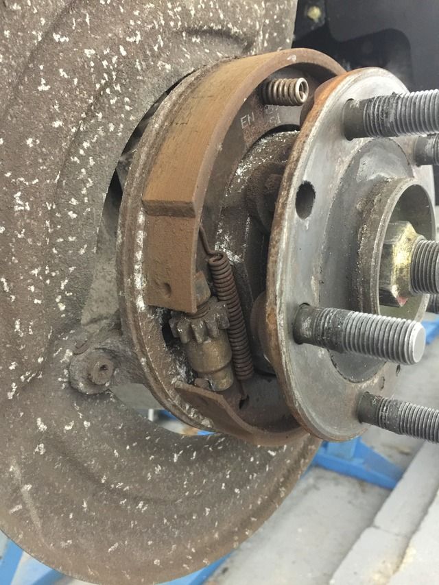

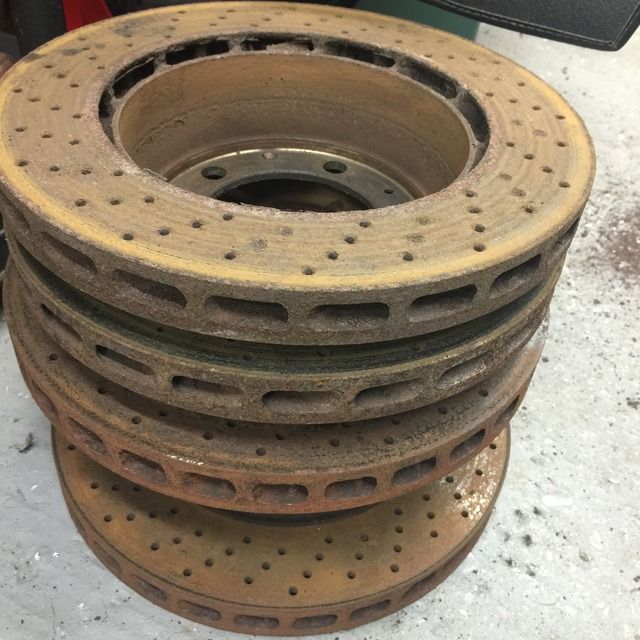

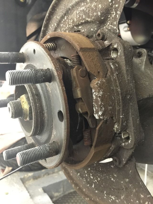

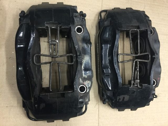

Next one, I'm onto brakes. I was hoping to make-do with the existing discs; they've looked tired since I took the car off the road, and I was aware of corrosion on the inner faces, but I had hoped that by removing them and spending some time with a wire brush on the end of an angle-grinder, they'd tidy up well enough for me to get the car mobile and do the low speed mapping. For sure, they'd get replaced before using the car normally, but this is just a case of postponing a £1,500 bill!
But...the fronts are way past recovery. The inner faces show evidence of only the central third having decent pad contact, the inner and outer diameters are really badly pitted. Also, when cleaning out the vanes and the inner bells, a tonne of rust was removed....worryingly of course, this is structural brake disc material.
I've not yet removed the rear discs/calipers.

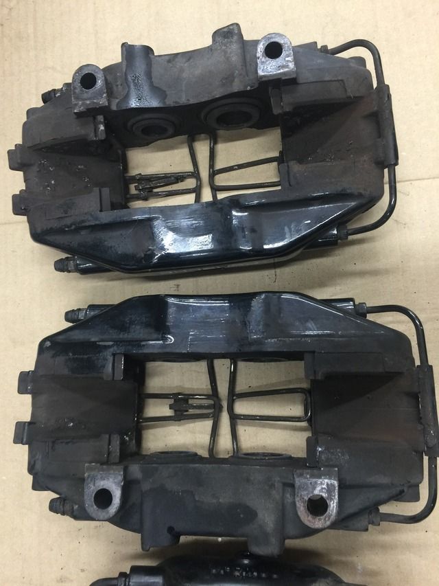

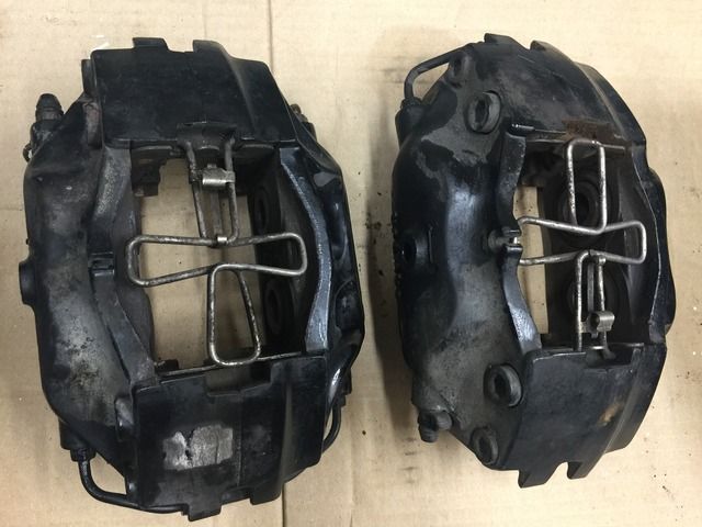

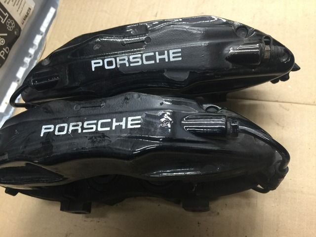

A job I'd wanted to do since I bought the car, was to get the calipers refurbished and nicely repainted. This is now looking like a priority job, based upon the fact that tonight I removed the RH caliper to try and ID the pads (bizarrely considering the inner face issue, they felt very strong with great initial bite)...the inner pad was seized, no way was that going to slide nicely.
With what I could see with the pads in situ, I thought that a previous owner had perhaps installed Pagid RS4-2 "Blue" pads...signs of blue paint but again looking tired. Turns out they're a brand called "SBS"...not heard of them before, but some light Googling shows that they seem to be a brand well known in biking circles. There's about 9mm left on each, but seeing as I'm going to the lengths of a complete refurb, to skimp on pads now seems a bit daft.
So...thoughts are that either I go for:
  • Pagid RS4-2, which I *think* are installed into the front axle on the Lotus - frankly, they're the best brakes I've ever used, absolutely awesome for road use...neck snapping with warm R888 tyres (and, to be fair, larger floating AP discs).
    or
  • Pagid S compound - track heritage but marketed as a fast road pad. Initial bite and progression/feel are my primary requirements....this isn't going to see a track, so fade and pad heat transfer are far less important.
Anything that chucks metal filings out the wheels (Hawk) are no-go, and if they don't throw a tonne of dust over the wheels, that would be great.
I used Pagid RS-29's (yellow) on my previous GT3, a 6-pot caliper along with Alcon floating discs....not bad, initial bite wasn't the best, and were quite fussy in terms of bedding them in correctly. I never tracked the car, so can't comment on durability or resistance to fade (although they're supposed to be awesome)
So, the shopping list this week now has:
  • A set of 4 discs (Sebro, I'm really not fussed about having the Porsche box that they get delivered in)
  • New pads
  • New caliper mounting bolts
  • New damping shims (they weren't even fitted to the existing pads, probably to ease removal/refitting whilst doing some track work)
  • New rigid lines from caliper to hose
  • New stainless hoses
Regarding the caliper rebuild, robt964 over on Rennlist used a company called Brake Caliper Refurbs, who looked to have done a superb job. Speaking with Rob, a few years down the line and he's still very happy with their work, which involves vapour blasting to remove paint, triple sanding the faces to get them ultra smooth, then acid etching before painting/lacquering. Finally, a ceramic coating is applied (similar to a nano coating) that increases the resistance to brake dust.
I gave BCR a call this lunchtime to chat this through; for the work involved, including replacing all fluid seals, re-plating the spider clips, full refurb of the sliding plates, and if needed, new dust seals (I'll get them done as a matter of course) and new bleed nipples, it's money very well spent. You wont get anywhere near with a DIY effort by the time you buy the paint, seals, new screws, etc, etc..not to mention re-applying the Porsche logo on the faces. I have better things to spend my time on.
Check out their FaceBook page for plenty of examples of their work..... https://www.facebook.com/BrakeCaliperRefurbs
I think I've decided to go for red, a-la Porsches "S" models....a departure from the stock external look that I've gone for so far (apart from brake ducts and clear indicators), but it's a bit of a nod to something-not-quite-being-stock-under-the-hood ;)
So, about to be very broke again this week! :D

A solid evenings work....messy, but productive!
All four corners are now dismantled. Having bought a set of Laser hose clamps, I can whole-heartedly say DON'T BOTHER....load of crap. The first one snapped the pivot on first use, the others twist so much that they don't effectively clamp the hose. They can go back.
So, time to must a collection of mole grips; the stock rubber hoses are going in the bin anyway.
All 4 link pipes from rubber hose > caliper now need replacing...thought they would, they twisted when undoing them, due to corrosion on the 11mm ferrule.
So, here's the motley bunch of black(ish) calipers....
http://img.photobucket.com/albums/v2...5F9A84AD76.jpg
http://img.photobucket.com/albums/v2...99ABAA8DA7.jpg
http://img.photobucket.com/albums/v2...A2ABDC8B15.jpg
http://img.photobucket.com/albums/v2...9597251975.jpg
http://img.photobucket.com/albums/v2...28BD25EFBC.jpg
http://img.photobucket.com/albums/v2...7E5D8E3544.jpg
And a stack of rusty iron....
http://img.photobucket.com/albums/v2...B56CE24DFD.jpg
The handbrake assembly also looking second-hand, so will probably replace these shoes as well, giving everything a thorough clean, and be done with it.
http://img.photobucket.com/albums/v2...2183DECB40.jpg
http://img.photobucket.com/albums/v2...C8D22B54FF.jpg
And the front hub assy....
http://img.photobucket.com/albums/v2...17078D04E5.jpg
I've just got to employ some self-restraint and not get sucked into stripping everything like backing plates, hubs, ball joints, etc, in order to start replacing or refurbishing...otherwise I'll still be writing updates on this project this time next year.
