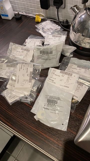

Very quick update - my new fasteners arrived the other day, so I've steadily been able to swap-out the old fixings for the new ones. Nothing spectacular to see here, none of them are even shiney, just a dull almost galvanised finish. Hard to dress up what £600-worth of nuts'n'bolts looks like, but here's some pics anyway, just to prove I got them, haha.
As mentioned previously, effort is going into the house project right now but I have almost finished making the steering rack stops. And still not rigged up the plating kit. Hmmppphh. I'll post pics of the front suspension build when I'm further along, it'd just be a spot-the-difference competition otherwise.

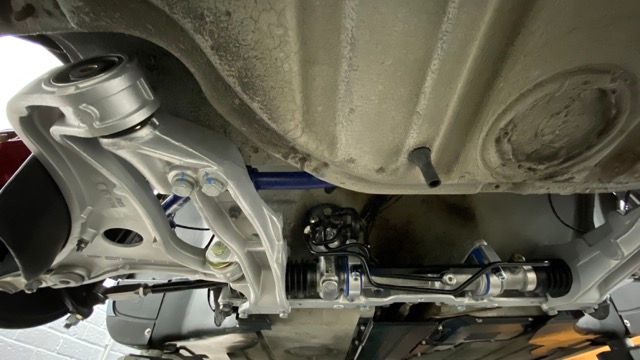

Hi everyone, long time/no update, sorry about that, been busy on other projects (motorbike, work, etc) but let’s have a go at trying to remember the last year or so….
Update Part 1 – Chassis
So, the last time I updated the thread, back in the middle of the U.K.’s “Lockdown #1” in 2020, I’d just received the consignment of replacement fasteners for the suspension refresh. Until then, it was assembled but using old fixings that had been stripped of plating and rust, and potentially ready for re-plating.

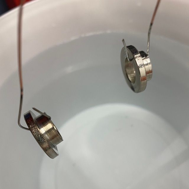

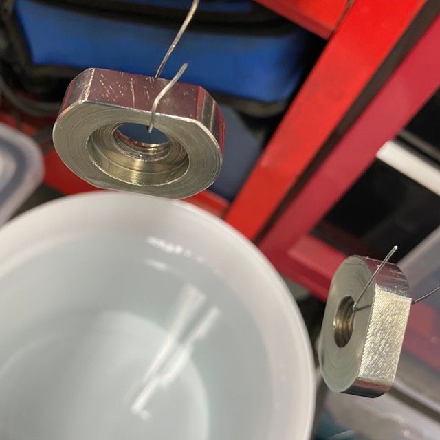

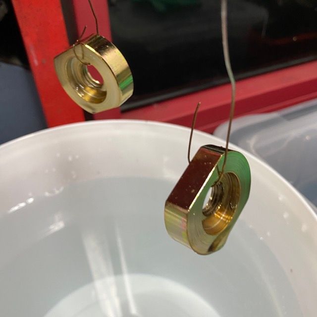

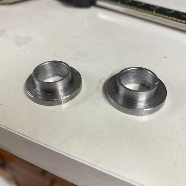

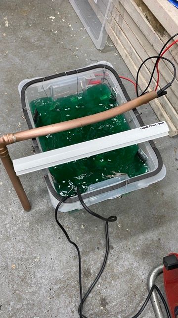

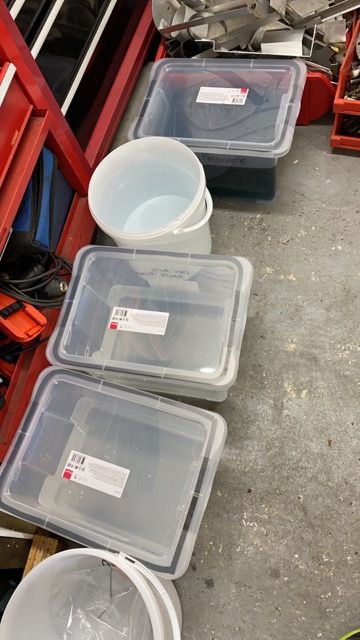

Here you go, a load of semi-random photo's I took along the way. First off, the plating setup for the parts I was comfortable refurbishing...

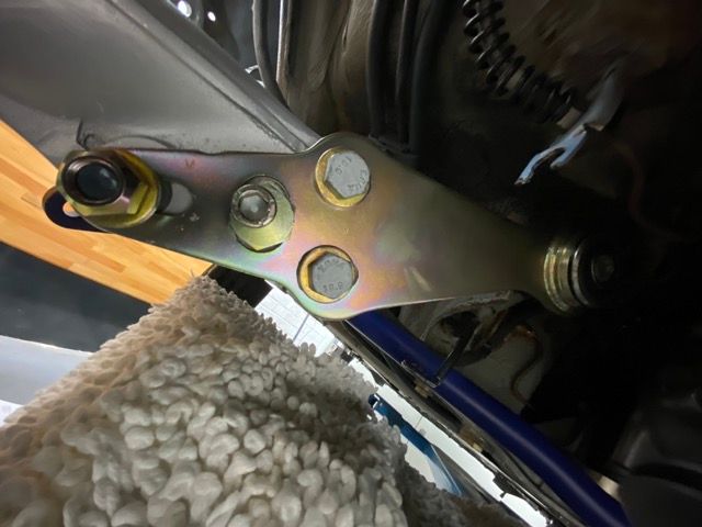

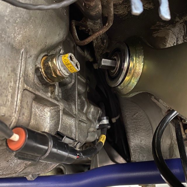

Steering lock stops in-situ on the rack...
Rear suspension bearing retaining plates

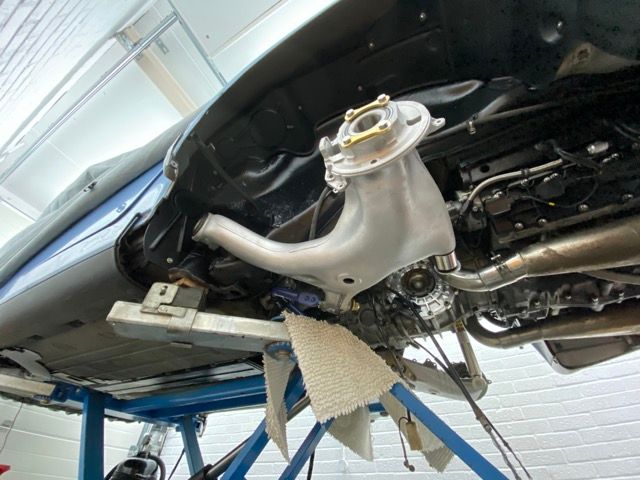

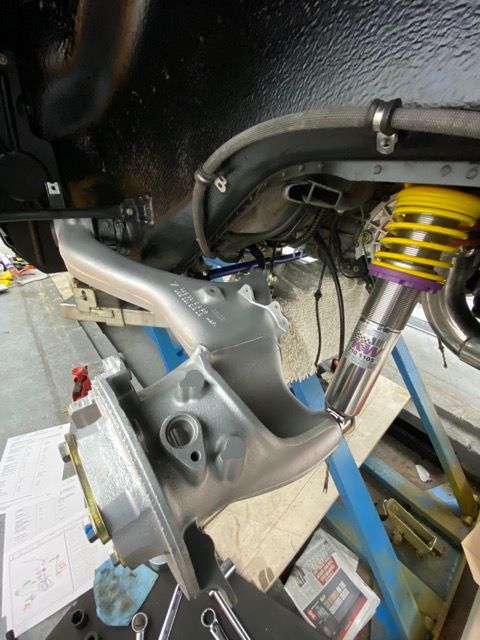

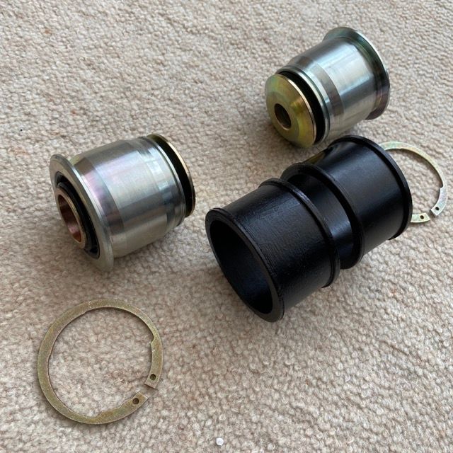

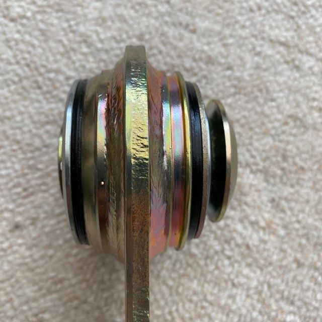

The rear suspension plates were plated by the guys I usually use; by this point companies in the UK were starting to open back up. These were just too large to fit in my plating tanks (and maintain the right proximity of the anodes)
All assembled with the new Elephant Racing bush pack...

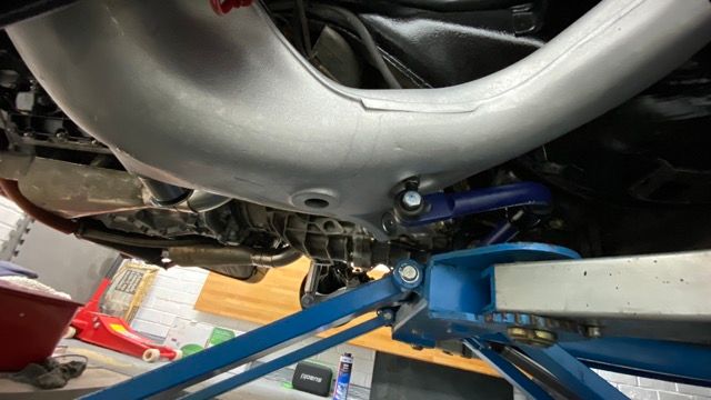

Some more progress shots of the front and rear suspension being rebuilt...

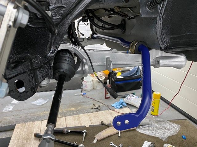

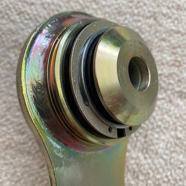

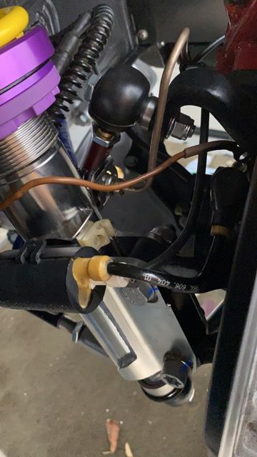

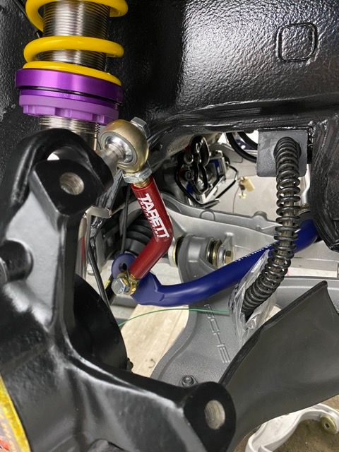

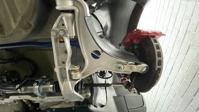

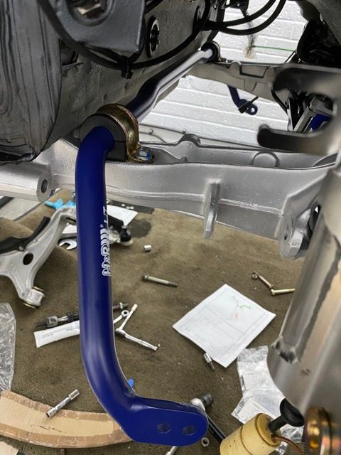

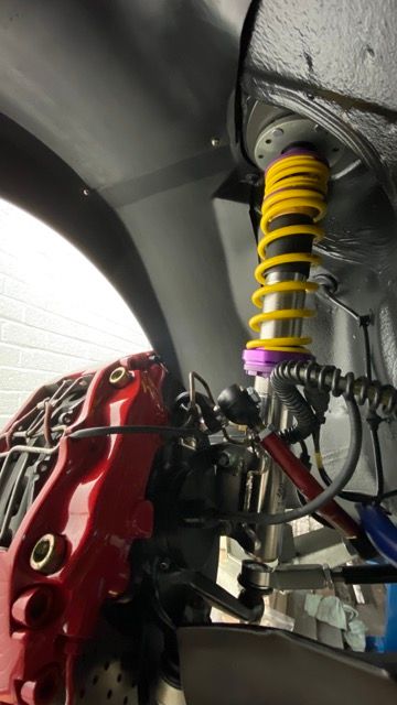

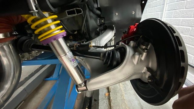

Front suspension....

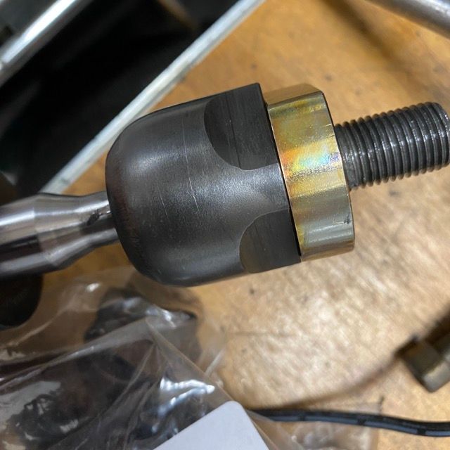

Elephant Racing bump-steer "correcting" (assisting) rod ends...

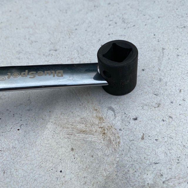

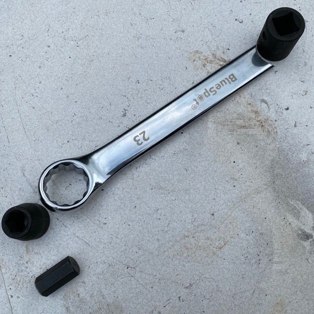

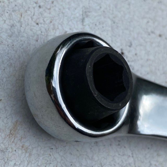

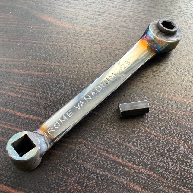

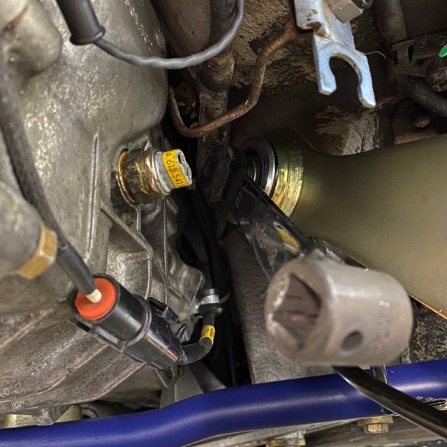

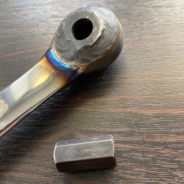

Next challenge was to make a tool that I could use to torque the spring plate pivot bolts with. Access on the RHS is very tight (it's asymmetric, left to right)...
So, time to get creative and hack around a spanner and other sundries...
And then you can get it into the hex just fine. A quick re-calculation of the required torque, and job's a goodun'
If memory serves, swapping over the old fasteners for new ones was very easy. The next job once Covid restrictions allowed was to drive the car across town to get a pal of mine to set up the geo very approximately to 964 RS settings. Although he has a laser alignment rig, it’s not a setup like a specialist chassis setup operation has….so this really was just a case of getting the car in the ball-park, usable and driving in a safe non-shopping-cart kind of way. Which we did, and I did get some use out of it between lockdowns in summer 2020.

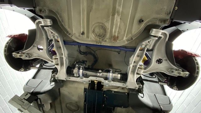

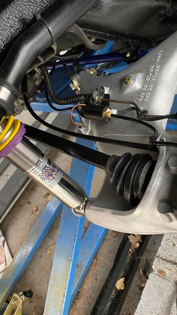

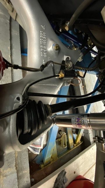

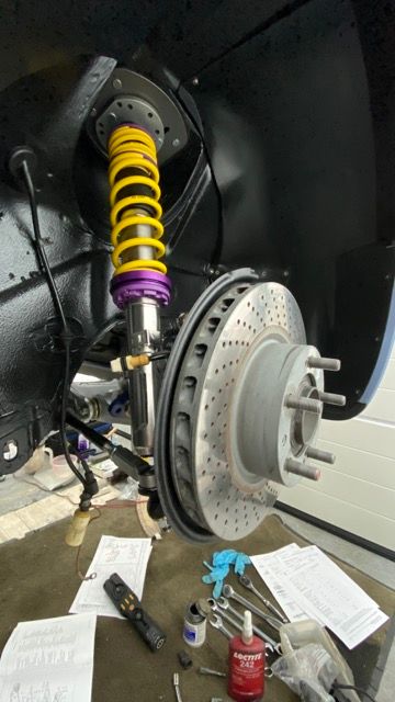

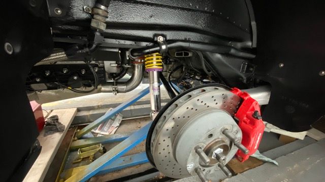

Some more photos of the suspension completely reassembled. Actually was really rather proud of my efforts on this, if only it would stay this clean and nice.
The Tarrett drop links did have the rubber boots installed; definitely a knck to doing them but easy enough once you do the first one.
Not long after these photos were taken, I then sprayed everything with the waxy Dinitrol (clear) protective coating. Which instantly makes it look grubby! Oh well, it'd there to do a job I guess.
Rear suspension....

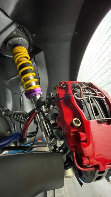

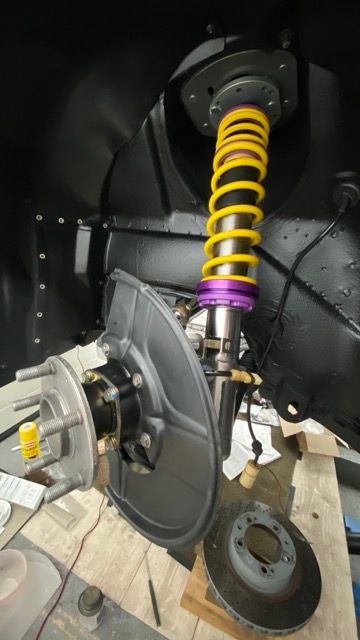

Front suspension....(again, in no particular order)

Are those helper springs (near zero rate) on the dampers?
If yes, the helper springs really should be on the damper body end instead of the shaft end.
I checked this with KW in the UK. They verified that how you see them in the photo's is how they're meant to be.

Well, the reason the helper springs should be on the body end becomes clear when you push the coupler (the piece between the two springs) laterally. If the coupler is on the shaft, it can move quite a bit more than if it were on the body. In other words, the spring to spring interface is more robust if it happens on the body of the damper.
In droop situations while driving, the spring is not as likely to stay centered if the coupler is on the shaft end. I saw one car almost destroy the coupler due to spring movement. The problem was immediately solved by putting the helper spring at the body end of the damper.
The more droop you have, the more pronounced the centering problem is. I just sent my dampers in for a refresh and had the droop reduced to 2" front and 3" rear. Now the helper springs are more compressed than they were so the likelihood of a spring centering problem is reduced. Nonetheless, I still mount the helper springs on the body end as there is no chance for a problem even at full droop.
Sure, this problem is more likely to happen on a race car, but why not eliminate the possibility?

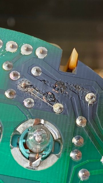

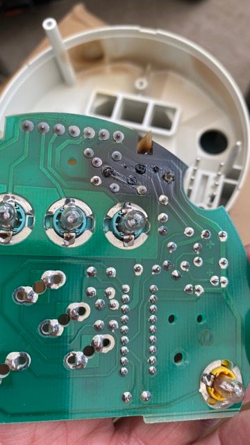

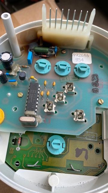

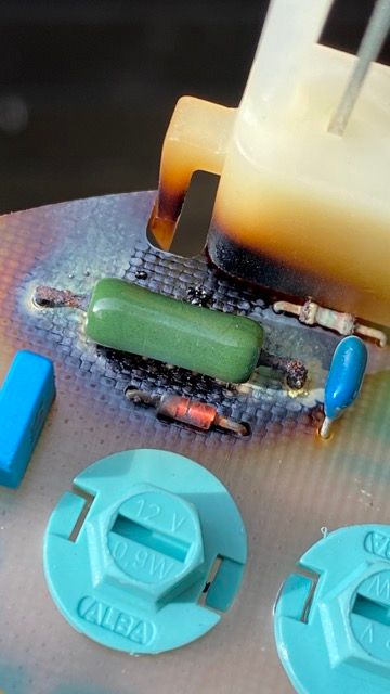

T3) To try and finally get the rev counter to work. It had previously worked just fine with the old MBE ECU on Build #1, but had never so much as flickered into life with the Syvecs, annoyingly.
The guys there did an awesome job, they really did. Candidly, these were jobs I just didn’t have the willpower to keep going at. Fixes thus….
F1) I’d tried diagnosing the battery current drain, and wasn’t seeing anything obvious. Chris spent some time working it, and did find some wiring strangeness with the ECU harness. I have to admit, I can’t remember exactly what it was, but whatever he found was occasionally keeping the ECU from powering down after engine shut-off. He’s pretty handy with making looms himself, so I had confidence to just let him get on with it and resolve, which he’s done. I’ve had the car back since the 22nd December, and not once had it on the battery tender, with no starting issues.
F2) Whilst in the mood for wiring, we got our heads together and found a way to overcome the idling issue. By taking a feed from the A/C compressor clutch, and using that as a signal into another input of the ECU, we can now detect the additional electrical load and switch to a higher target RPM map. It works flawlessly; activate the A/C and it’s undetectable that the engine will then switch across and run a few hundred RPM higher. We’ve tested it with not only the A/C but also windscreen wipers, headlights and main beam lamps all switched on simultaneously, and there’s no stalling or fluctuation of the idle.
F3) This one was *fairly* straightforward for Chris to investigate….
[Background story…] I just realised that it was a year ago when I had a few spare moments over the Christmas/NY break, and decided to have another go at trying to get the tach working. No idea what I did, but when I went to start the engine again, there was absolutely nothing. It cranked but no sign of bursting into life. I bit the bullet and dropped the ECU off with Syvecs for them to diagnose, and I’d done a proper job (!!) and blown both drive-by-wire outputs and an onboard fuse, lol. A week later and £130 lighter, and the ECU was back with me and back to normal. Time for me to hand this little issue over to somebody else.
So, according to the SCal s/w, the tach driver output from the ECU was setup correctly, the output pin and number of pulses all checked-out OK. All fingers pointed at the rev counter itself. Not what I wanted to hear, as getting this repaired was going to be a right pain….1980’s/90’s tech is long forgotten, so I thought.
Big thanks to Matt at Fearnsport who very kindly lent Chris a known-good 964 tacho for us to test with. Per Chris’s suspicions, within 30secs of plugging it in to my car, we had a needle doing its thing and reading correctly. Arse.
In terms of repairing, I had a tentative lead on the guy in Germany who actually worked for VDO at the time and designed this exact unit. However, this turned out to be bloody slow in terms of reaching out via somebody else, to persuade him to take on this job. Like a lot of the specialists out there, because of the current trend to restomods, they’re inundated with work and getting choosy as to what they want to do. Luxurious position to be in. Wish I could do the same [tut].
I went up to retrieve the rev counter, got back home and opened it up. Yup…..I think we’ve found the smoking gun…..
IMG_2826_2
IMG_2825_2
IMG_2823_2
IMG_2822_2
Having retrospectively trawled the forums and thanks to John (304065), we found that this isn't an isolated incidence, it's been seen before. Not sure whether it's something that just happens under certain conditions or whether we accidentally stuck 12v up its arse when the wiring harness guy and I were trying all sorts of things to try and get it working. Who knows.
I then had a brainwave. Good old Tore over in Norway, from Bergvill F/X! I’d liaised with him a number of times some years ago, he’d been helpful in diagnosing and fixing my HVAC, and I’d also bought a few things from him too. As it happens, he now has all the diagnostic and test gear to repair these units. He also took care of the shipping paperwork (sounds a menial task, but post-Brexit it really isn’t….incredibly frustrating and time consuming while we all get our heads around the new system). It was exactly 1 week between the rev counter leaving me and then receiving a lovely DHL parcel with it all repaired. Not only did he replace the blown components, and repair the PCB track that had vapourised, he also did some preventatively modifications to the OBC components on the board below, as these are known to expire. A new set of bulbs fitted and it’s now got a guarantee.
