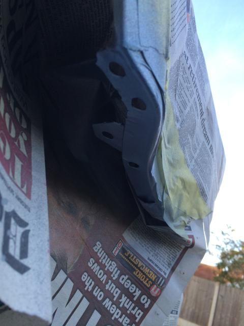

I noticed that the underside of the return lips on the front wings, which have spire clips in place to attach the bumper, were both quite rusty. Obviously some water had got between the metalwork and the rubber seal that sits between the metal and the bumper. The drivers side, strangely, had also been buckled slightly, but seeing as I was removing the rusty clips and rubbing it back for a respray, it was easily bent back out. Some zinc primer, 2x coats of colour and 2x lacquer and it's all good again.
Just about got this done before losing the light, but I think I'm now in good shape to finally get the bumper reinstalled....subject to maybe opening out the dummy RS-a-like air ducts. A quick job with a die grinder if I decide to do it.

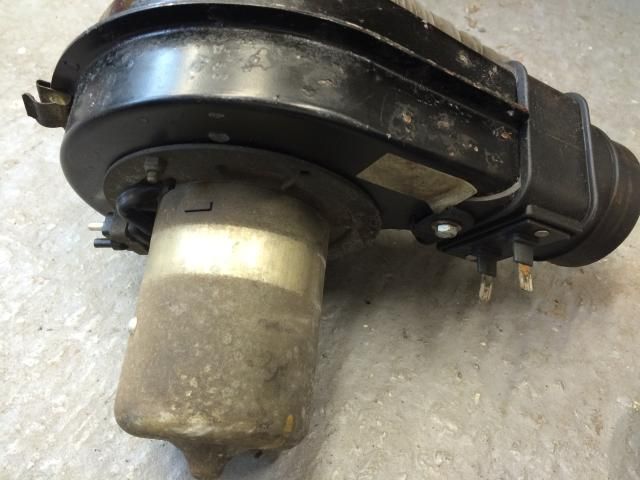

Rear Blower Fans - Refurb Pt1
Evening all,

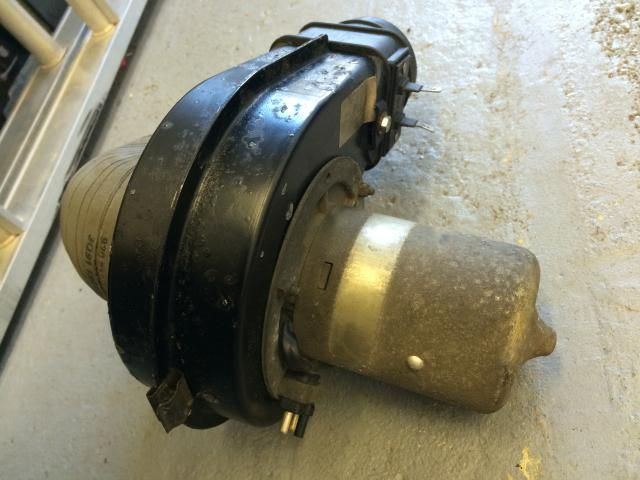

Time for a quick check-in. Per previous post, been a hella 3 weeks so not a lot of progress. However, the odd few minutes I have managed to grab in the garage over the weekend and this evening, have meant I've been able to finish off the rear blower fans refurbishment.
This is what they looked like when I removed them --->

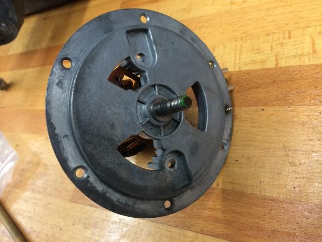

So, some stripping down was easily done once I sussed that the impeller needs to be removed to reveal the screws that hold the motor casing on.
Wire brush the motor housings with the angle grinder, ready for painting. The fan housings were just sent straight out to my powder coating shop for incineration, bead blasting and coating.......

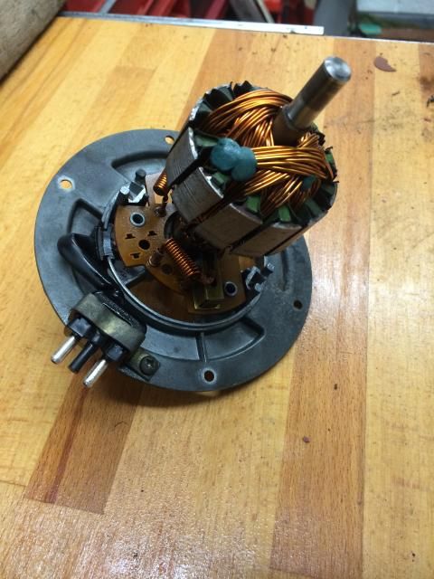

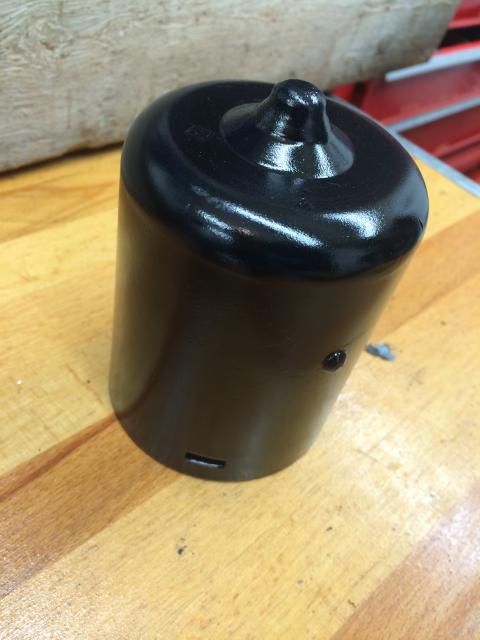

Rear Blower Fans - Refurb Pt2
I collected the powder coated housings the other day....another exemplary job from Windridge Coatings --->
....like new again.
Armature and housing degreased (although the staining in the aluminium makes it look dirty still...rest assured it isn't)
The motor casings have got the magnets fixed to the inside using spring plates and rivets with lock washers; didn't fancy removing them and risk something breaking so I decided to clean out the dust and muck from inside, wire brush the outer plated surface, etch-primer, paint and 2x lacquer coats for hopefully a durable finish --->
Plastic end caps that house the thermistor were thoroughly cleaned, the impeller refitted to the armature, then all reassembled with new nylocs. The stainless elbow on the plastic section is a new part from Porsche; for some reason I had one stainless item on the other fan, and a mild steel one on this fan. The steel one was rotten as hell, but thankfully was the cheaper of the two! (A lot cheaper).
The passenger side (LHS) fan has the 90deg rubber elbow, which cleaned up great --->
The drivers side (RHS) joins onto the black 90deg rubber elbow that is fixed to the rear RHS corner of the engine bay...I think....been a long time. All the fan fittings were re-plated a few years ago, so time to dig them back out again and get the fans bolted back onto the car (maybe tomorrow evening).
Another job off the list.

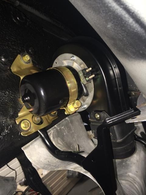

Rear Blower Fans - Pt3

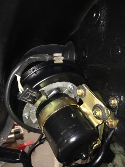

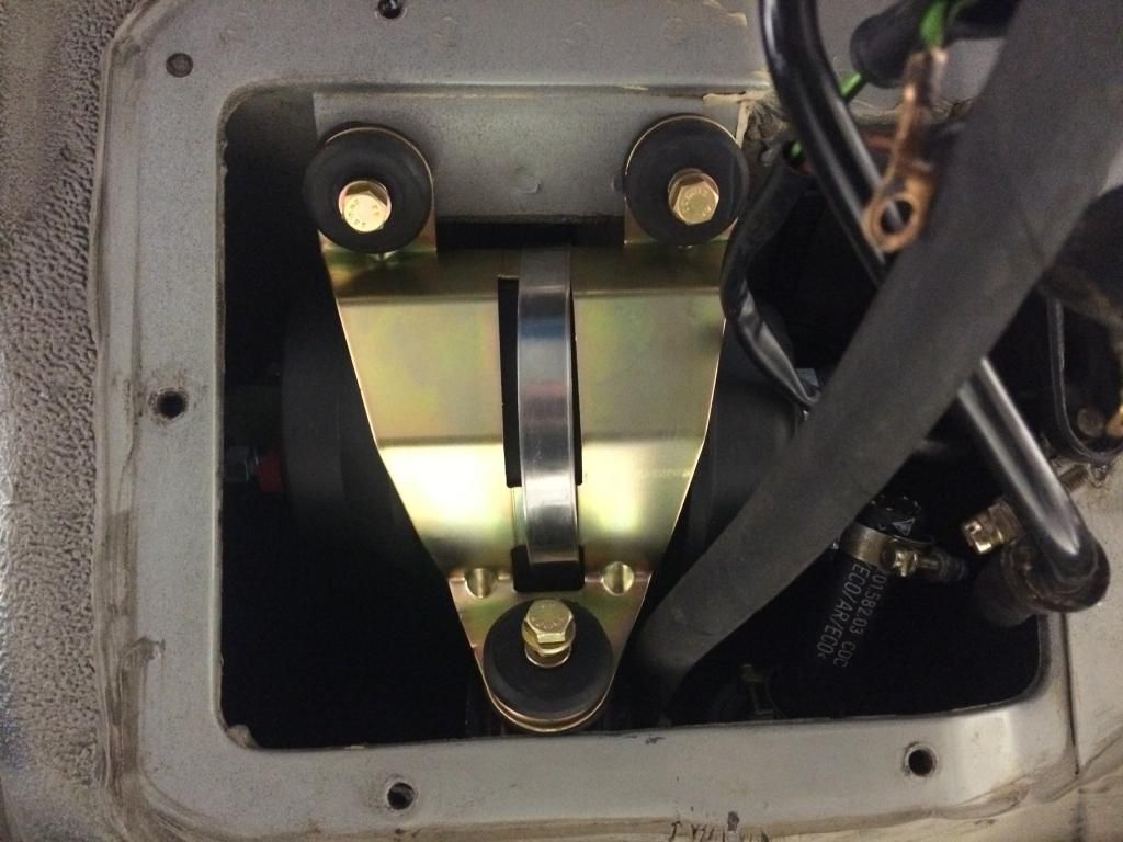

Time to refit everything....eventually found that long-lost stash of fixings, clips and brackets:
The RH side fan; for anyone doing this in the future, don't try bolting the two halves of the mounting bracket onto the chassis first, then mounting the fan onto the bracket...not enough room to manoeuvre it into place. Blower needs to be mounted on the outer bracket first, then the bracket bolted to its counterpart that's on the chassis. Still a wrestle to get it in without damaging the paint on the motor and get it into the 90deg rubber hose that goes through the inner wing, but it's do-able.
The LHS blower, by contrast, almost bolted itself into place. Just loosely bolted into place for the time being, until I can get the engine back in with the hoses hooked up. Until then, the positioning is just guesswork.

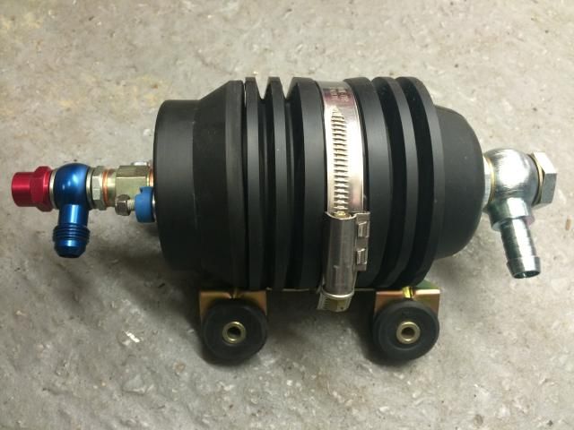

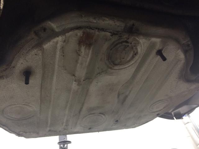

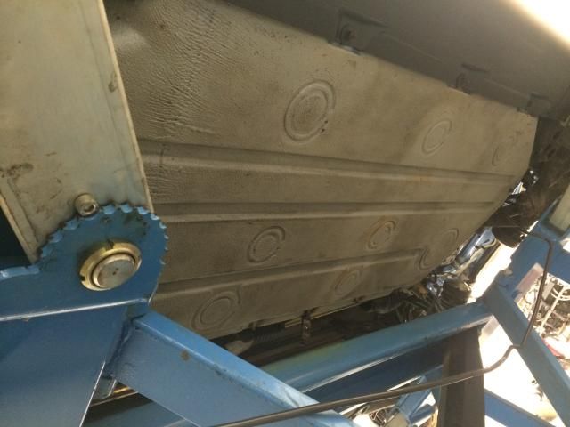

A job I've been meaning to do for a while is finish off the cleaning of the underside...filthy job, upside down and getting neat Gunk dripped on you, ain't my idea of fun, but hey, it needed doing and now looks pretty good for a "first-pass"....socially clean...great to see that there's no tin-rot, just one very small spot on the underside of the frunk that needs some light attention with a wire brush.
What spurred me on to finally get this done, is to get the front fuel pump area cleaned and ready for installing the new Bosch 044 pump and related plumbing. White spirit is a pretty good solvent for removing the horrid brown Dinitrol that the factory seem to daub everywhere/anywhere. Pump recess area is again immaculate and box-fresh --->
The new pump is now in it's cleaned up rubber damping sleeve and attached to the freshly replated mounting bracket --->
Initial placement of the pump into the chassis to see how the feed into the pump will work; the new feed hose from the tank outlet filter was not going to work as-is...too much of an "S" bend to mate onto the pumps inlet banjo without kinking the hose when the pump was bolted into place - clearly not going to work. A quick chop of the hose to make is more "L" shaped and I reckon it'll be fine (you can just about see it in the bottom right corner of the recess, with printed p/n) --->
The other end of the pump is pretty tight up against the wall of the chassis; the red anodized cap at the end of the non-return valve having just a few mm clearance. Maybe a quick realignment of the pump on the carrier bracket will sort this out (not the best photo but you can just about see) --->
Just waiting for a delivery of a load of stainless steel P-clips (hopefully today), then I can run the feed and return lines to the engine bay.
The rear pump and filter are (again) loosely in place for positioning purposes so I can make the link hose between the two, once the long runs have been cut out of the length of -6AN hose I have.
Next job is to to fit new electrical terminals onto the harness for both pumps; the 044's have larger diameter binding posts. Only a quick job to cut and crimp on some new ones...will probably take me longer to drop the car off the lift so I can get in the loft and retrieve my box of electrical fittings.

Spencer,
Looking amazing, friend!
You can shorten both fuel pumps by removing the spacers on the pumps' outlet side. Buys you a fair amount of clearance in the front trunk compartment, and more room on the rear pump so the AN fitting doesn't hit the PS fluid reservoir.
On the front pump, you can use a 12mm barbed inlet fitting (ex: on TK website) and then stock tank-to-pump hose can be reused. Probably higher flowing than a banjo on a low (no) pressure fuel feed circuit.

Thanks Chris!....yes, I'll have a play with the pump fittings, although I've now cut the new tank outlet hose, so if possible I'll try and keep it. The rear pump with the 135deg -6 fitting does actually clear the PS reservoir (although it looks like it hits in the pic)...it sits behind the curvature of the bottle.

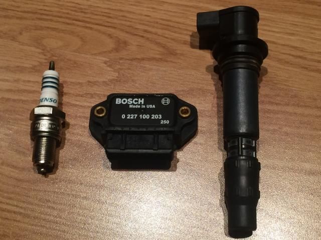

By the way, if anyone wants to know the combination of parts I'm using for the above ^^, it's:
12 x Denso Coil-on-Plug units - speak to Chris @ TurboKraft
4 x Bosch Ignition Amplifiers - 3-channel per unit (part number on the unit in pic)
12 x Denso Iridium IW24 spark plugs
The MBE 9A9 management unit is, by default, shipped to be able to drive the CoP's directly, but not 12 of them! (think they're limited to 8 or maybe 10 ignition outputs). So, MBE made me a "special" unit with different drive outputs, that allow connection to external amplifiers like the Bosch units above.
