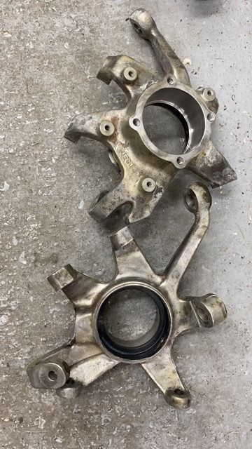

The suspension structures were collected last Friday by my local vapour blasting company, then returned to me on Monday. Needless to say, I'm absolutely delighted with how Steve has got these to come up....
In addition, I also asked Steve to blast the trailing arm spring plates, ready for plating....
There is some pitting on one face of each - thoroughly expected, but with the peened finish that the blasting leaves, these should electroplate nicely.

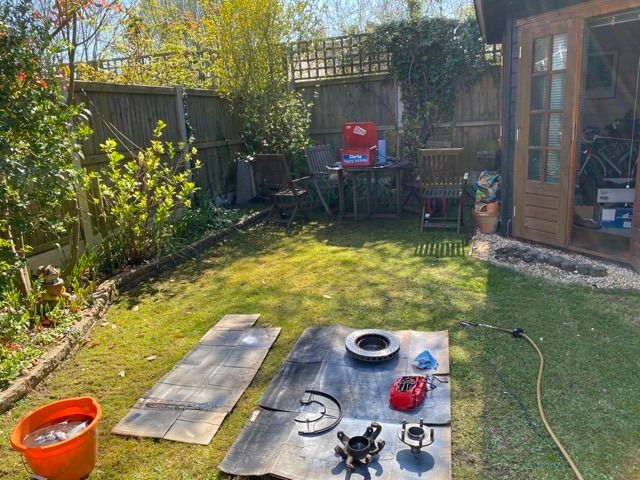

Little bit of a tardy start today - needed to do another lathe job, rigging up a patio heater head to a new heavy duty tripod stand that was delivered yesterday....got to have some evening heat while chilling outside. Looks like we're going to be confined for a good while yet, may as well make the most of it!
So, proper preparation of the front uprights and hubs. Time to use the angle grinder with wire wheel attachments. Apologies to the neighbours, not the quietest of jobs. The new paint also arrived yesterday, so I'm keen to get this underway. For those who haven't heard of POR-15, it's "Paint On Rust". However, the state of the uprights was nowhere near just painting straight over it, not that my OCD would ever allow that anyway....
A heady mix of genuine rust, some remaining factory black coating (looks to be an epoxy, with a cream base layer) and other areas with Dinitrol still over the top. Not much of that, mind you, just some areas on the arm connecting to the ARB's.
4-5 hours of hard slog (I really should've got Steve to vapour blast these last week; partially forgot, but also didn't think it'd be quite the job it turned out to be), and this is how they look. Not perfect - they don't need to be, so long as the epoxy is off (it is) and any surface corrosion is smooth.
As mentioned above, I've gone with their grey base coat but the way you apply this is to paint on a thin first coat, then when that is tacky (a slight drag to the finger, usually 4-6hrs later), apply the second coat. Wait for that to harden, use 350 grit w&d to sand it off if required, then spray the UV stable satin black top coat. This top coat can also be applied direct to the metal (or rust), it doesn't need the base coat, but offers more corrosion protection with both layers, naturally. Interestingly, the curing of this paint is actually quicker in humid/damp conditions - it uses air moisture to harden, the opposite to regular paint.
My plan is to use primer on all surfaces other than machined faces, but then a thin layer of black top coat onto these faces (not bearing faces obviously) to protect them. It's currently 22.30, so the timings don't work out for doing it tonight, instead I'm going to try and install some of the Elephant Racing bushes into the front control arms. They've been in the freezer for over 24hrs now, so gentle heating of the arms should allow these to go in relatively simply. He says, fingers crossed.

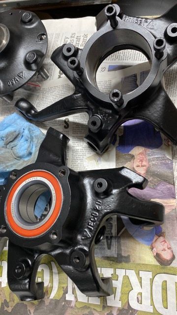

Final update for the weekends activities;
The front and rear hubs, as well as the uprights were all prepped with the POR-15 preparatory products today. This was stuff left over from my not-so-successful first effort on the Lotus a few years ago.
First step is to use their degreaser. This coupled with an Ikea dishwashing brush is perfect to give them a damn good scrubbing, then wash in water and allow to dry.
Then use their Metal Prep; spray on and keep it from drying out for 10-20mins. This will remove any remaining surface rust (or I guess neutralise any non-removable rust). Wash everything again and allow to dry. All the hard work from yesterday is now undone, as the parts looks pretty grim with whatever that prep liquid is doing.
Parts now ready for painting. The grey paint I'm using as a base layer is super thin, no way you're getting good coverage with a single coat, and even two coats would be nowhere near what I'd be happy with - but this is just an undercoat for me, so happy so far.
First coat...
Second coat...
I was told to apply the second coat before the first coat fully cured, about 4-6 hours...actually, it was a lot quicker than this, and perhaps it'd gone off a little too dry, but the second coat did seem to go on okay. It's now drying overnight, ready for a quick sand (keying) tomorrow and a top coat in satin black.
Not a particularly interesting post, just a case of moving things along. The key selling point for POR-15 is how tough it apparently is - the videos you see show the guy absolutely laying into a section of pipe they've coated in it, and the thing is buckled before any any paint damage is seen. For sure a healthy dose of sales BS, no doubt, but even if it's half that durability, it'll beat anything else I've found this side of powder coating.

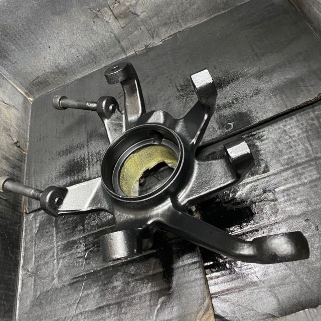

Nightly update....
This evenings job was to scuff the surface of the grey paint - seems a shame given how glossy it is, but more important the top coat keys correctly. This paint has set HARD - it feels very durable indeed, I'm starting to change my opinion on this stuff. The odd run of paint needed to be cut off with a sharp blade; 180 grit paper was barely touching it. Red Scotchbrite to scuff the surface was fine.
Some masking up of the bearing surfaces, and carefully applied grease to the inside faces where the balljoint taper fittings will go (easier than fiddly masking tape and will wipe off afterwards).
This is just the first coat, now drying overnight. Pleased with how these have come up; the hydraulic pipework has come up nicer, as it's been sprayed directly onto the prepped metal, no grey base coat. The finish on the hubs and uprights looks identical to what a powdercoated finish would give. Some of the "fidelity" of the markings is not quite there - it's bound to happen with 3 coats (so far), but it's more important that it does the job being asked of it, to remain durable to wear and not to allow rust back.
Second black coat tomorrow night, then let it harden for 48hours before fitting the new wheel bearings.

Rig it up on the press, and they went in without even troubling the pressure gauge - very light pressure required to push them home....
Then onto the rear trailing arms. For some reason, both started off slightly cocked for the first few mm....on the first arm I kept going, a slight bang as it snapped straight, then it went in like a dream.
The second did the same, no matter how much fiddling I did on the rig to try and get everything square. I should've just used the bearing removal/install kit and not bothered with the press....
This niggled me, so I then quickly set about removing the second bearing to inspect the bore, BEFORE the bearing thawed out....in my haste, I grabbed the fcuking 78mm mandrel, instead of the 80mm.....5mins later, the bearing came out, no damage to the bore other than slight scuffing that can be Scotchbrited out....and then I found that the mandrel had buried itself into the back of the bearing, pushing in, and fcuking-up, the seal.
Beyond pissed off - I should've trusted my instinct and bloody well left it alone. Now I'm back to square fcuking one, in lockdown and unable to just go and get a replacement. Was about half a twitch away from launching the bloody thing across the workshop.
£110 down the fcuking shute and another delay. Thankfully, good old Chris can still get them and send one across with another few bits that were due to be sent anyway.

The rear wheel bearing installed on the RH trailing arm...
And the buggered bearing from the LHS....
Thankfully OPC Tonbridge had one left in stock, and now the means to ship it out. Hopefully it may arrive either tomorrow or Saturday.

New bearing arrived - what they look like before you bugger them up...it's currently in deep freeze...
