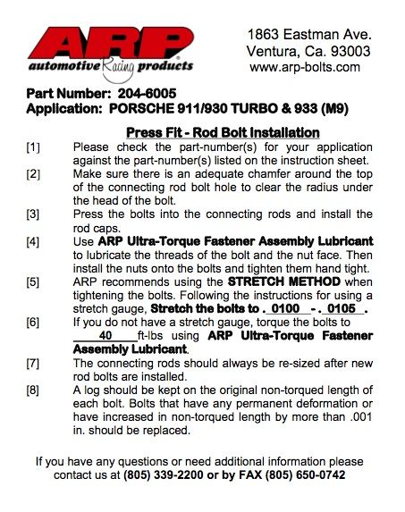

Have now received everything I need to start building up the long block on my rebuild; new pistons, new Nickies and rebushed small-ends in the existing rods.
Appreciating that everything *should* be equal across all 6 cylinders, but also appreciating that "assumption is the Mother of all f***-ups"....is it standard practise to plasticine all 6 cylinders? Of course, all 6 cylinders and heads have to be built to accommodate the cam carrier, but can I avoid fitting all pistons into the barrels, maybe just installing #1 & #4?
Second question - I've already installed my ARP bolts into the rods. I'm using stretch gauge to tighten them, but would feel more comfortable not fully tightening more times than I need to.
When dummy-building, what's best to do? Remove the ARP's and temporarily re-install the OE bolts, and torque up to spec for each rod....or keep the ARP's in place, but just nip-up each bolt (or torque to say 20lb/ft instead of approx 40lb/ft that is the ultimate tension).
Would rather do the second option (as the ARPs needed to be gently pressed in) but is this realistic for what I'm looking to achieve?
For background, I installed and tightened the ARPs a few weeks ago, when checking big end dimensions with new shells, and to ensure the ARP's remained elastic after a tightening cycle.

Spenny, did you get a torque procedure with the ARP hardware? I thought those were supposed to be excercised through 3 or 4 stretch to torque-then-loosen cycles for the purpose of conditioning the material. I don't think you can hurt the bolt material if you stay within the torque specs of the bolt, but make sure you use plenty of lube on the threads and nut face between each cycle if conditioning is indeed called for.

Hi AlfonsoR,
Yeah I'm right with you on practise runs - in fact I've probably now done 5-6 runs on assembling the crank into the case halves + through bolts, plus one go with the perimeter bolts too. All this was to Plastigauge the main shells - and a good job I did too, as the Glyco's I was sent gave me clearances that were out of (Porsche) spec straight away, despite all the main journals on the crank being well within wear limits....turns out they were made of a thinner material than my old 84k mile old shells, that were a better fit!....Have now fitted new OE Porsche items, which are bang-on.
So, not only valuable to practise the procedure for the time when I use the Loctite to seal it up, but it also highlighted an issue with the bearings.
Re the ARP torque instructions, yes, they do say to repeat the torquing procedure a number of times, but I read this to be the case if you were only using a torque wrench, and not a stretch gauge. AFAIK, the purpose is to burnish the threads, ensuring that no artificial tightness is being introduced into a torque measurement.
If you're using the stretch method, from what I've read, this is unnecessary, since ultimately, any method of tightening is only looking to achieve one thing - the stretch of the bolt which then provides the clamping force to the fastener....whether you achieve that clamping load with 37lb/ft or 42lb/ft is (almost) unimportant, so long as you stretch that fastener by 0.010".
(Of course, ideally you measure the stretch with the torque reading to ensure you haven't got a dud bolt)
But yeah, I did also use the ARP supplied lube on the threads and under the nut heads to ensure the stretch could be applied smoothly without any stiction.

I'm with you on the stretch method. Stretch is stretch, no matter what the torque applied (assuming it isn't way low) to get there was. Typically, I'd say you have to apply more torque to get the stretch than the torque spec. This would be so if you didn't burnish and use the lube the bolt maker specified, etc., because there'd be extra friction to overcome.
If ARP told you to stretch to 0.010", no doubt that is what you should do. Pauter, which supplied ARP 3/8" bolts with my 3.0 rods, said I should stretch 0.004-0.005", if I didn't just torque to 50 lbs/ft per the instructions which came with the rods. I had to inquire as to the stretch. In their standard instructions they just advised "Always oil threads with motor oil when assembling."
Stretch seems to me to be the better and more accurate mousetrap. But on top of that, you can then determine if the bolts can be reused or not come next rebuild (which for us racers comes way more often than 200,000 mile street car motors).

Hey Walt, yes, I have to say that after years of simply working by torque settings, it was a very pleasant revelation to use my new stretch gauge for the first time - somehow it's far more "meaningful", feeling like the fastener really was done up accurately....sounds weird, I know, but in the back of my mind I always wonder about the calibration of torque wrenches (no matter how good, what brand, digital/analogue...they all need calibrating at some point) and the lives they live. Mine live outdoors, in a very nice padded drawer in my tool chest, but all the same, they're in the garage, cycling with ambient temps that we see here in the UK. Not mega swings either way, but nowhere near controlled lab conditions either.
The metallurgy element of the fastener was also brought into stark relief when you can see, on the gauge, it shrinking back to it's original length when undoing it. It's like the principles of a subject finally "clicking" (pun totally intended) in your mind when learning something.
Anyway, suffice to say, smitten with my new gauge!

ARP rod bolts for 3.0 liter.......
You need to stretch the ARP rod bolts as specified by the supplier between 0.0090"-0.0100" or torque them @ 50 ft-lbs. Here are some numbers (elongation) for your perusal:
@ 40 ft-lbs.-------- @ 50 ft-lbs.
1). 0.0089"-------------0.0100"
2). 0.0089"-------------0.0095"
3). 0.0084"-------------0.0097"
4). 0.0081"-------------0.0091"
5). 0.0077"-------------0.0092"
6). 0.0085"-------------0.0100"
7). 0.0079"-------------0.0093"
8). 0.0080"-------------0.0094"
9). 0.0082"-------------0.0097"
10). 0.0077"------------0.0092"
11). 0.0078"------------0.0095"
12). 0.0084"------------0.0099"
At 40 ft-lbs torque, the elongation is less than the specified value (0.009" - 0.01"). It is spot on @ 50 ft-lbs. HTH.
Tony

Hi Tony,
Thanks for the info but I'm OK with the spec for the rod bolts - the spec for my kit is actually different to what you post (I'm guessing for the 3.0, yours are the M10 variety?...The later Turbo's use M9, hence lower torque spec)--->
...but when installing and tightening to take the big-end measurements, I did see a range of torques that got me to the 0.0100" stretch dimension....iirc, the lowest torque was 38lb/ft, with most needing 41lb/ft and a few 42lb/ft....of course, this is almost a meaningless set of data. Once you stop (at a safe 37lb/ft) to take a stretch measurement, then you need to overcome friction upon restarting...which is the whole point really. The only reliable way is to aim for stretch, only using the torque to ensure you're in the right ballpark.
