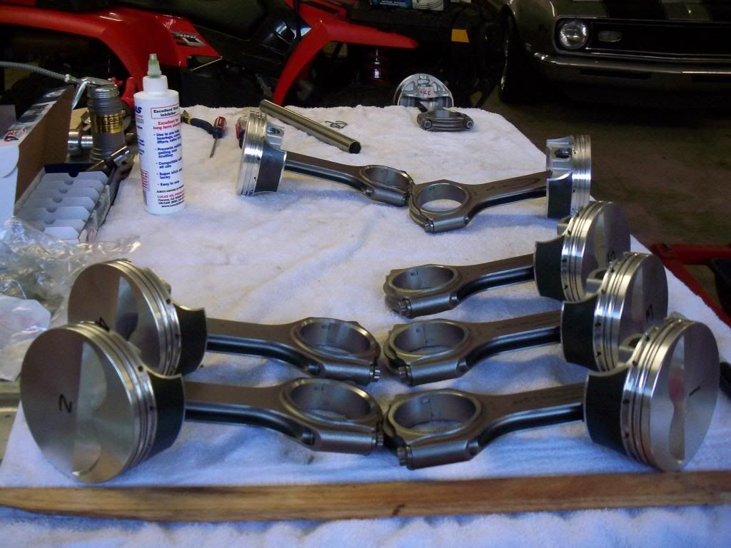

I recently built an engine for my '71 Corvette. Used SRP pistons (made by JE).
The answer I got from the machine shop was "You just gotta find the method that works for you".
I put a circlip in one side of the piston, past the groove. Used a small screwdriver to rotate it close to correct orientation. Inserted wrist pin into far side of the piston, and pushed. The action would finish squaring up the circlip, which then popped into the groove.
The second circlip was a bit trickier. I would start a circlip into the bore, with one "end" of the circlip sticking out. We got a piece of some heavy walled SS pipe that was slightly less than the wrist pin bore's diameter, and about 12-14" long. We cut a notch crossways in one end of the pipe, kinda like cutting a wedge out of the pipe. Filed a face on the inside to increase contact area with the circlip. With the notch positioned on the free end of the circlip. I could rotate the pipe, which compressed the circlip, and pushed in on the pipe to install the circlip in the groove.
After the first two, I had the timing down on the motion, and assembled the rest of the pistons with relative ease. So it kinda ended up like the machinist said...we found the method that worked for us.
I don't have a good photo of the hunk of pipe, but you can see it in the pic below on the bench:
Hope this might help someone!
