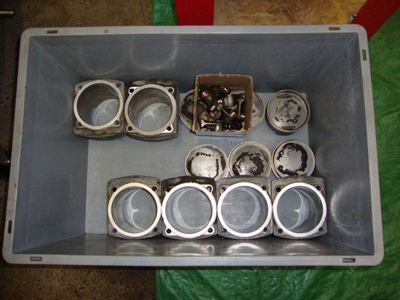

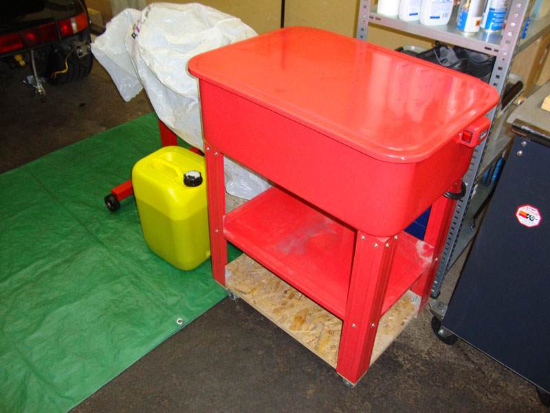

Before ordering: all parts were cleaned and measured.
Then i created a list of all required parts

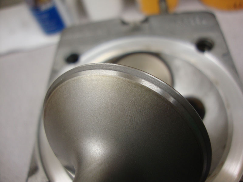

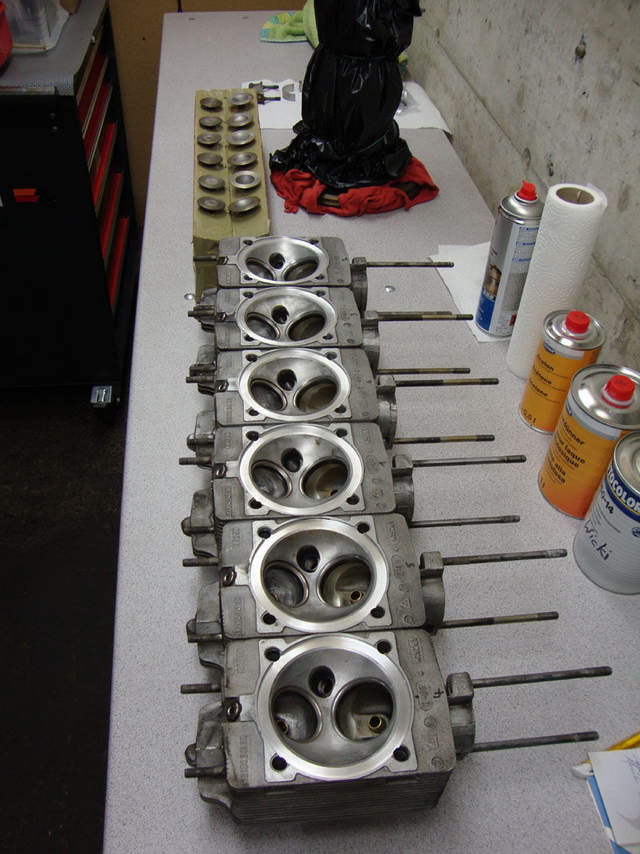

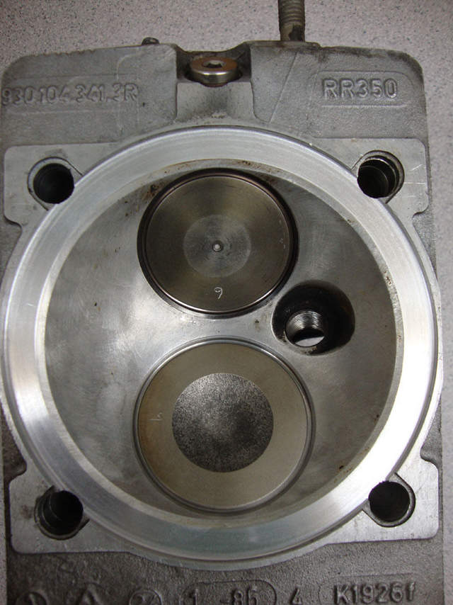

The Mahle P/C and the Rocker arms went to the workshop for replacing the exhaust valve guides / new bushings / overhauling
Many covers went for powder coating.

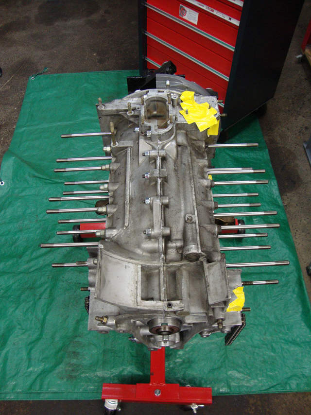

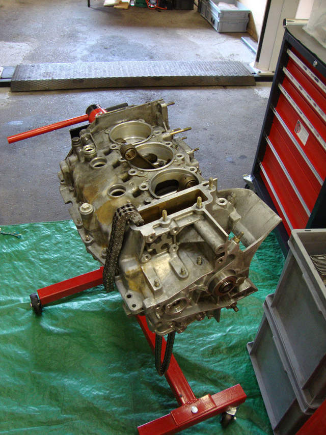

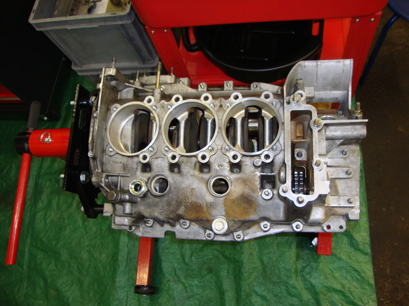

After my order I started with the modification of the Crankcase
87 930 3.4, BW EFR 7670, TK Long Neck IC, Fabspeed Headers, 964 NW`s, Ported Heads, Tial F46 (0.4Bar Spring), Turbosmart EBC, BL WUR with rpm switch /solenoid, SDS CPI Ignition, modified Muffler, and many other little mods

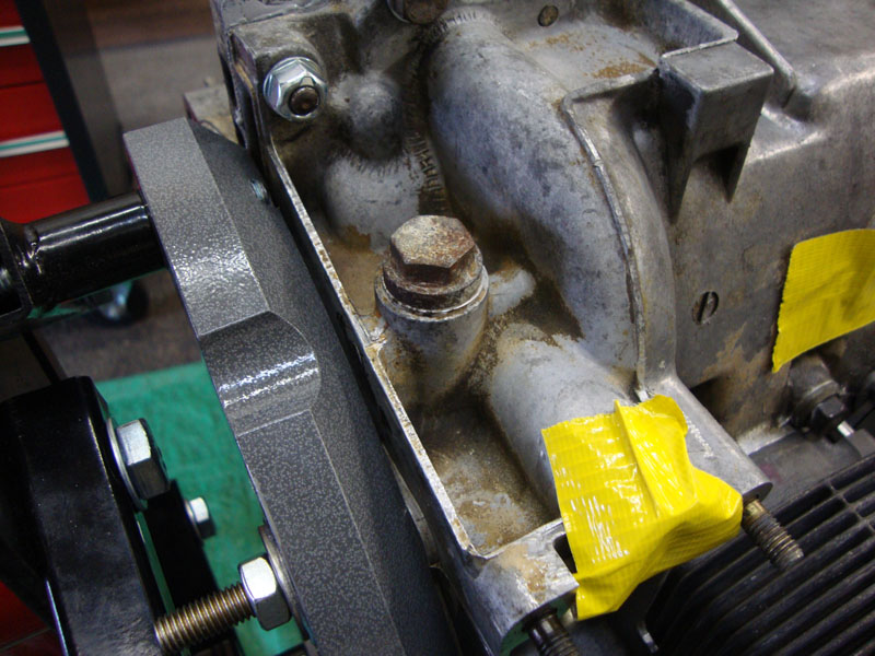

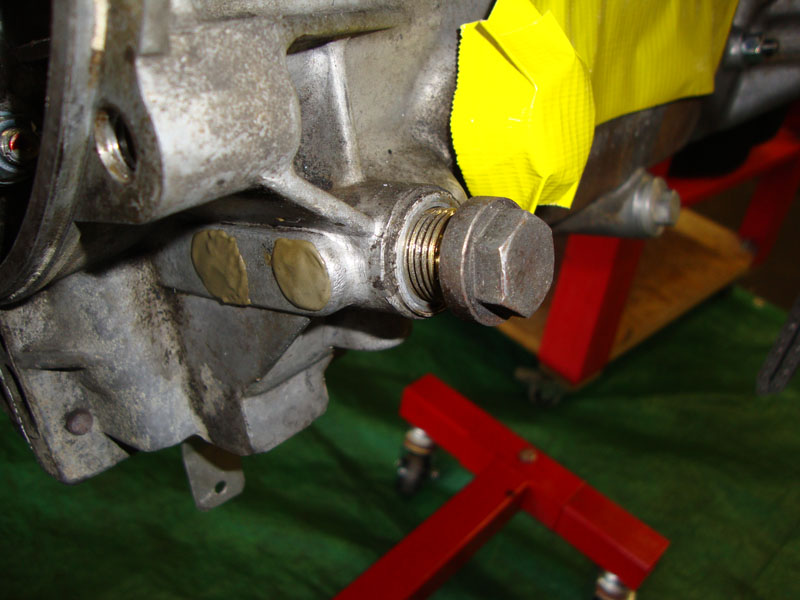

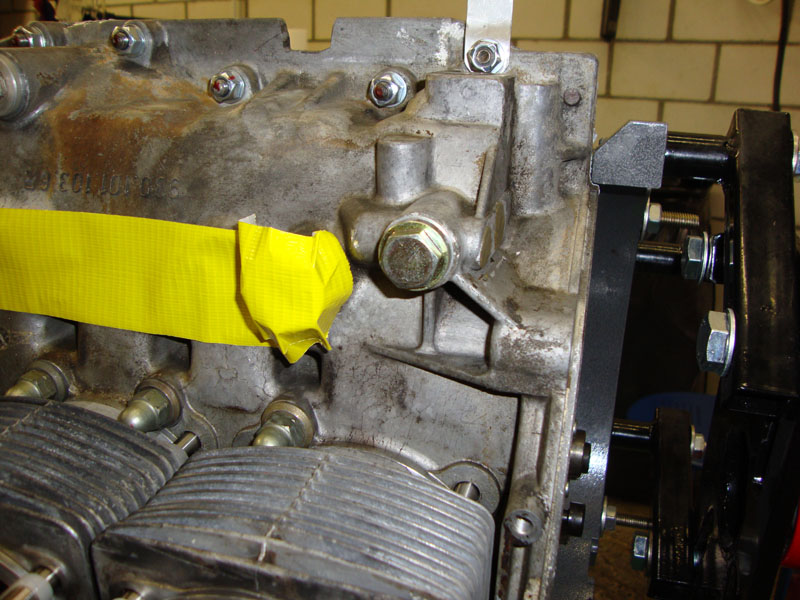

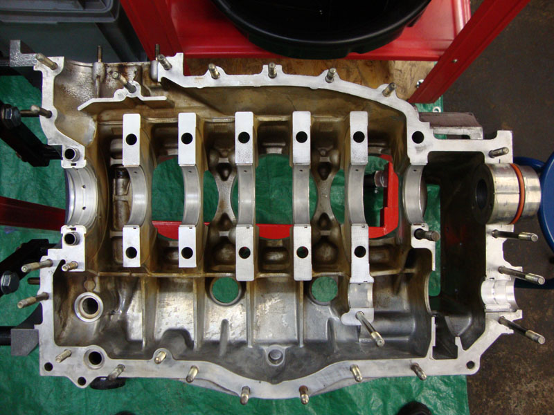

Crankcase Modification
many hours of work and lots of sweat

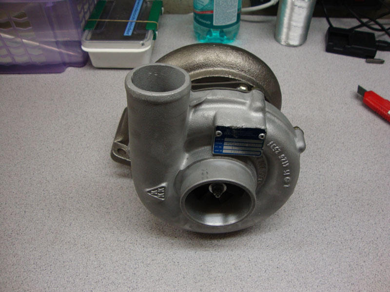

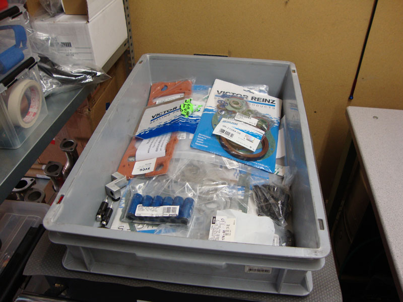

Some New Parts
So here are a few pictures of my ordered parts:

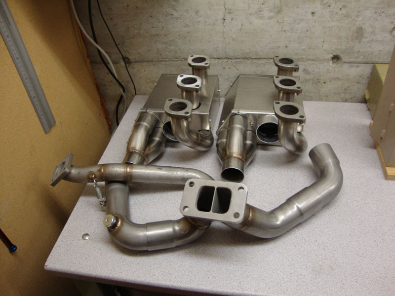

From Chris Turbokraft:
Brian Rarly8: Headers and K27/29

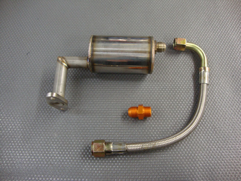

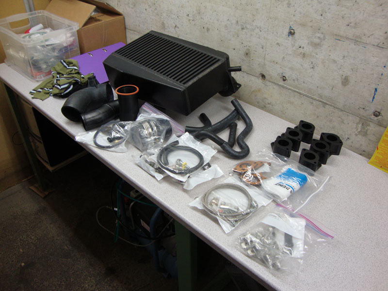

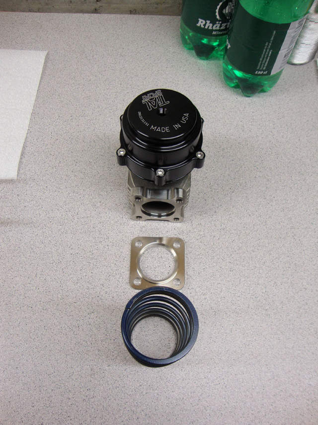

More
Patrick Motorsport:
Tial Wastegate F46 with 0.4 Bar Spring and optional 1 Bar Spring:
Oil Drip Tank from GSF:

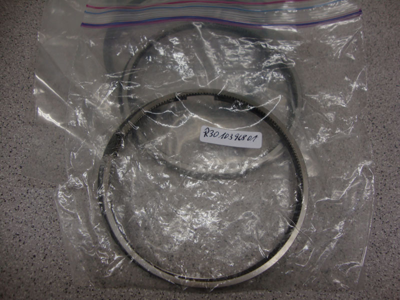

Ruf Germany Piston Rings complet Set:

Some Parts back from Workshop
Mahle P/C and the Rocker arms are back from replacing the exhaust valve guides / new bushings / overhauling

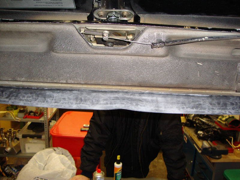

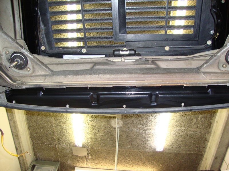

New Rubber and fresh powder coated Sheet Metal

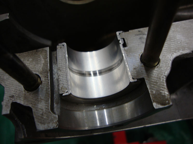

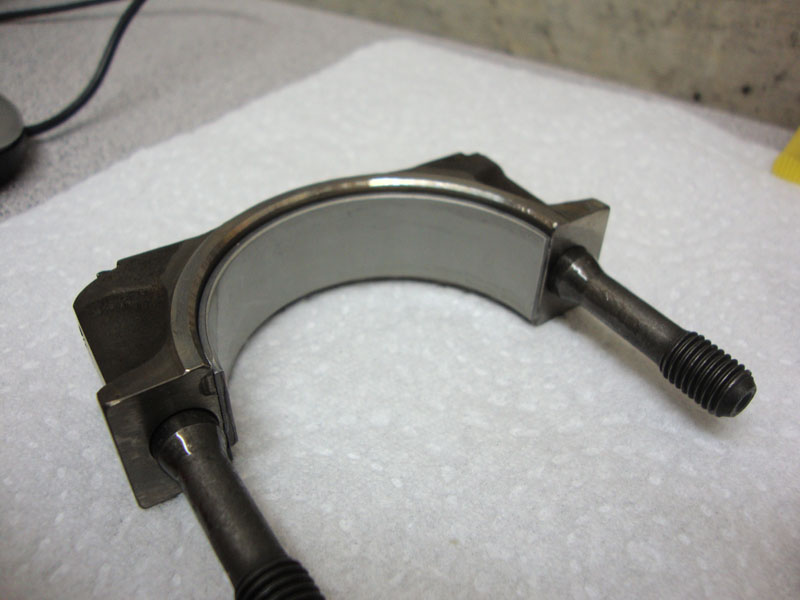

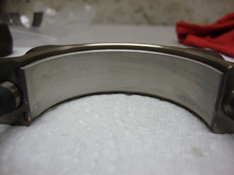

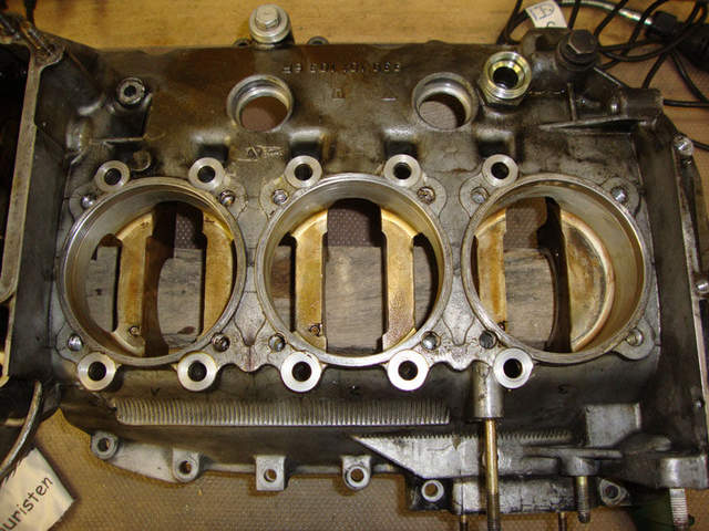

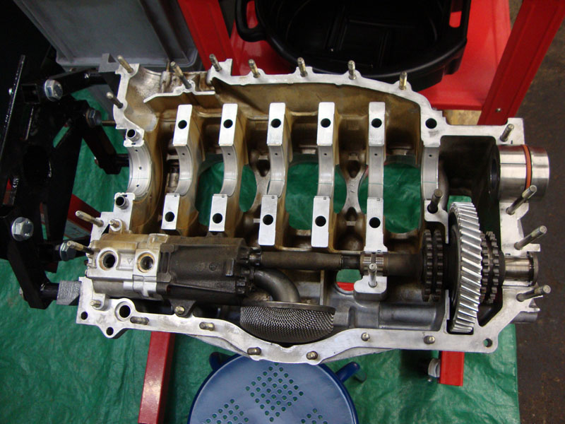

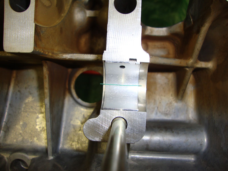

Check Bearing Clearance Connecting Rods and Crankshaft
Old 07-26-2014, 12:49 PM
930/66's Avatar
Join Date: Sep 2011
Location: Switzerland

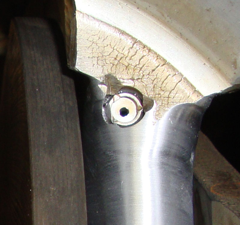

Posts: 307

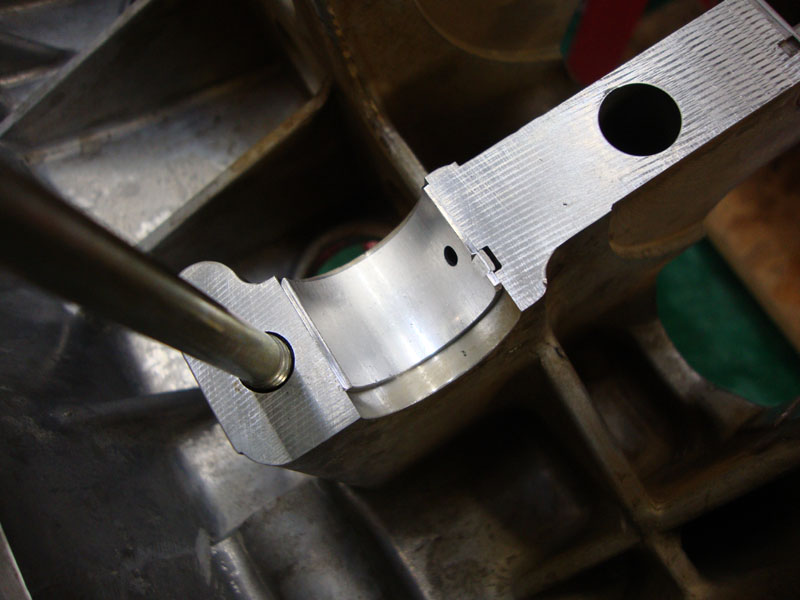

Crankcase / Crankshaft / Intermedia Shaft Clearance Check

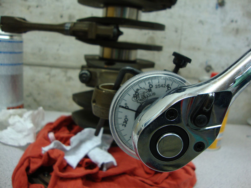

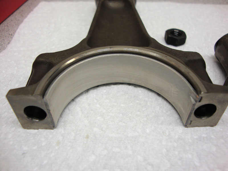

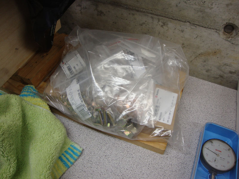

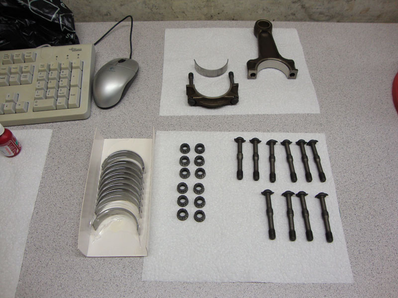

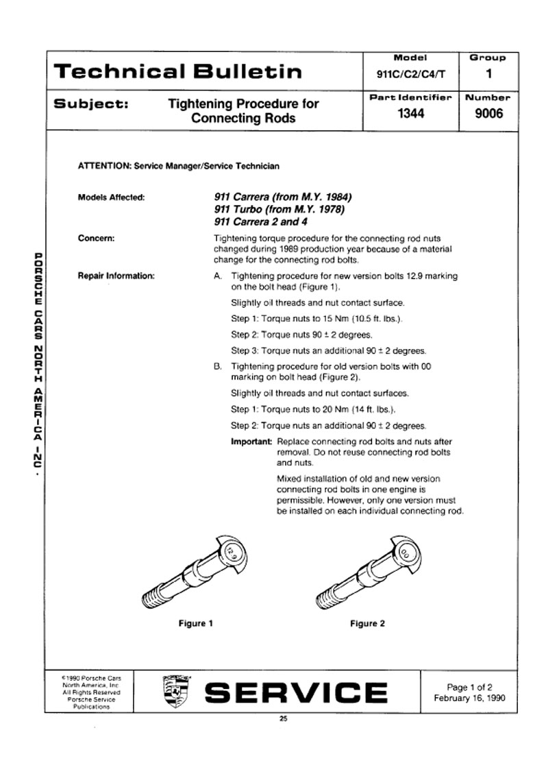

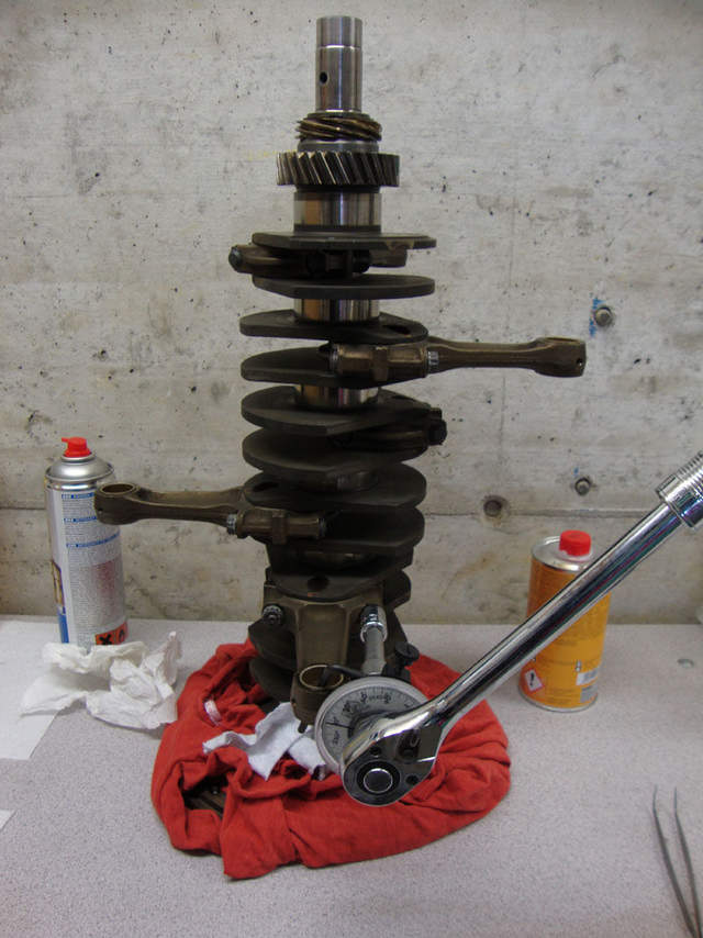

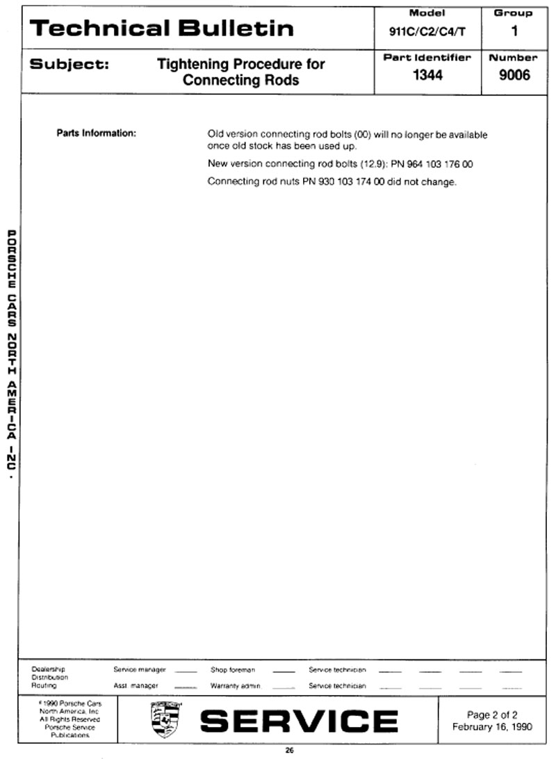

Assembling Connecting Rods on Crankshaft
After cleaning, cleaning, cleaning i mount the new bearing shells with assembly grease (Oil additive).
I have order some OEM Rod Bolds and nuts by pelican
with this numbers:
Connecting Rod Bold: 964-103-176-00-M260
Connecting Rod Nut: 993-103-174-02-M260
I take all Specs for Tightening Torques from my original Repair Manuals.
I'm doing this report after the car actually already running.
I have torque my Connecting Bolds with the "old Specs"
1. 20NM
2. 90°
A Friend and Member from here (Roland / Proffighter)
give me and a Friend this Bulletin I was shocked.
With the now from the Bulletin is this wrong....
1. 15NM
2. 90°
3. 90°
are write with the 12.9 marked Bold
All engine builders we asked seem to make the same Mistake there all had a question mark on her face.
here are the Porsche Bulletin from 1990!

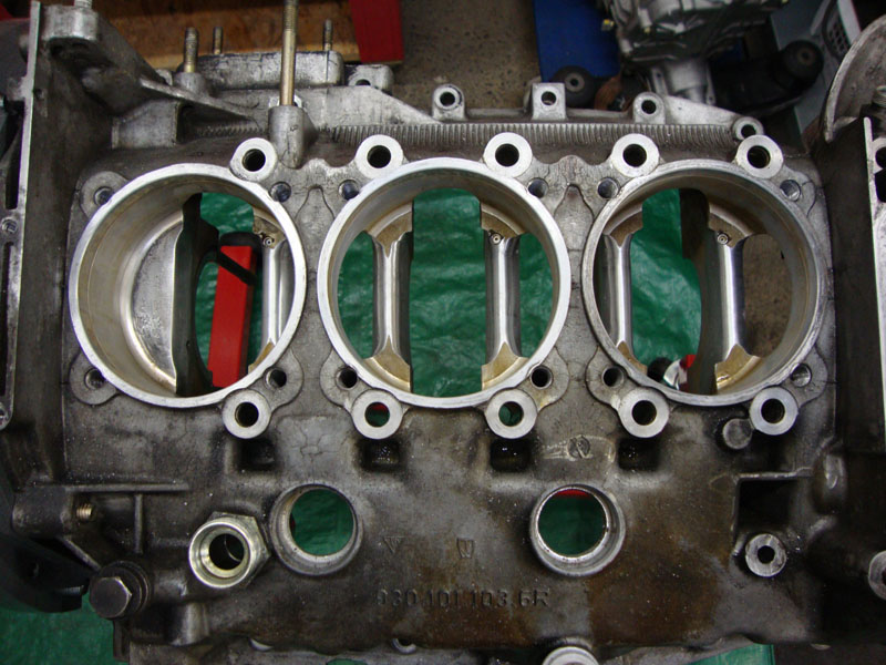

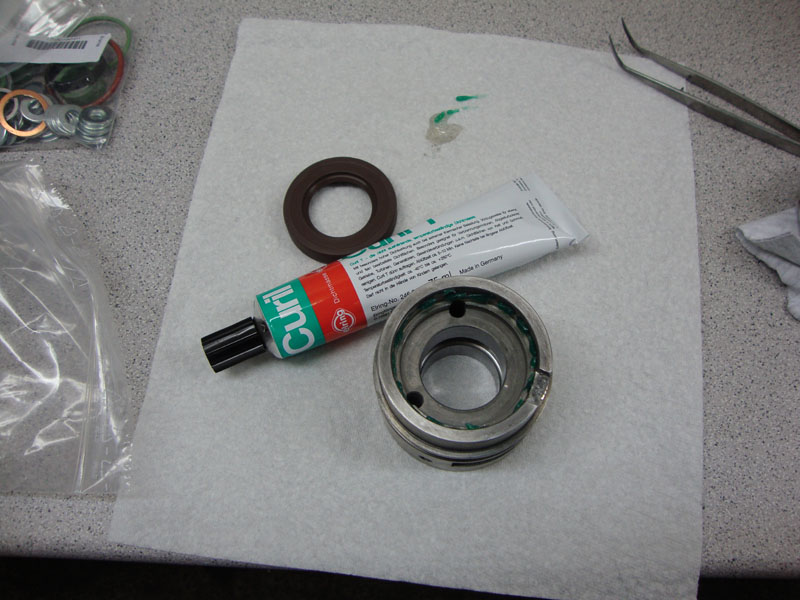

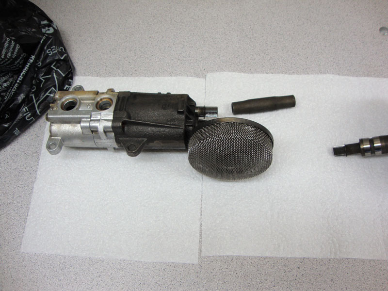

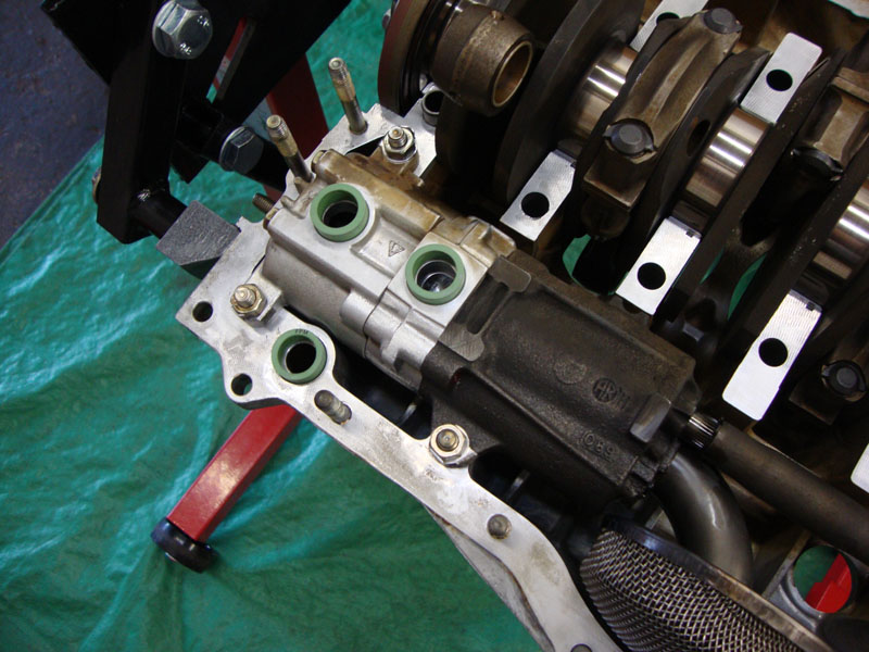

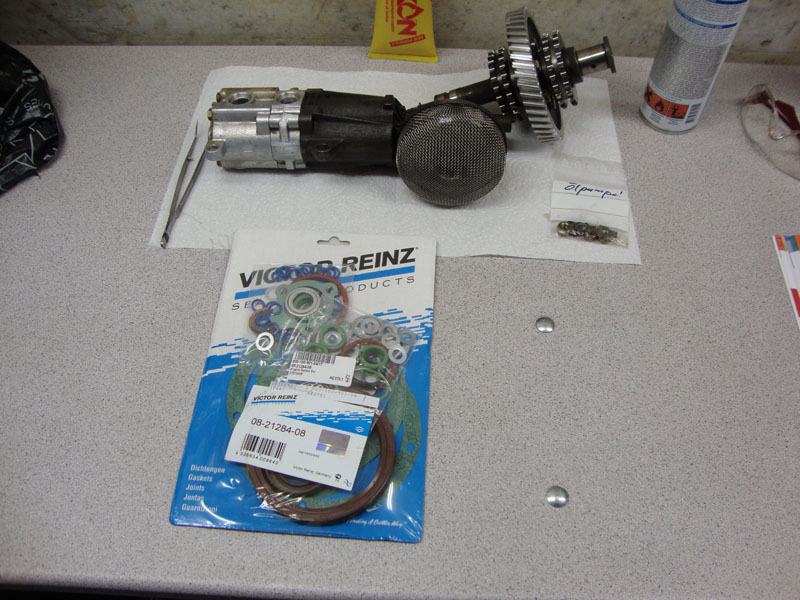

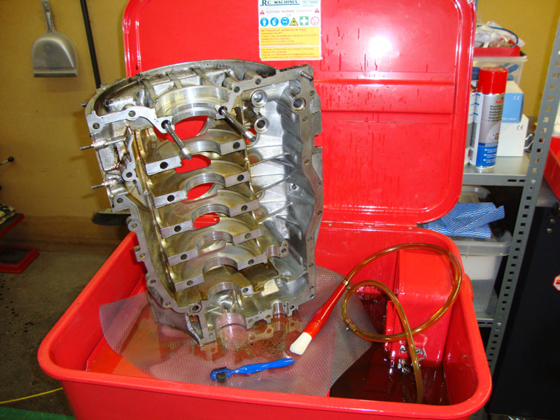

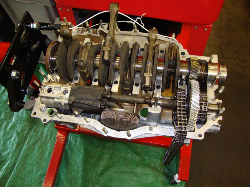

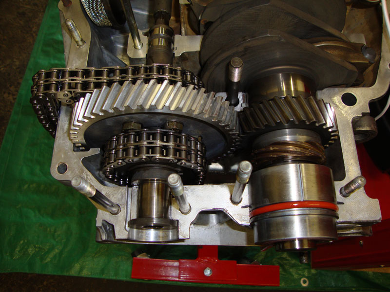

Cleaning Crankcase / Crankshaft / Intermedia Shaft / Oil Pump befor Assembling
Cleaning and Checking Spray Valve with Air (ejection pattern)
sealing Nr 8 with CurilT (Sealing Kit from Supertec)
I have sealing all with the instruction sheet from Supertec
Old 07-27-2014, 04:50 AM
930/66's Avatar
Join Date: Sep 2011
Posts: 307

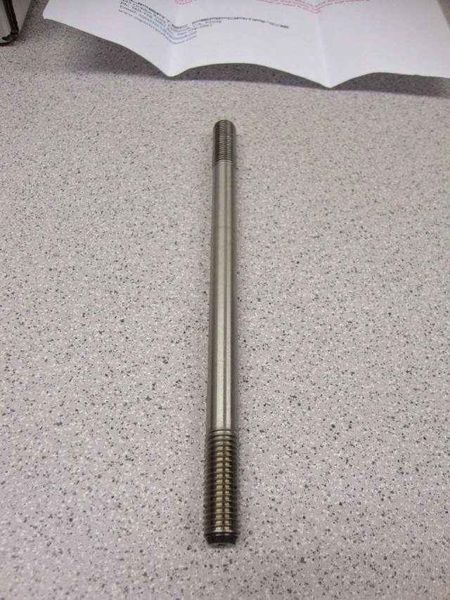

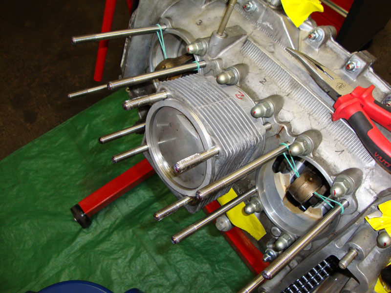

Mounting Supertec Head Studs
Before i have assembling the Crankcase I have cleaned every Thread.
The Material of Supertec I have ordered from Pelican Parts.

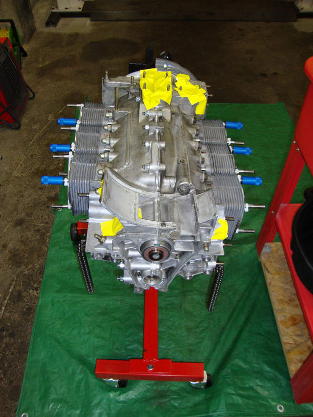

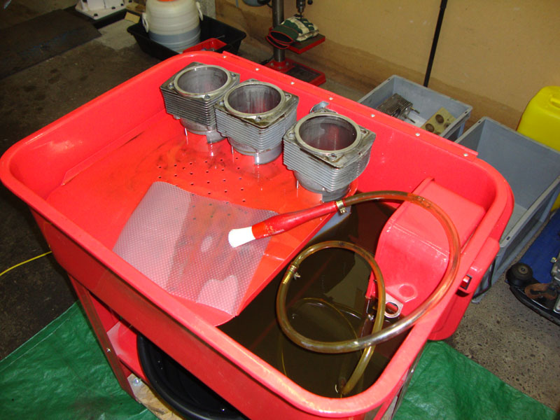

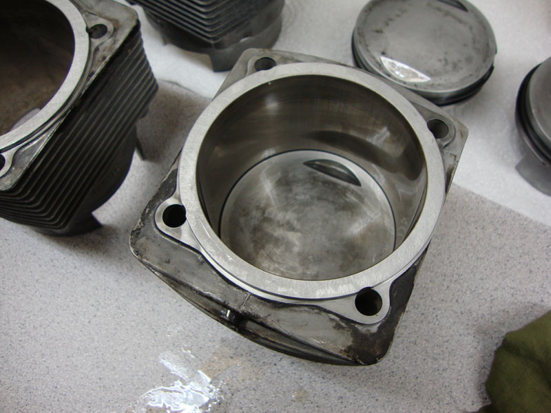

P/C Mahle 3.4 Prepare fror Installation
Cleaning:
New Piston Rings from Ruf:
Piston Ring Compressor
Install Piston Pin:
New Cylinder Base Gasket and Stromski Racing Holding Tool

P/C Mahle 3.4 Prepare for Installation
Cleaning:
Install Piston Pin:

Assembling Mahle P&C 3.4 L

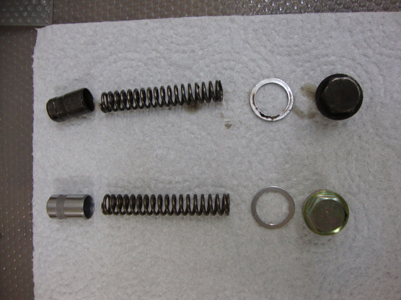

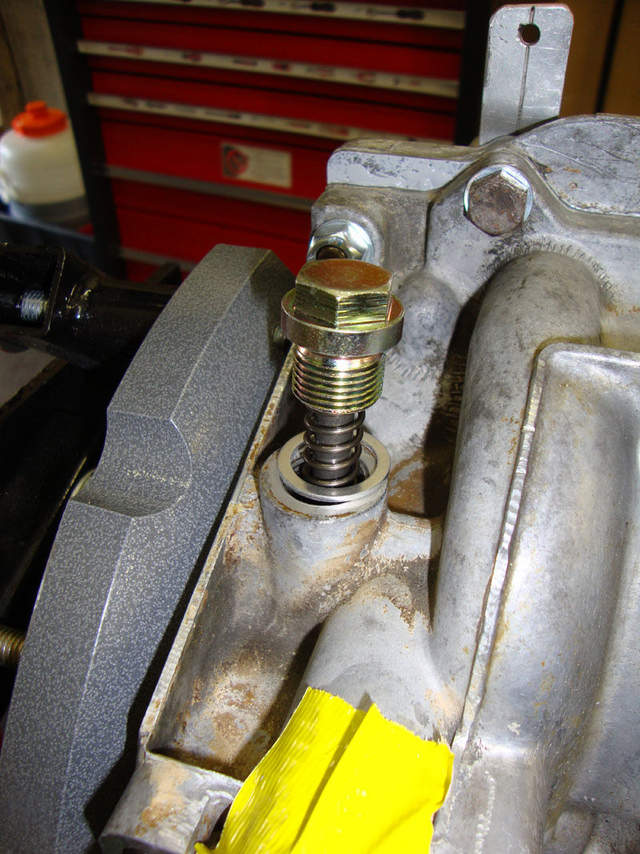

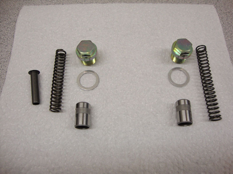

Change Pressure Relief and Safety Valve against New

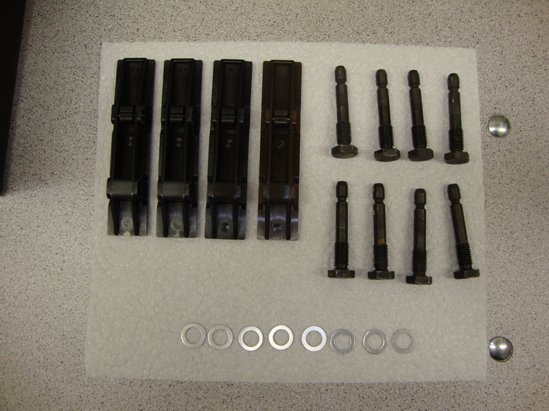

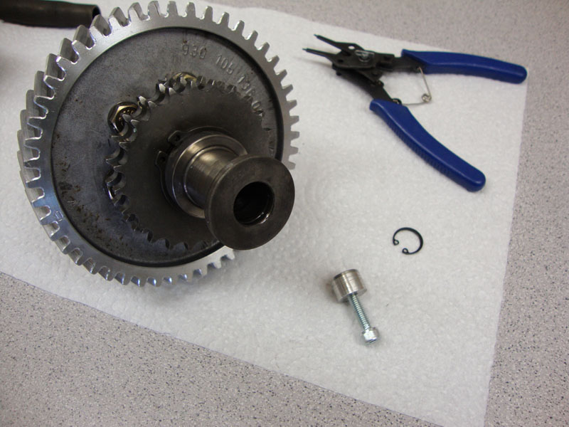

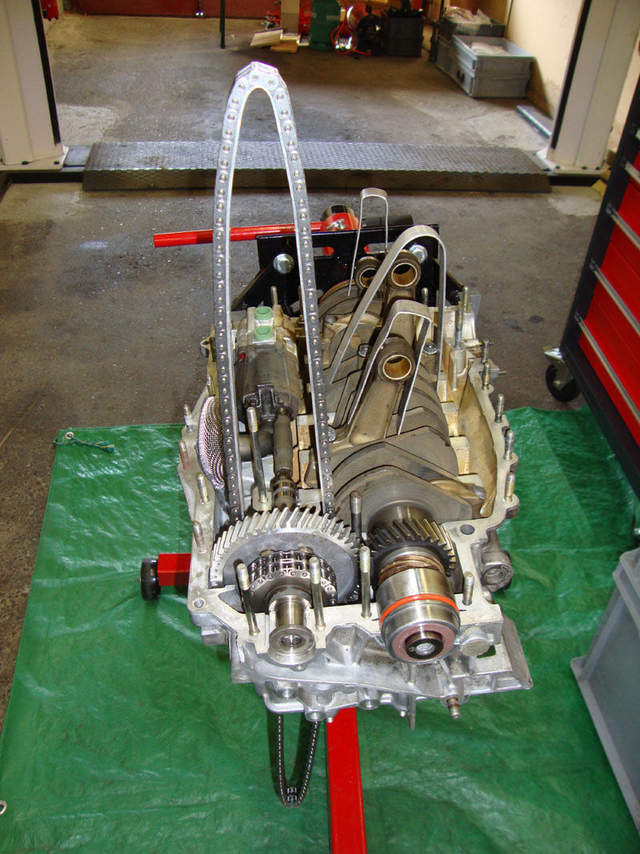

Assembling New Chain Guide Rail
New Chain and Guide Rails:
