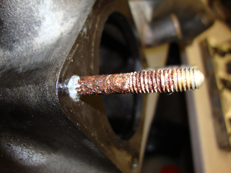

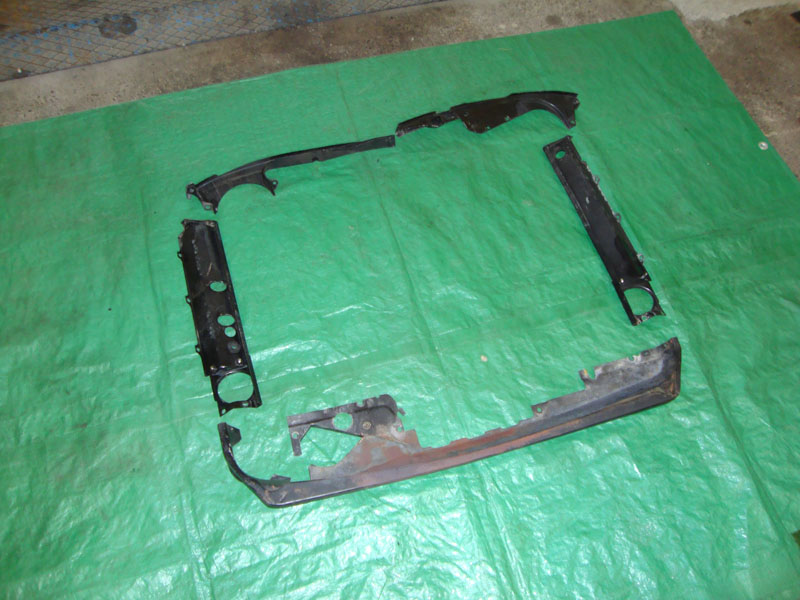

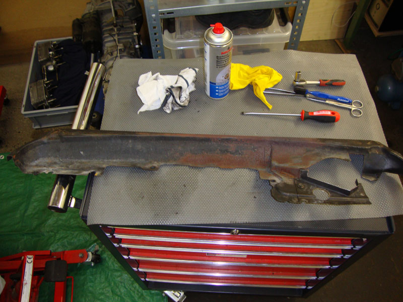

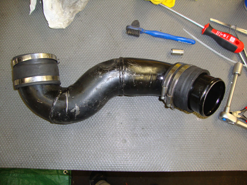

Preparing Parts for Powder Coating
many of the parts are rusty and some rubber sealing are broken

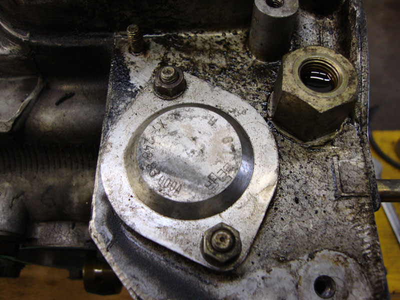

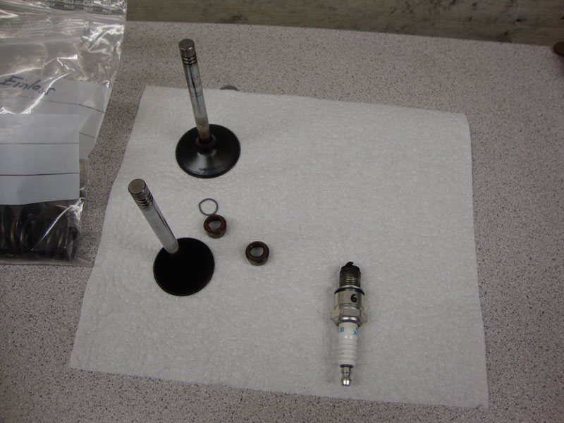

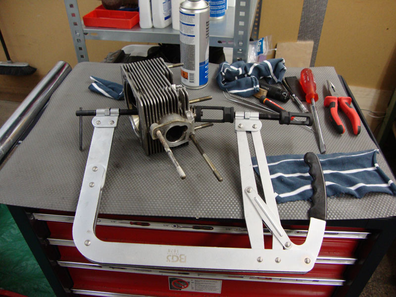

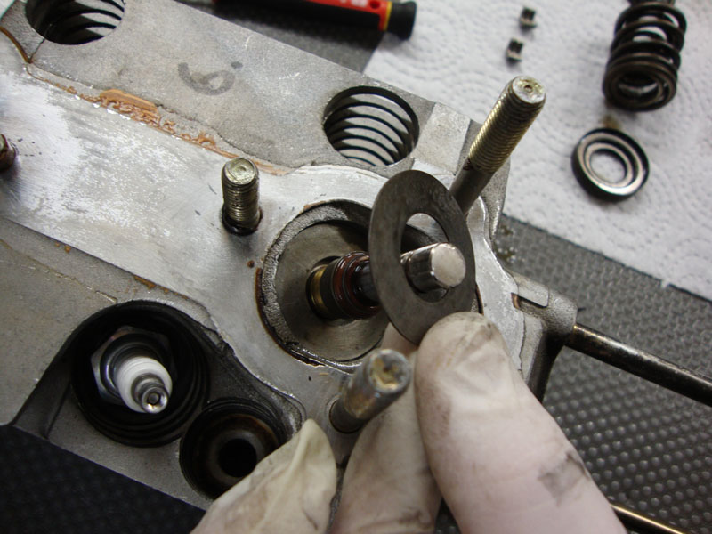

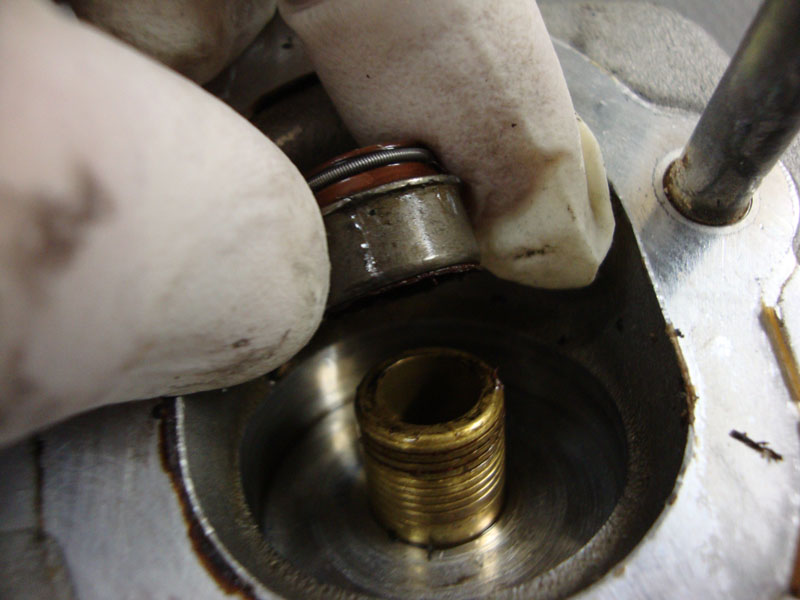

Disassembling Cylider Heads for Porting and Replacing Valve Guides
87 930 3.4, BW EFR 7670, TK Long Neck IC, Fabspeed Headers, 964 NW`s, Ported Heads, Tial F46 (0.4Bar Spring), Turbosmart EBC, BL WUR with rpm switch /solenoid, SDS CPI Ignition, modified Muffler, and many other little mods

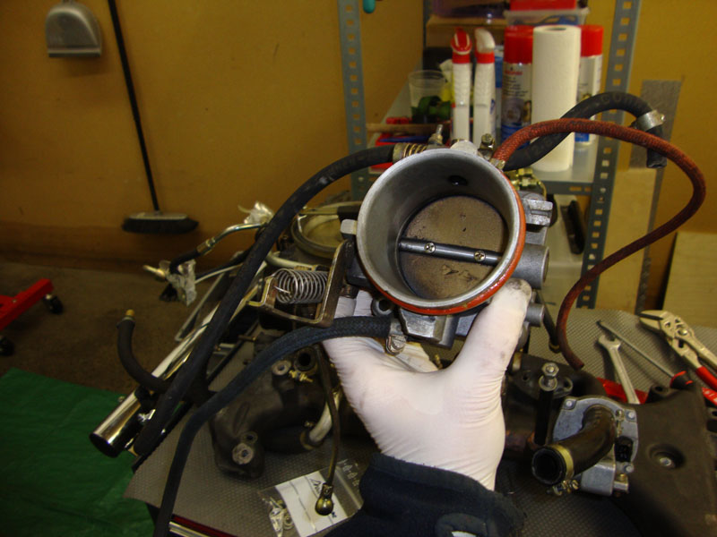

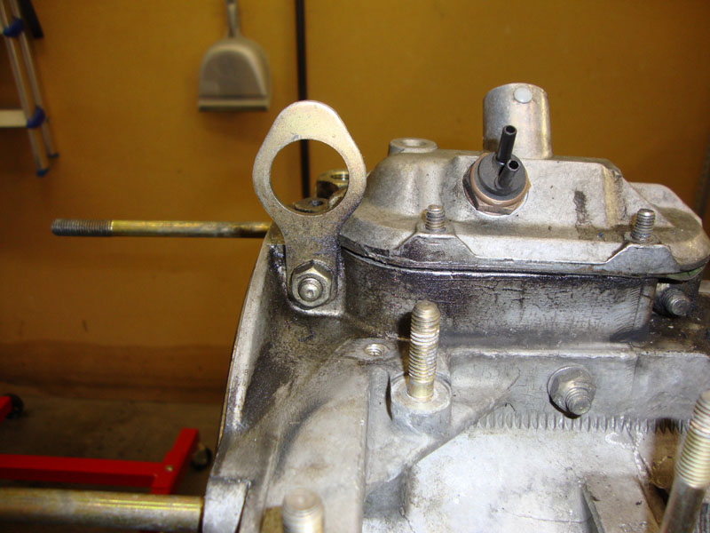

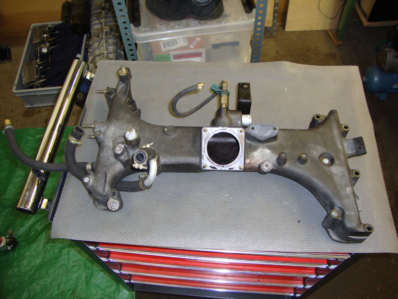

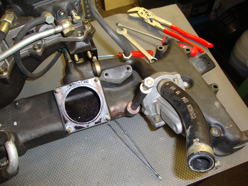

Disassembling Intake Manifold
looks bad

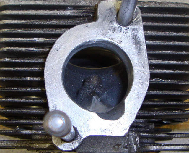

Posts: 307

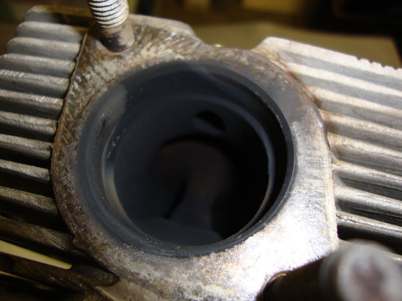

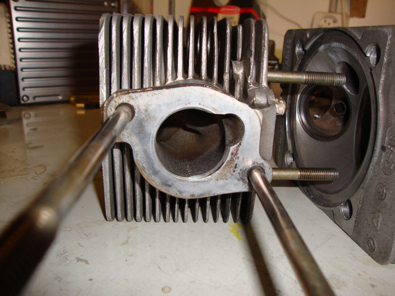

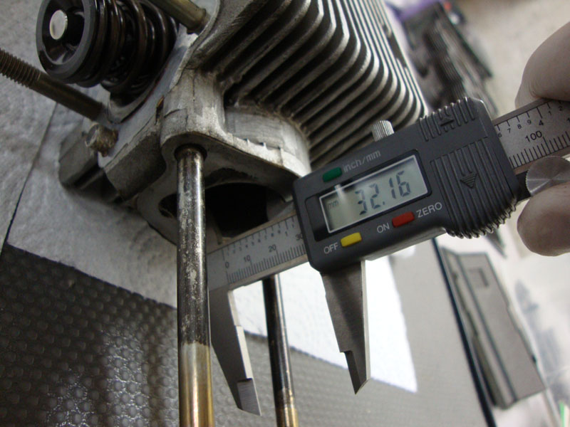

Porting Cylinder Heads
before i bring the cylinder heads to the shop (for replacing the valve guides) i porting the Heads myself.
Intake to 36mm
Exhaust to 38mm

Intake 32 to 36mm

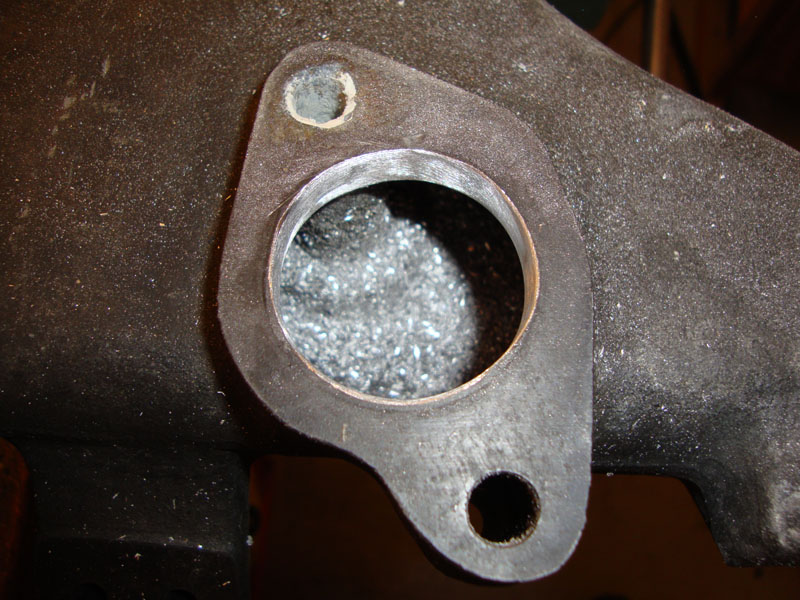

Exhaust to 38mm

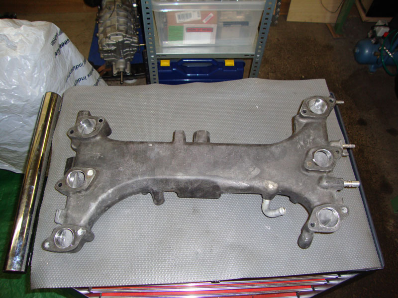

Posts: 307
Intake Manifold ported to 36mm
all with a milling cutter

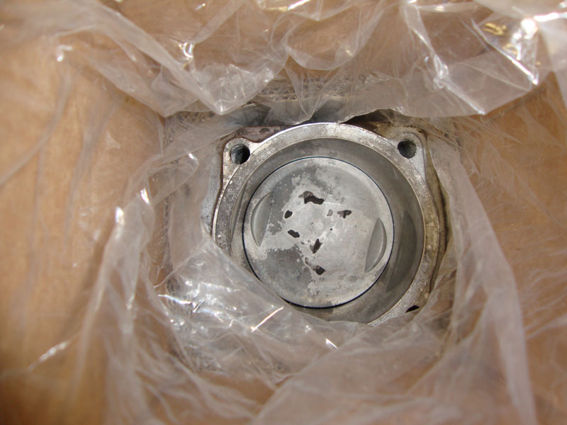

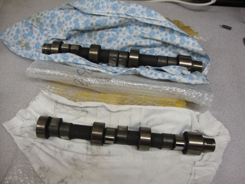

Some Parts have arrived by Post
I have many parts from Pelikan Members...Thank You!!!
The Mahle 3.4L full finned Pistons and Cylinders (used) come from tomdeq he converted his 930 back to stock.
The Camshafts 964 with no wear / pitting are from Anastasios also used Parts.

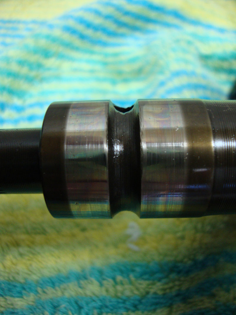

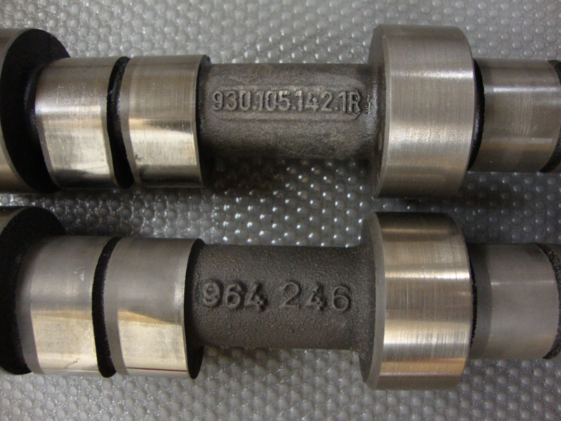

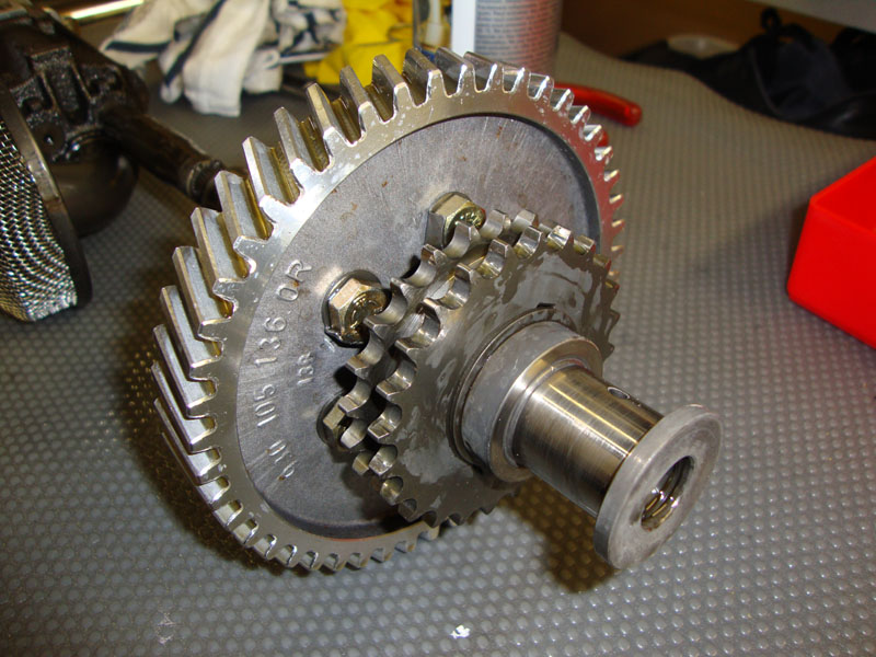

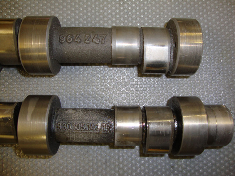

964 Camshaft
I had to modify the camshaft for the 930.
left: extender for scavenge pump
right: remove power steering pump adapter

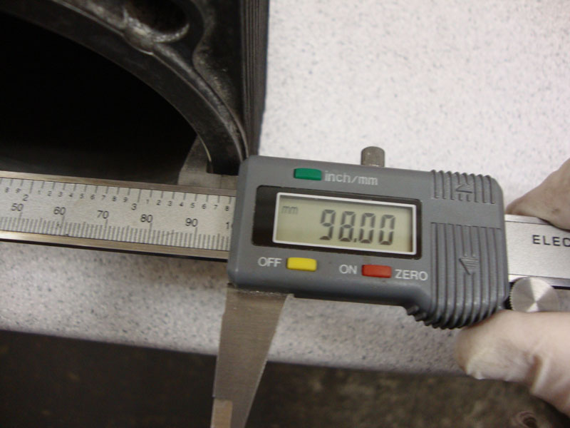

Posts: 307

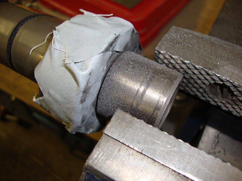

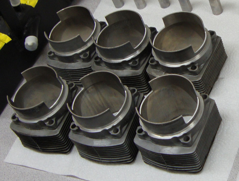

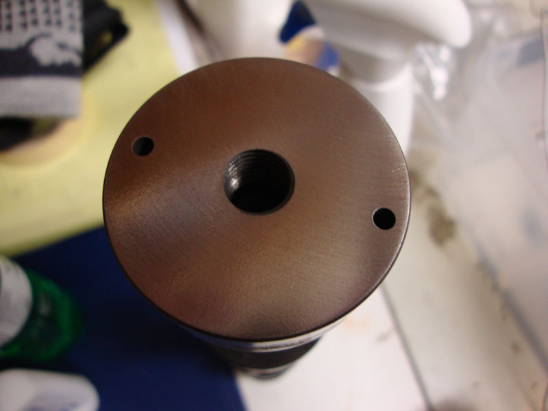

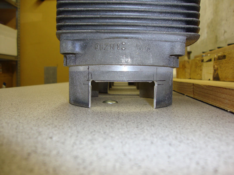

P/C Mahle 3.4 7:5:1
general condition is good
2 piston rings and 1 oil scraper ring were broken, it was not easy to get new one`s.
there are 2 different versions of the 3.4 liter set.
only RUF in Germany had new one.
I modified the cylinder (old school know how)

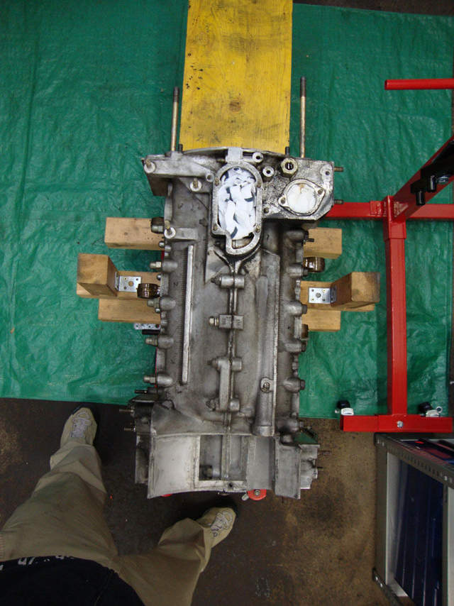

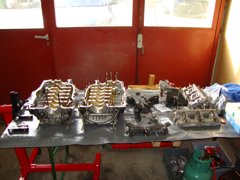

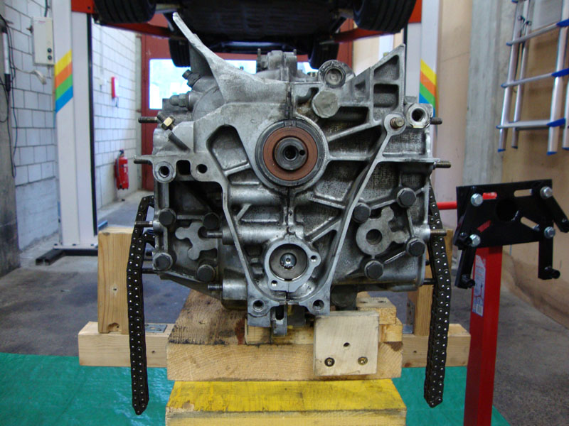

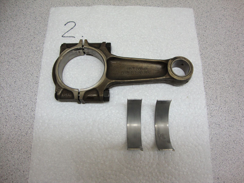

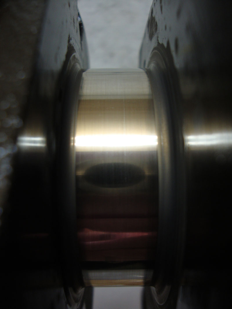

Splitting the Crankcase
Old 07-21-2014, 12:27 PM
930/66's Avatar
Join Date: Sep 2011
Location: Switzerland

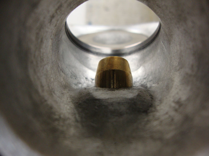

Posts: 307

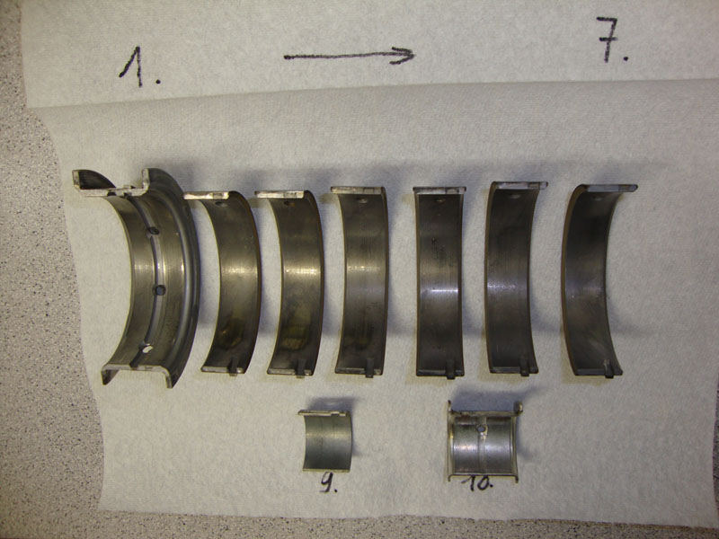

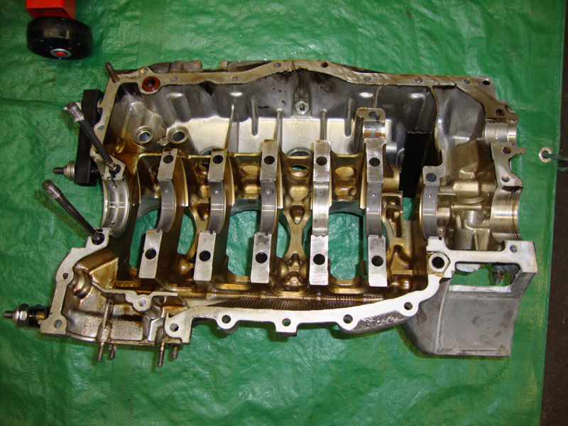

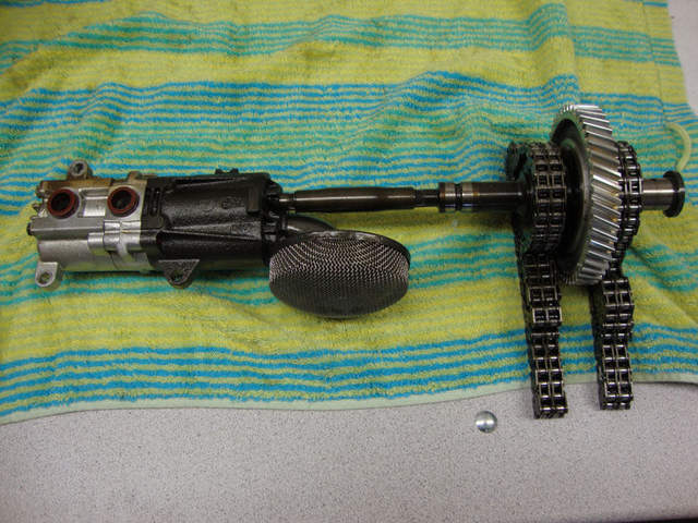

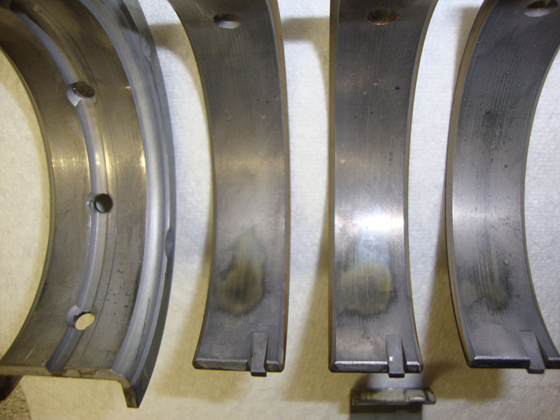

Bearing Shell Main Bearings / Intermedia Shaft
Looks not to bad:

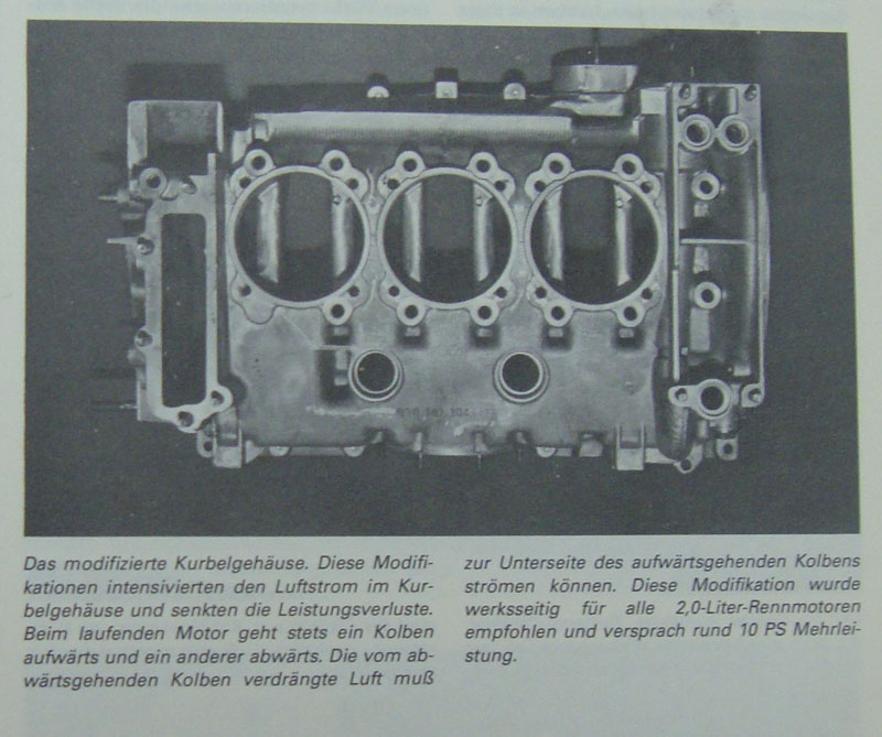

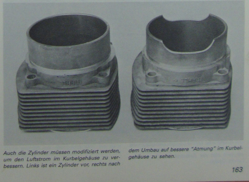

Please tell why you made the cut-outs in the cylinders.
I know why we did it on two-stroke engines, but gather this is not the same.
Jesper
Carrera 3.0 1975
930 1978 OEM Matte Schwartz, ANDIAL IC, BL WUR, SC cams. LMA-3 w. XD-16 and CP transducer
www.stauningwhisky.dk
Old 07-21-2014, 10:01 PM
proffighter's Avatar
Join Date: Aug 2007
Posts: 2,397
That's a classic tuning procedure (boattailing) to relieve gas exchange or breathing between the cylinders and the crankcase (volume below the piston). According Bruce Anderson 10 more hp for a 2 liter engine. This needs also machining the crankcase like this which correspond (red) to the slots in the cylinders:
I do not have seen any dyno to proof, but because I don't see any downside except the work it's worth a try
Thank you Roland for the illustration!
I have picture from the Bruce Anderson Book (German Version from Roland)
This modification was made at all the factory 2 liter racing engines.

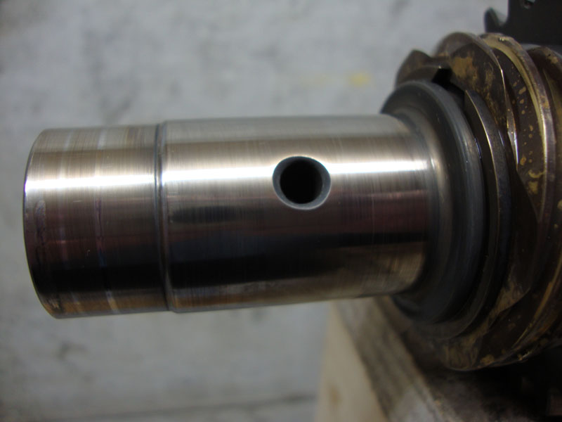

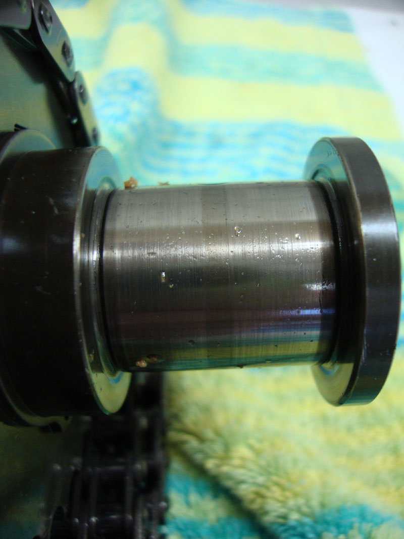

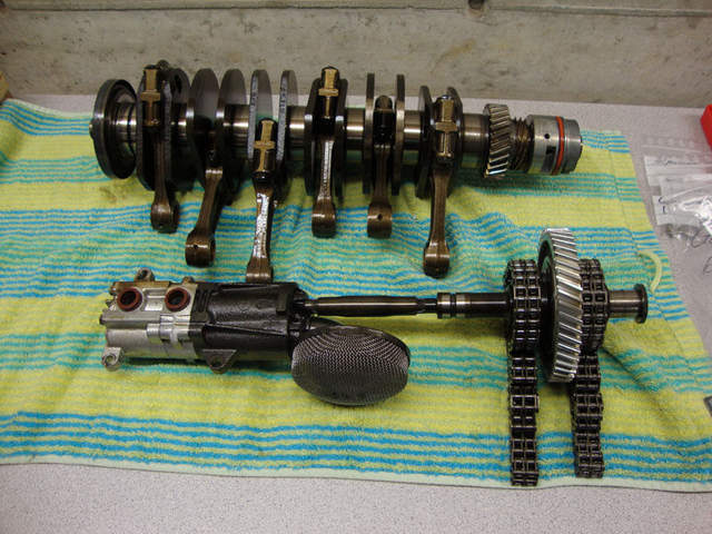

Disassembling Crankshaft
The bearings and surfaces are in good condition.
