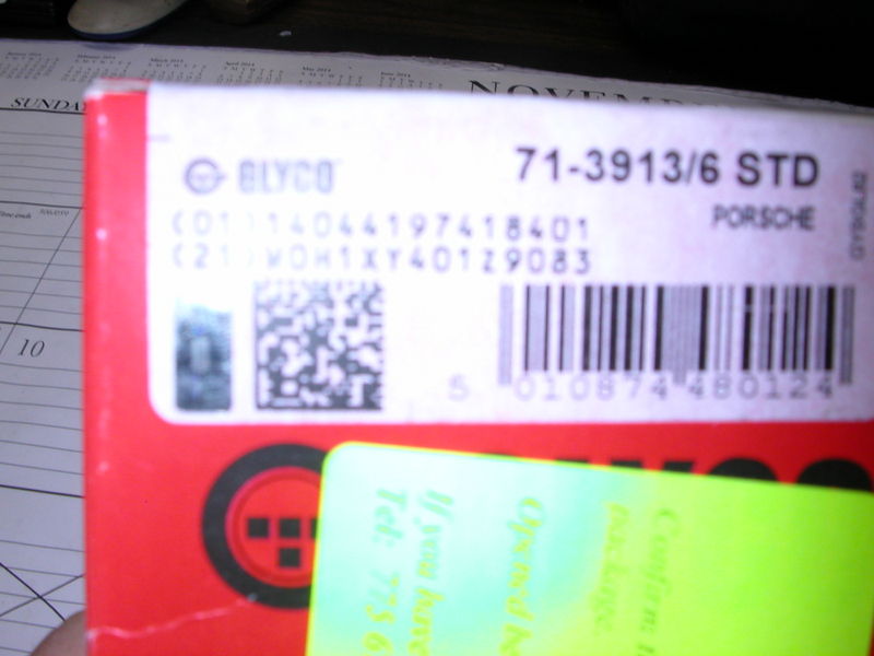

Interesting read. I usually build several motors every year and I have noticed the quality of Glyco bearings have gone down hill, but I have not yet had motor fail due to a bearing issue. A couple years ago I noticed that bearing tolerances on some bearings were too tight. Now it seems like they are too loose. But the reason I ended up on this thread is because of some bearings for a 996 motor I'm rebuilding. These bearings (Glyco #71-3913 996.103.121.81) not only measured at twice the clearance I was expecting, they are also simply 1/8 inch too wide. No question they would have self destructed instantly since they were practically hanging out the side of the rod. They are also .0007 thinner than the (old) stock bearing which is a total of .0014 extra clearance. But under further investigation they seem to be an exact replacement for a 3.0 rod bearing, give/take a couple 10 thousandths.

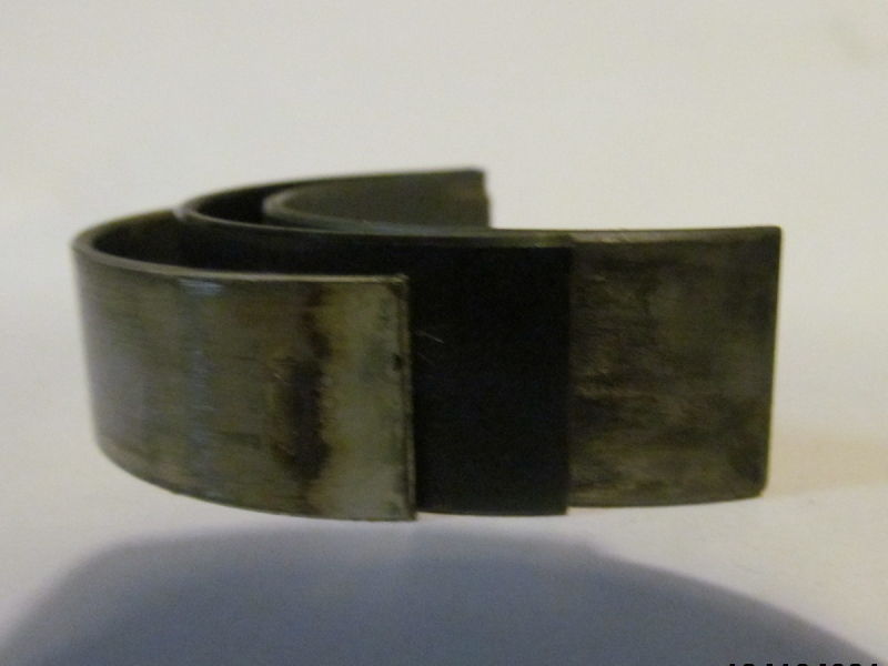

This is how the replacement bearings actually fit.
Original 996 bearing on left; replacement bearing n center. 3.0 bearing on right.

What 996 motor are you building? The GT3 996/997 bearings are dimensionally interchangeable with the older air-cooleds because the GT3 (and twin turbo) engine case/bottom end is based on the air cooled case. The run of the mill 996 engines are completely different in pretty much every way with no interchange of anything.

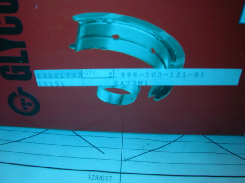

I just recieved my rod bearings for my 3.0 rebuild. They are Glyco with a part number of 996-103-121-81. Is the -81 bearing different from the -94? Thanks.

-81 is the "race" version. -94 is the std GT3 bearing shell

Kevin, whats the difference? Is the -81 ok to run in a street car? Thanks.

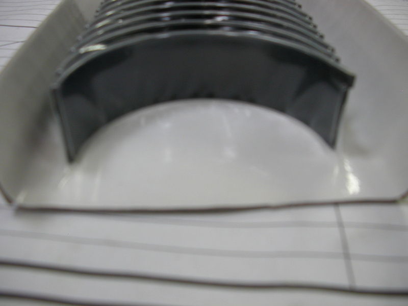

Haven't had the opportunity yet to handle the -81 shells. I suspect they allow for a teeny bit more of clearance. Can you post a picture? There were some comments I recalled from Mike Bruns awhile back that always stuck with me, as he builds high dollar engines and can't compromise.

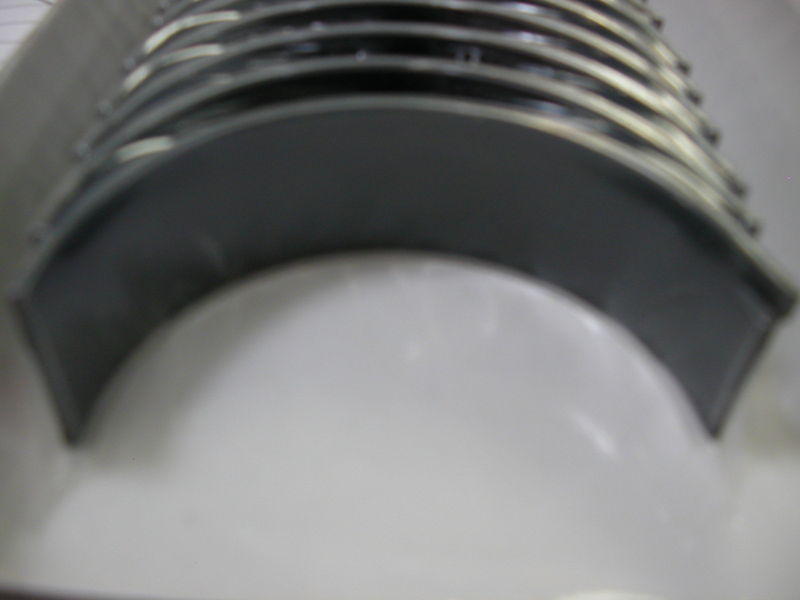

Kevin, here are some pics but they are lousy pics. Tried with both of my cameras with the same outcome. Let me know exactly what you are after and I will try again.

Mike,
I take back what I said about the -81 shells. I do have a set of them on the shelf. I got them from a guy selling them "cheap" for $100. They were in the same box as you show and same makeup of bearing- black bearing surface. Unfortunately I haven't had a chance to measure them. I was a bit disappointed in them when I received them (understatement) because they were just tossed in the box and that caused them to be all nicked up on the bearing surfaces.
I'll throw a couple of -94 shells in a rod (bolts stretched to spec) and do the same with the -81 shells to see what difference in size I measure with the bore gauge.
