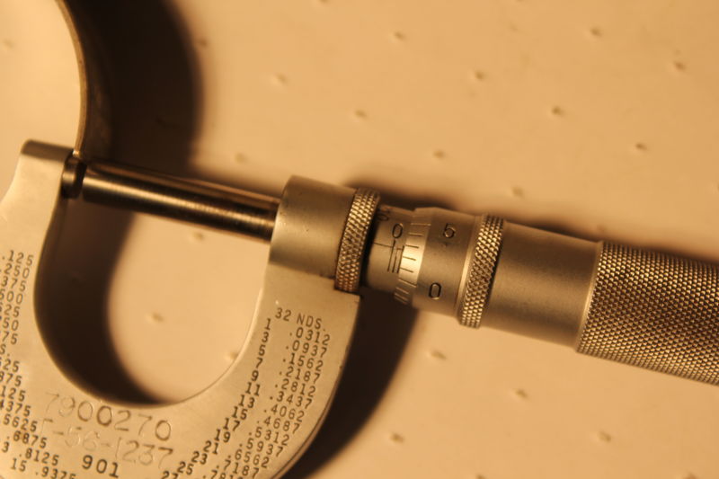

Having issues with Glyco rod bearings in 1990 964 3.6. Assembled rods to crank and several were way too tight, like zero clearance. Stock size polished crank, resized rods. I had no way to check id of rods, so I went back to machine shop to recheck. They checked them and verified them ok. Reassembled, still no clearance. Disassembled again and measured rod bearing shell and found this. Shell measured at edge to eliminate error from curve of bearing, one shell varied from 0.053 to greater than 0.064. Obviously not going to work. Is this the problem others have seen? What are alternate bearings? Returning them for exchange, but this is very worrying. My research is that rod bearings have eccentricity, ie they are not a consistent thickness all the way around, but they are thicker in the center, and have the most clearance at the parting line. Thickness varies in the .0005 to .001 range, certainly not 0.011. Very strange. I have measured the whole set and they have 0.005 difference from thickest to thinnest in the center of the bearing, 0.005 difference from thick to thin on the flat side(opposite the tang), 0.0035 difference on the tang side. Bearings have 05-14 date. Box says Made in S. Africa
Has anyone ever seen bearings vary this much?

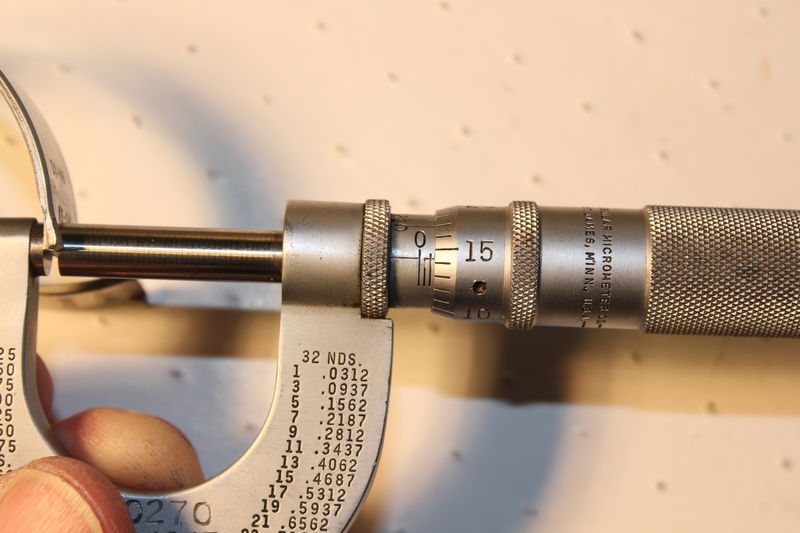

I am returning the above bearings. I have a set of Clevite's from AA on the way. Will measure the same way as I measured the these bearings and post the results. Should have them by the end of the week.
I can't find a spec on the Glyco's, but I guarantee it is not for a rod bearing to have a 0.011 step at the parting line, and that is exactly what I was getting. The largest measurements were mostly on the tang side and the smallest were on the other side.

With a little digging, I found a Clevite book that specified 0.0003 tolerance per bearing shell. These Glyco's have over 30 TIMES that amount.
Some of them have reverse eccentricity, where the shell is thicker at the parting line than at the middle. As far as I have been able to determine, there are absolutely no engines designed that way. There are only 3 shells out of the 12 that belong in an engine, and they are marginal. There is no possible way a bearing shell should vary in thickness 0.011 between it's own parting lines. How in the world did it make it through any sort of quality control?

Since this thread has come up again, the link below is real data(not "urban legend") that I measured using glyco rod bearings. No question they were defective. That said, the question becomes, where they an anomaly? The only answer is to measure everything.
Glyco vs clevite rod bearings - with data
