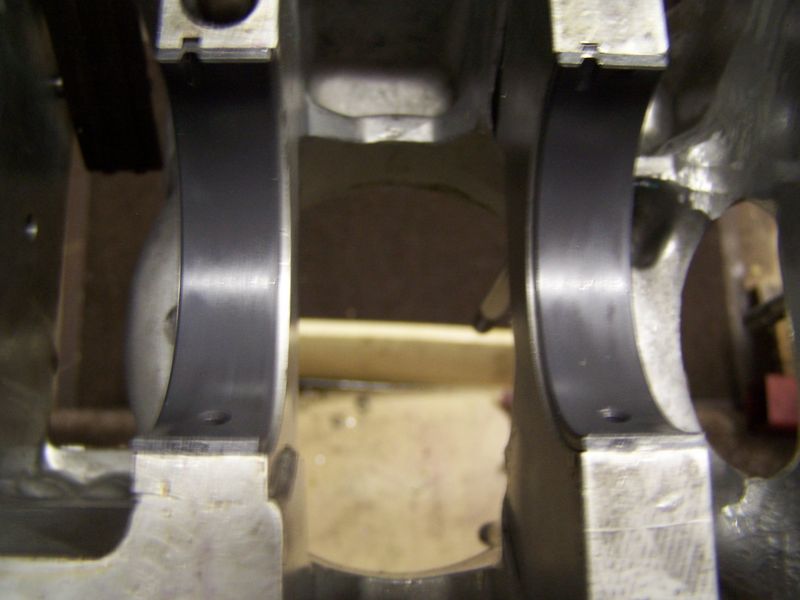

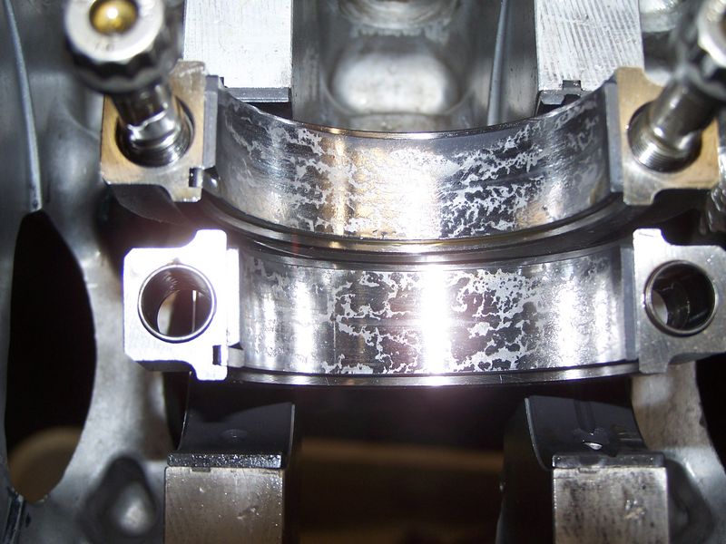

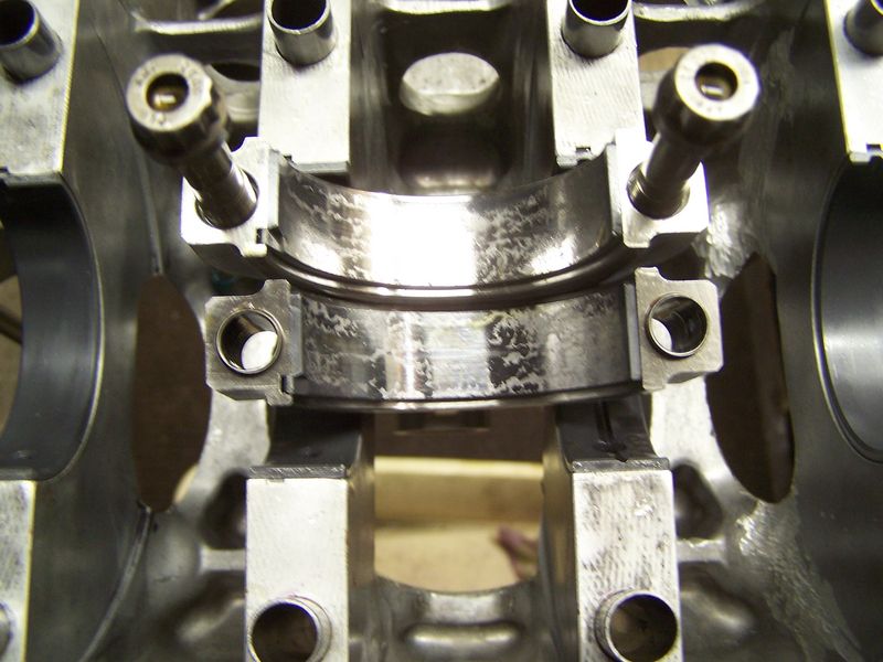

Here is what was wrong with my Glyco rod bearings, which had Calico coating on them. Compare to Glyco mains with the same coating. This is on a motor with maybe 2 hours, mostly chassis dyno.

Walt,
Have you determined if it was the coating or the bearing? From the pictures it looks like the coating didn't adhere to the bearing.

Naw, it was the bearing. Looking up bearing failure or the like on Google produced a site which showed a picture of fatigue failure or stress failure or the like. Looked just like this.
Some part of the substrate isn't up to the loads imposed. In my case that included 8,200 rpm on the dyno, but the engine with earlier production runs of Glycos (by maybe 8 years?) which was run to that had no issues (bearings good enough to make me regret the teardown). So it appears Glyco reformulated things for rod bearings which included a weaker layer in there somewhere.
Don't know if this would happen on a car not run beyond the stock rev limit (~6,500-7,000) of these early cars, or only occasionally run up that high (as in not raced).

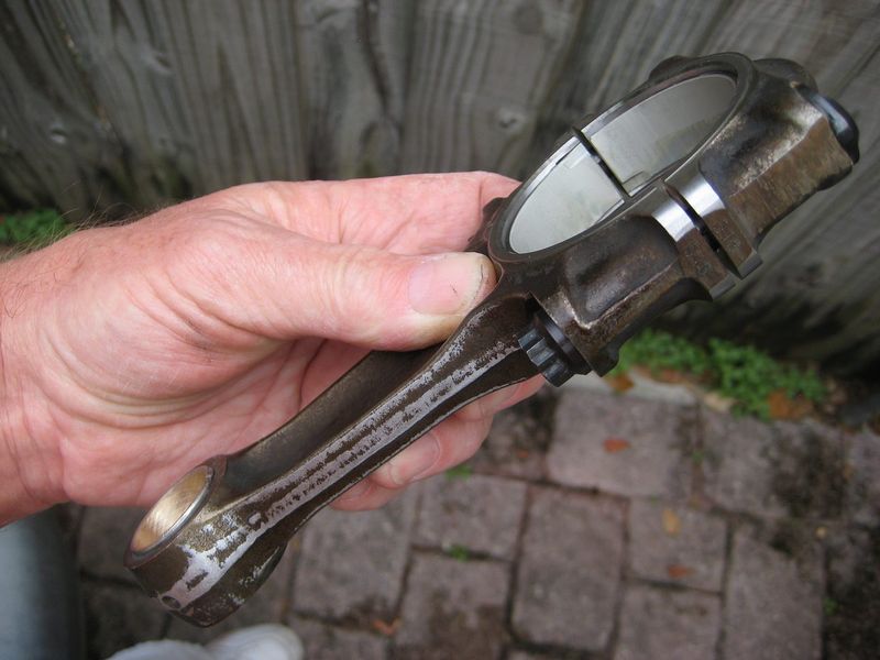

When I rebuilt the top end of mine 4 or 5 months ago I used Glyco rod bearings that were bought from Pelican around around 4 years ago. They were vacuum bagged in plastic on to a piece of white cardboard that was inside the box.
That protected them really well and they were in beautiful condition with no nicks or marks anywhere.
They are working perfectly in my '87 930 with excellent oil pressure and this is the only picture I have that shows a little bit of one of them.
I balanced all the rods to within 1/10 of a gram on a triple beam scale. You can see where I removed metal to do that.
I also had the rods resized and new wrist pin bushings installed and honed to fit the new wrist pins at a local automotive machine shop and Raceware rod bolts are installed in them.
