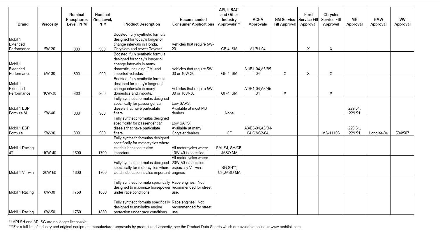

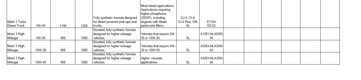

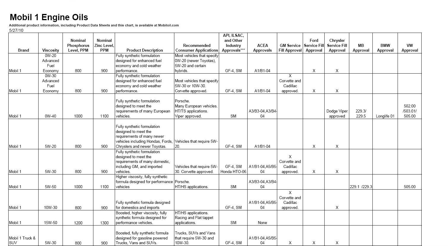

Here is a link to the Mobil 1 Product guide listing various characteristics about their products.
http://www.mobiloil.com/USA-English/MotorOil/Files/Mobil_1_Product_Guide.pdf
