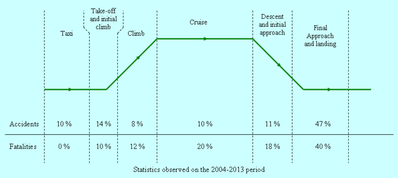

The start of a flight and the terminal phase of a flight are when the aircrew is most diligent...that is when the majority of aircraft accidents happen.
I have no training in this area whatsoever, but I would think those stats gain even greater weight when you consider the takeoff and terminal phases are measured in minute, whereas the cruise phase is typically measured in hours.
