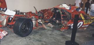

No doubt the seat belts harness, the Hans Device, and the Halo saved his life. At 50 Gs his spine would have snapped like the much lighter Dale Earnhardt crash. The seat belt harness held him in place and he was able to GTFO of there in short order. If he had been knocked out he likely would have roasted to death. The visor on his helmet was partially melted. I hope he gets that helmet back as a keepsake of his F1 career.

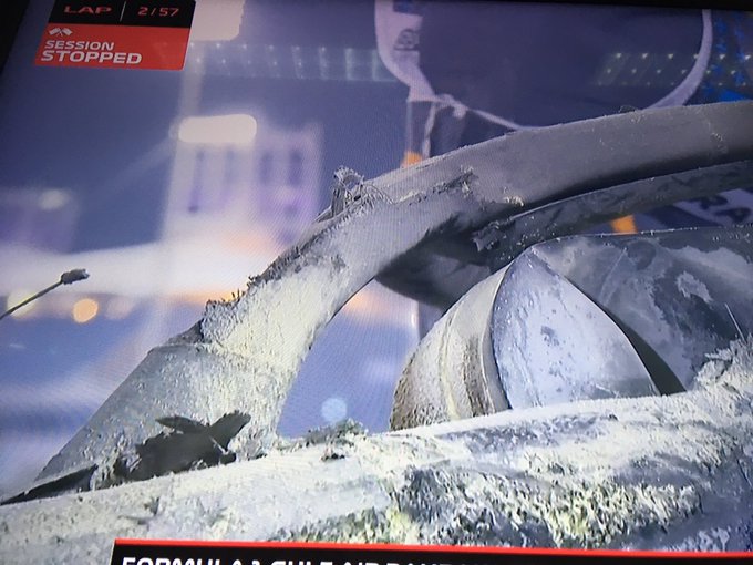

his is a significant shot - the Halo scraped and damaged after an extraordinary impact, and yet intact:https://pbs.twimg.com/media/En_-fO9XIAAux1c?format=jpg&name=small
