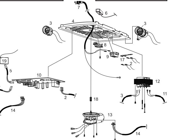

Recycled the power (as in unplugged it for 30 seconds, then plugged it back in) and tried the remote. No joy.
Tried to clear all the code programing and got no where as I couldn't ever get the 'remote' light on the opener to light up so I could re-teach it.
At least I was able to get it to work with the wall button switch again.
Guess I'll look into an upgrade like is linked above.

id be looking at the opener receiver as the culprit. check it out inside and see if there is any evidence of poor connections or blown out capacitors or something
Old 10-12-2021, 06:31 PM
Join Date: Oct 2000
Location: Nearby
Posts: 79,755
Your 315 mhz modular receiver is not working (fig 19). Check the wires/connections...replace if necessary. Easy to find. Just follow the antenna wire.

Easy does it guys. I've got one of those upgrade kits coming tomorrow via Prime. Yes, I've located the Receiver module and taken it out and plugged it back in to check connections. No joy. They are discontinued so the upgrade will take care of it, I hope.

I had this problem recently on a 20 year old Craftsman opener.
Found a Youtube video that suggested replacing a small capacitor on the board. Although the capacitor was not "swollen" like they get when they're bad, it did measure the wrong capacitance.
I replaced the capacitor for a couple bucks and all worked again.
I've got no idea if this works for your opener, but capacitor failures are pretty common and may apply.

Got the new receiver installed this morning.
Programed the new remote on the bench.
My car Homelink reprogramming was easey peasey too.
Everything is working and my garage is a lot more secure with the rolling code device installed.
Thanks for all the support here. It's always good to know help isn't far away.

I got this one off Amazon since they could deliver it in a day. Home Depot has them too, similar price, but it takes a week for them to get them.
https://www.amazon.com/Genie-GIRUD-1T-Alleviates-Interference-Intellecode/dp/B000RYV05S

The only disappointing thing about it was that the wall wort didn't have a double plug on it in case I'd needed to use it. I was able to use some contacts on the opener itself that had the needed 24V for powering the receiver unit. I didn't have an 'extra' outlet to plug the wall wort into so it worked out just fine.
