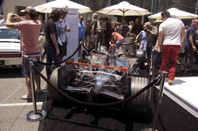

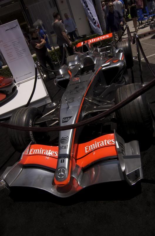

You missed the shot of the ex-Raikonnen/ex-Montoya Formula 1 McLaren that was next to this MP4-12.
edit:
http://i5.photobucket.com/albums/y18...psffbf6a71.jpg
http://i5.photobucket.com/albums/y18...psf048ba89.jpg
Banning 09-05-2013 04:14 PM
McLaren photos
Originally Posted by Noah930 (Post 7640319)
You missed the shot of the ex-Raikonnen/ex-Montoya Formula 1 McLaren that was right next to this MP4-12.
Larry didn't have any shots of the Mclaren from that event but here's a nice McLaren from another event for your pleasure.
