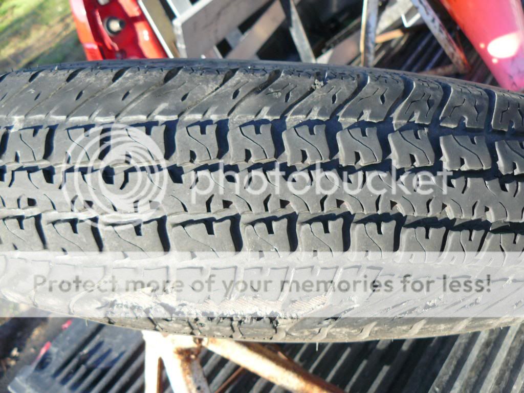

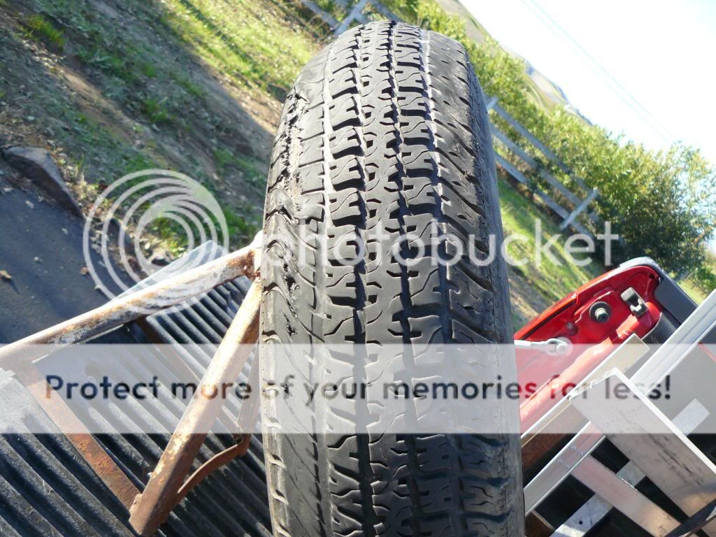

I'll snap a picture of the tire that was caught just in time...

So close!

WAG but looks to me like shifted cord from pothole or other road debris?
More wear on edges from under-inflation? Center tread looks deeper in pics.

underinflation

That wear looks like it took some time, right?
How long would it take to wear the shoulders if I drove on the tires under inflated?

what's the psi in that tire 17? way underinflated

Nope, 49.
Sidewall requires 50.

Man, something isnt right! the load isn't being carried by most of the tire!

Belt shifted. POS tire. What brand and where and when( both on the sidewall) was it built?

This is a Carlisle brand trailer tire.
11th week of '08 build date. ( 1108 )
Upon further inspection the psi is recommended at 65.
The other three are 50.
Could this happen over 120 miles?
