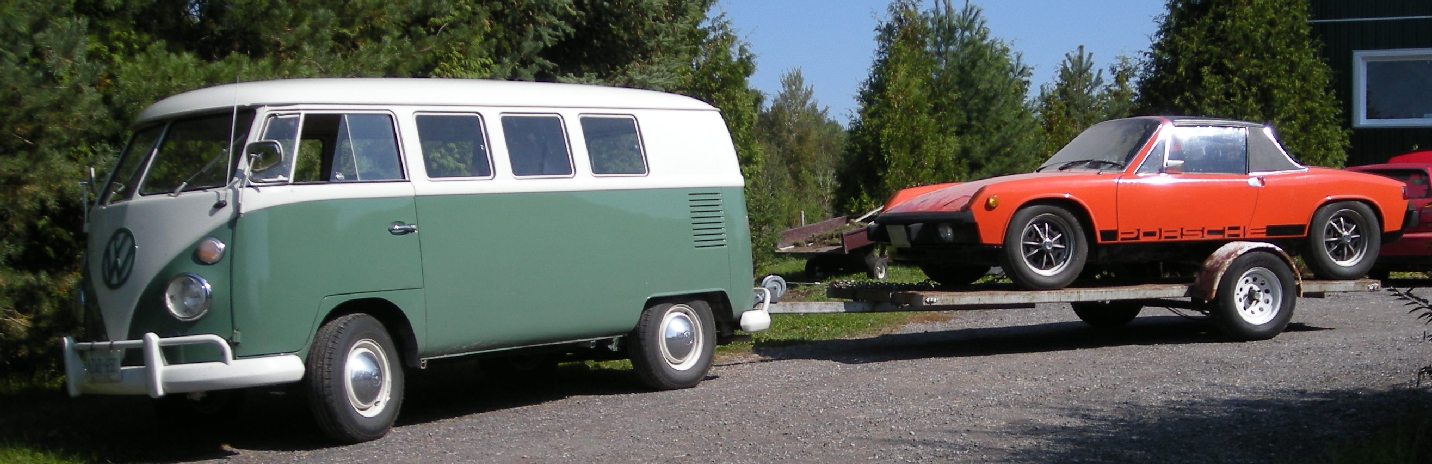

Uhaul car trailers are big heavy units, can you rent a car dolly?
This is my light car trailer behind a four banger, even this is pushing the limits.

I agree, come to think of it... back in the early 90's I towed that '67 bus (in my pic) from Manassas Virginia (BugOut) to Toronto (560miles) behind my old Toyota 2.4L(22R) 2wheel drive P/U with the same trailer.
