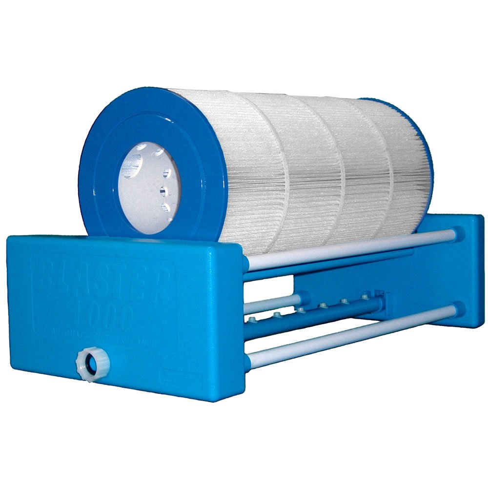

Maintaining the pool isn't hard and it doesn't take much time. I spend more time each week watering potted plants. The only PITA job is cleaning the filter cartridges twice a year. I want to get one of these:
