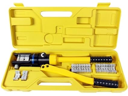

http://amazon.com/gp/product/B003X51S00?psc=1&redirect=true&ref_=oh_aui_detailpage_o04_s01

Or, for just $14 more shipped free, and no time spent hunting for used Craigslist bolt cutters, chopping up a socket, welding, etc...
http://www.amazon.com/dp/B00MVE48Z6
Oh, and it does multiple sizes as well!

$46
http://www.amazon.com/Hydraulic-Battery-Terminal-Crimper-Crimping/dp/B00GXQ2E5E/ref=pd_sim_469_3?ie=UTF8&dpID=51l68RVX9YL&dpSrc=sims&preST=_AC_UL160_SR160%2C160_&refRID=0QCRZ0BKXZF0MVFT9DX7
16.00mm2 (6AWG)
25.00mm2 (4AWG)
35.00mm2 (2AWG)
50.00mm2 (1AWG)
70.00mm2 (2/OD)
95.00mm2 (3/OD)
120.00mm2 (4/OD)
150.00mm2 (250MCM)
185.00mm2 (300MCM)
240.00mm2 (450MCM)
300.00mm2 (550MCM)

I looked at those on Amazon and eBay 'til my eyes bled.
What I wanted was a tool that would give me the best cold weld possible...and those don't.
Here is what I wanted but not for $140.
Check out those sanitary cold welds!
The Terminal Tool by IDG Inc. - Hi Res Images
