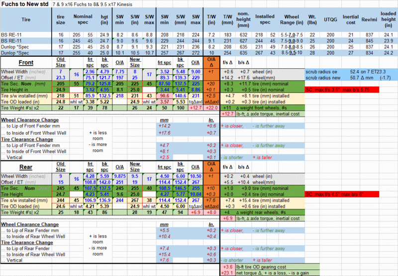

Here's a pretty much maxed out 17" fitment. This is my car and the only reason it still has 225/255 x17 is the hot rodded 993 motor in it. For a stockish 3 liter I'd probably use 7 & 9 215/45 & 245/40 x17
This is what it looks like

The difference between a 911 w/ 930 flares and a true M491 car is the rear semi-trailing arms in back and the hubs up front. Both push the wheels of an M491 out more than on a regular 911. 930s also used spacers, thru '80.5 930 used a 21mm spacer in front for '80.5 up the hubs were changed so the spacer was no longer used. All 930 use a 28mm rear spacer.
stock wheel fitment for 930 varied over the years but 7ET23.3 & 8ET10.6 or 9ET15 x16 was the basic fitment.
what you want isn't going to be done cheaply unless you want to use spacers which I would avoid.
you will want custom ET wheels, filling the appearance of filling the wheel wells comes from having the final wheel/tire front space pushed out as far as it can go w/o interference w/ the fenders. This can be done w/ either 7& 8 or 9 Fuchs + spacers or by different wheel widths & different more aggressive ETs. You still want to keep tire OD under 25", lower the car if necessary to get the look you want.
in 15
use 8 & 9 w/ 225/45 & 245/40 tires, OD ~22.7"
in 16 use 8 & 9 w/ 225/50 & 245/45 tires, OD ~24.7"
in 17 use 8 & 9 w/ 215/45 & 245/40 tires, OD ~24.6"
in 18 use 8.5 & 10 w/ 225/40 & 285/30, OD~24.7"
you can use wider wheels and tires but you don't gain anything unless you are tracking the car and you lose acceleration and braking. The whole trick is to get the rights ET for the wheel width used.

The problem is that when flares are added the results aren't all the same
I have data on multiple wheel-sets for your application
for an 11 the ET's I have on file range from -8 to -31 this gives a front space of from 6.2" to 7.1" the tires on the rims spill over a bit but not enough to account for the wide range of data.
Best is for you to determine what you have and then measure careful how much further out you want the wheel lip to be.. You'll need to know the present wheel width and ET and the spacer thickness, tire data would be helpful too.
just as a FYI one of the wheel sets I have on file is Braid 9ET-17 & 11ET-25 x17 w/ 255/40 & 315/35 tires
