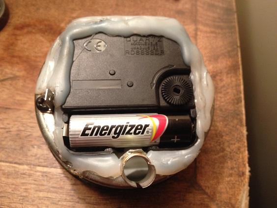

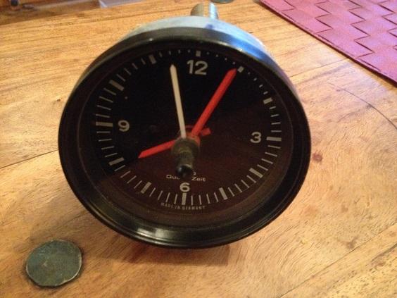

this is all nice info about the clock-repairs...i have to show you one shortcut-fix i have found in one of my friends 911;-)...i bought him new clock and kept this one;-) works perfect--

@proporsche : added benefit = no power drain from the car battery when the car is in winter sleep !
