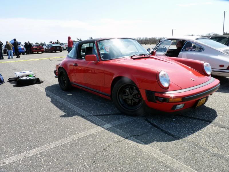

BKLYNTARGA at AutoX this past weekend.
Guards Red 964
