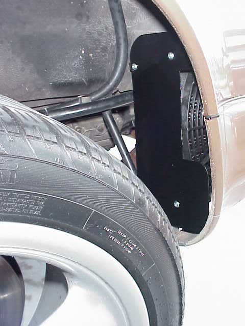

Test fit the new guard before a file and some black paint.

scottb's Avatar
Join Date: Jul 2002
Location: Southern California
Posts: 5,067
Do you want an honest opinion on the new guard?

The old guard was better.
Much!!

I agree it’s not a laser cut CAD designed pretty
... Testing in Fla heat and almost daily afternoon thunderstorms for debris pass through to the fan will tell. Ver #1 I am concerned about air flow, ver #2 was too open, perhaps a modified version #2.
