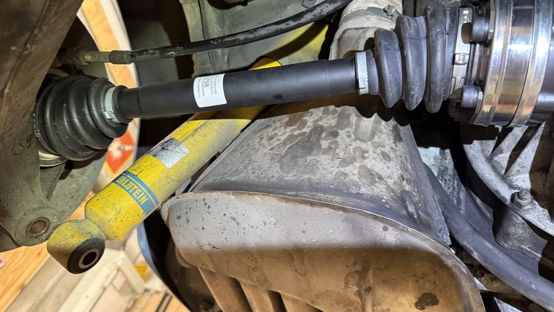

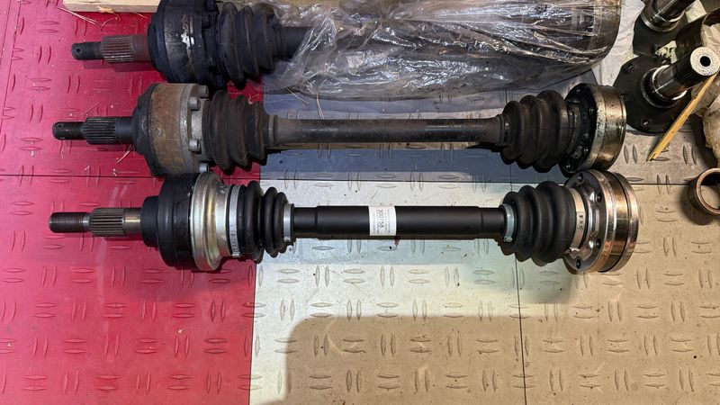

This amazing thread is absolutely overdue for a bump, and I need some help please. Following this thread and others, I decided to upgrade to the later Carrera axles on my '81SC.
To start, some info from the late, great Grady Clay from post #243:
Originally Posted by Grady Clay View Post
The 108 mm Carrera set-up
Stub axles not needed
2 each Lock nuts 900.910.093.02
2 each Axle assemblies, 108 mm CV with friction welded stub axles 911.332.024.14 (Note: superseded to 911.332.024.16.)
2 each Transmission axle flanges 915.332.209.12
12 each M10 socket head cap screws M10x50 900.067.123.01
6 each Support plates 911.332.191.00
12 each Schnorr washers M10 999.523.103.01
Please don’t take these P/Ns as gospel; there are supersessions and these might not be the right parts for the conversion. Some research help would be appreciated.
Missing from that list are the washers under the big axle nuts, 928.331.591.02. The older washers standard on the SC will not fit.
In my case I decided to buy new billet transmission axle flanges from CMS, with their spacers since I have an LSD. And while I had everything apart, I installed new wheel bearings. All good there.
HELP: New bearings are done, wheel hubs pressed back in, new transmission flanges installed, and 911.332.024.16 axles procured from our host (rebuilt GKN/Lobro, GKN part 300758.) Except... the axles are too short. Verified with Pelican that I received the correct axles, and that the GKN part numbers are correct for the application. These are not the Turbo axles. Obviously, I'm missing something. All input welcome!
Pics of the new vs. old axles:

At issue here, is that I'm upgrading to the later 108mm versions that have the stub axle permanently welded to the outboard end of the half shaft. So there is no separate stub axle with flange. And it appears that my new axles are 20mm too short.
I'm not sure I see how you could have used a G50 axle, as it wouldn't mate to the 100mm 6xM8 transmission flanges.
There were changes around '76 (by memory, it's all in this thread) to the 100mm CVs and flanges, and a change again to the 108mm with integrated stub axle sometime in 1986.

20 mm too short sounds like a lot! Are you sure about that??
Have you looked here: https://forums.pelicanparts.com/porsche-911-technical-forum/596183-cv-axle-cross-reference.html
The length of the late 108mm and the 100mm axles should almost the same.

UPDATE: I would like to formally announce that I am a doofus!
A friend asked me if I'd pulled on each end of the axle to see if it needed to be expanded a little. The thought had crossed my mind, but I had no idea that these things expand like an accordion! The CV's were a bit compressed from the factory, and with a little pull they stretched right out. In they went, all torqued up, ready for a test drive!
