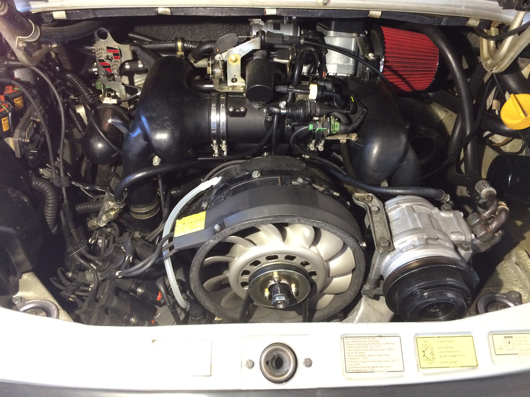

For those with a 964 conversion, can someone please tell me of your coil packs hook up to both distributors on the motor? Apparently o only have one wire hooked up and there isn’t an attachment from the distributor to the second coil pack. Thanks.
