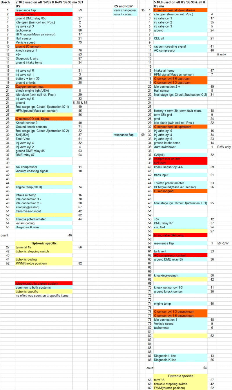

ECU Doctors has them and recommended Bosch part 0 261 204 376 with Driveblock removed. My research shows it’s for a Tiptronic 3.6. They said it should be an issue because the ECU can sense if it’s a Tip and a Tip has its own ECU.
Anyone know for sure if it’ll work ok with my 915? They said if there are any issues to send it back for up to five years and they’ll make whatever modifications that are necessary.
There are some minor differences between the tip and manual but a tip ECU will work
on a 55 pin DME I think that it is pin 44 that activates tip coding
Awesome. Thanks Bill. It’s an 88 pin but I’m just going to put you on speed dial until my swap is done.
If you ever find yourself in San Diego, you bar tab is on me.
here are the connector pin outs
trans is still #42
I think that you need #56 & 82
the tip has a different way to control idle from the manual, I think I recall a TPS and stepping motor on the throttle
