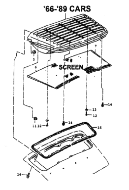

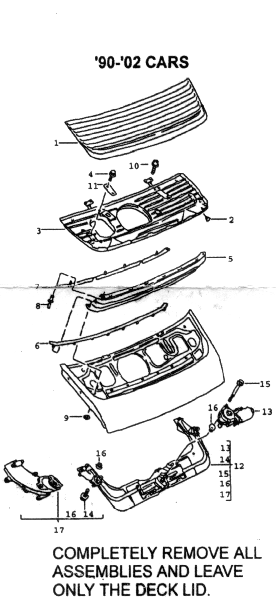

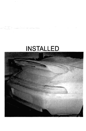

Here are some directions that came with an aftermarket tail I picked up. Install went pretty easy.
