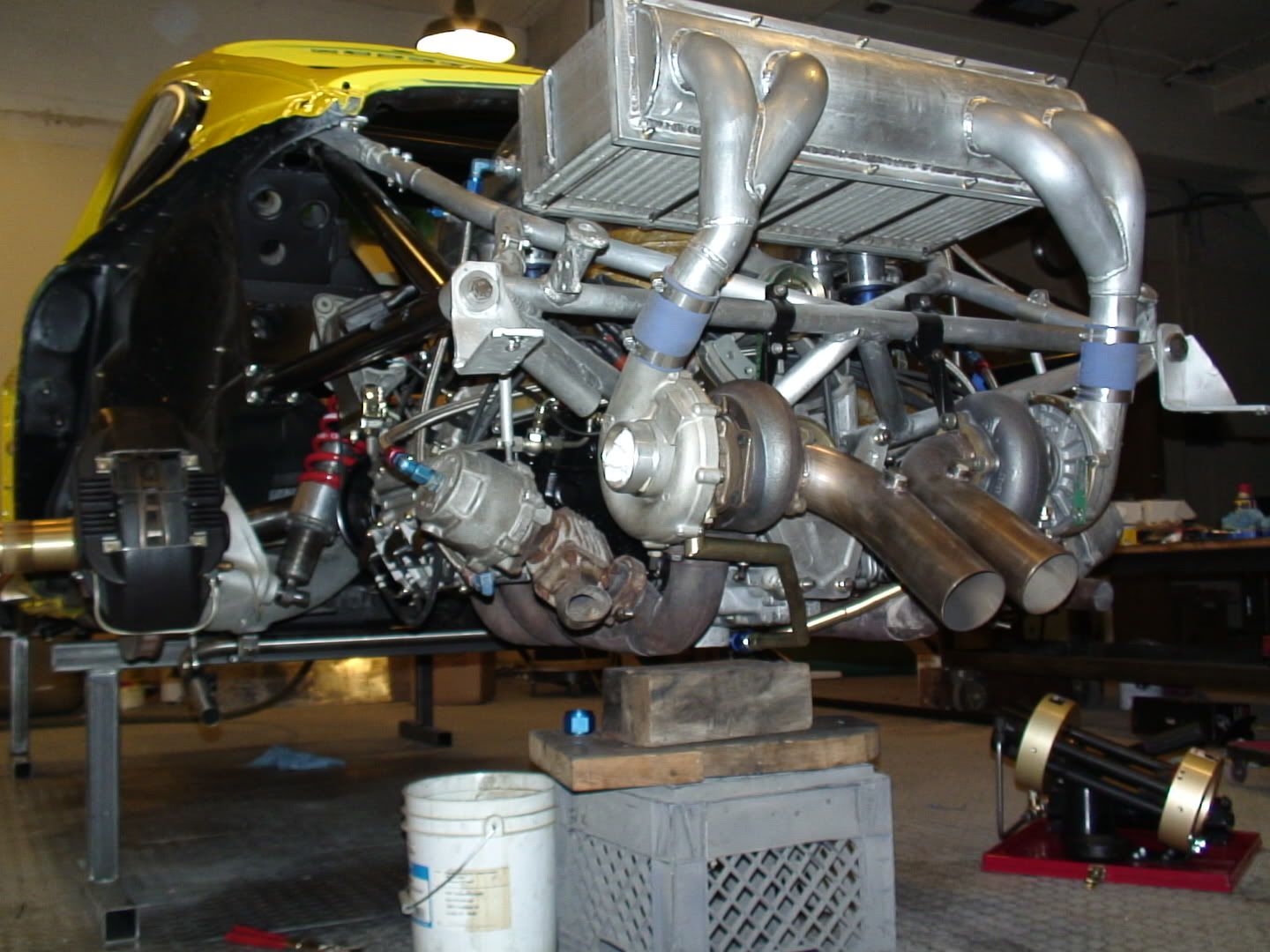

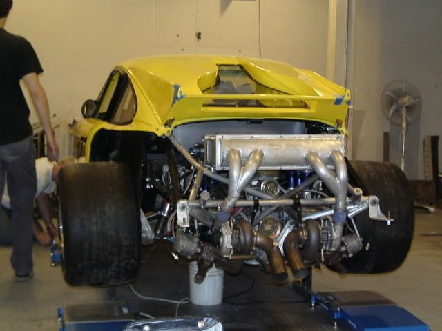

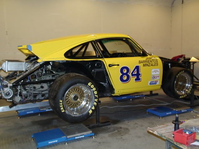

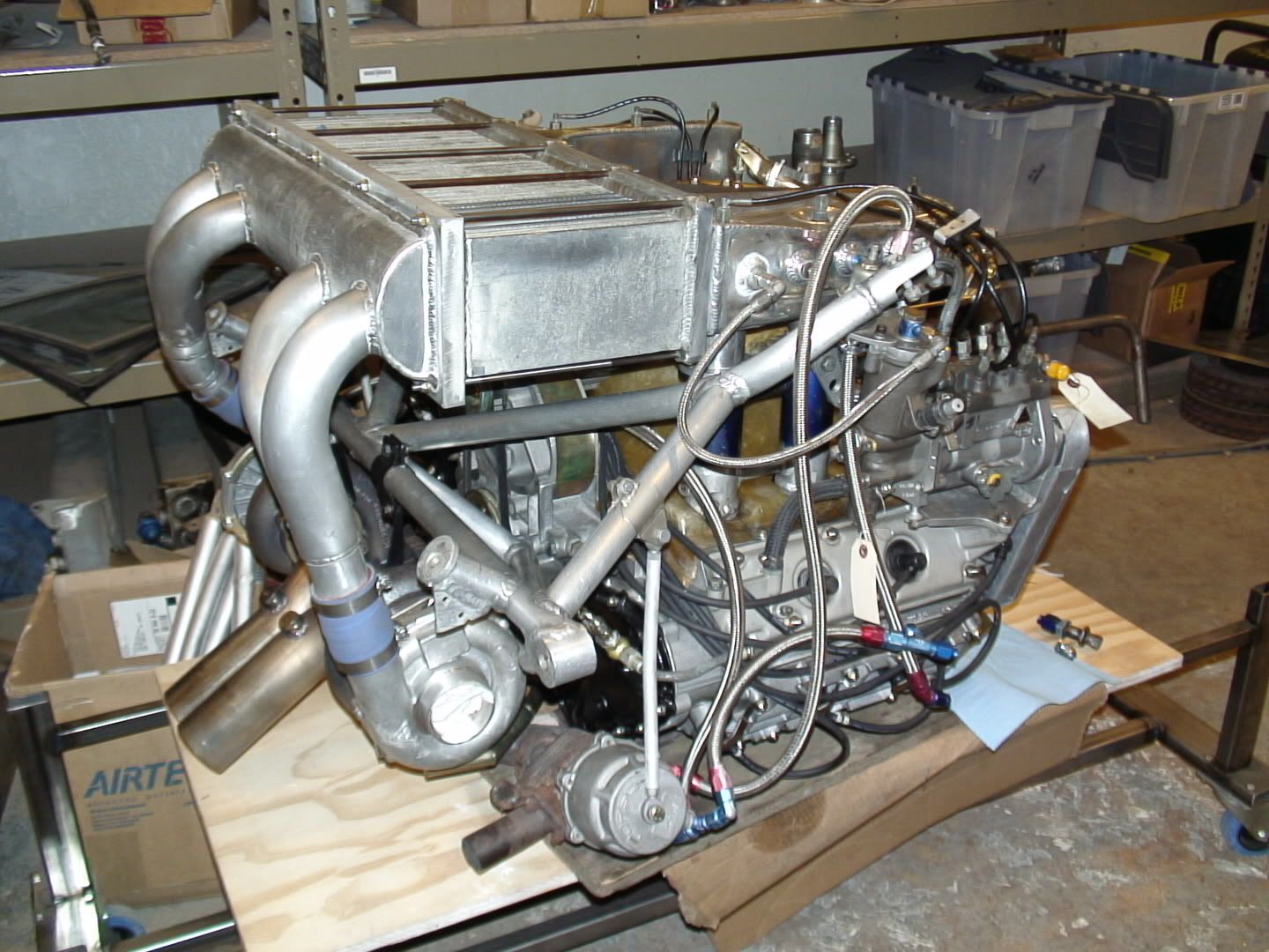

Here is an old (hijacked) picture of Stephen Kaspar's "Monster".
Very unusual placement of the turbos.
What are your thoughts on this configuration?

Well that config looks like it would certainly fit your rear bumper as far es exhaust cut-outs go. Can't comment on the actual performance.
-jeff

Too many bends on pressure side to intercooler, IMHO.

Regarding Caspers motor. Yeah, it probably works well but all those 90-degrees bend aren't helping. Exhaust-to-exhaust has been preffered route for most aft-mounted TT desings.

I went side mount on mine because we felt it would be more efficient. I have relatively small turbos but I did have to do some frame work to make everything fit. Here are photos of my two cars but if you would like more detailed photos of the side mounted Turbo set up I have plenty just PM me.
Though I know these are extreme examples they may give you some more ideas..I do think the rear mounted will be easier and better on the budget .

Monster has a LOT of plumbing. My vision is simplicity. I believe this can be done with a lot less fuss.
