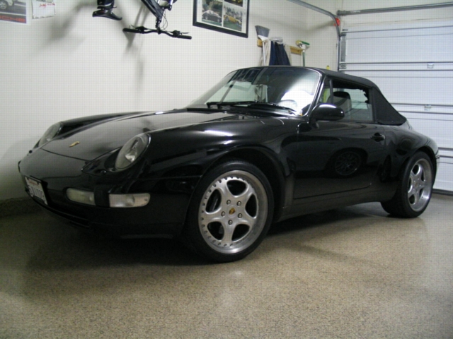

I was going to ask about the flooring it looks almost like industrial covering. looks great

Old 10-25-2006, 10:24 AM
Location: San Diego CA
Posts: 697
Thanks... the floor was spotless when the garage queen lived there. Not so much any more.
I sold the 993 to buy and build the RSR clone... I miss it, it was a fun car to drive, and it was cheaper too!
