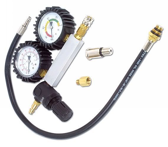

In my continuing "tool buying" mode, I've bought a set of circlip pliers, another set of combination spanners, some torx bits, a decent timing light with advance control, an innovate LM1 with the RPM kit, a leakdown tester (still unsure about this*), a dial gauge & z-block, etc etc and now I realised I haven't got a compression gauge/tester.
Is there any particular type/make of compression tester I should get, or are they all pretty much the same ?
* Leakdown tester : I have a Gunson 77005 Cylinder Leakage Tester,
http://www.gunson.co.uk/item.aspx?item=3441&cat=666 but I'm unsure if I'm measuring correctly. With #1 at TDC compression, gauge set to zero leakage, plug in the hose from ppark plug hole & get about 5% or 6% leakage.
Where I'm a bit lost is that I cannot see any way to zero the leakage gauage at anything higher than 1 bar.
I simply have the air supply from compressor directly onto the leakage tester. Mabye I should have a valve of some sort to stop the air supply & seal the gauage ?
If I leave it set at the 1 bar, and reading about 5% leakage, then turn the engine by hand, I can open a valve, hear the air escaping, and see a big value of % leakage.
That makes sense.
I just cant help thinking I should be able to do this at a higher pressure, so must either I'm doing something wrong, or my tester is faulty ?
Any advice ?
Thanks,
Declan
1975 911 2.7 Coupe

I have the same gauge. I, like you, originally thought that I would use 100 PSI (makes the math easier) or 80 PSI (the old aircraft standard) but in practice I wasn't able to get more than about 35 psi. If you turn the pressure relief valve higher, then you can't zero the leakdown gauge. This is the identical "problem" you are experiencing.
In truth, it's not really a problem at all, the gauge gives very accurate leakdown numbers using the lower pressure. Some (Grady) advocate using very low pressures anyway, because 1) less tendency for the engine to rotate off TDC, opening a valve and throwing the reading off, and 2) the low pressure will develop leaks that would be sealed by higher pressure. Weighing against that is the old rule of physics that says that the airflow through an orifice is directly proportional to the size of the orifice and the pressure behind it. Maybe throw a square root in there somewher. Anyway, the bigger the hole the more the flow, but given the internal violence of an internal combustion engine, there's rarely such a thing as a small hole. e.g. leakage around the rings from normal wear shows up as 3-5%, BROKEN rings show up as 45%. See, for example, this thread: Leakdown Results 1966 911 Normal
Anyway, nothing is wrong, proceed as normal. . .and post your leakdown figures!
You may want to consider using a piece of tubing, plastic or metal, around the 14mm hose that threads into the spark plug hole-- this makes it easier to wind in there. Also, try spinning the hose with one hand and guiding it in with the other-- you'll get the hang of it eventually. Finally, I use a "whistler" compression tester that's been cut off and the hose slips over the small quick-disconnect fitting that goes into the tester-- makes it much easier to identify TDC on the compression stroke. Then again, if you see 100% leakdown, rotate the engine away from TDC OVERLAP. . . and hold the Guinness till the job is done!
Good luck!
