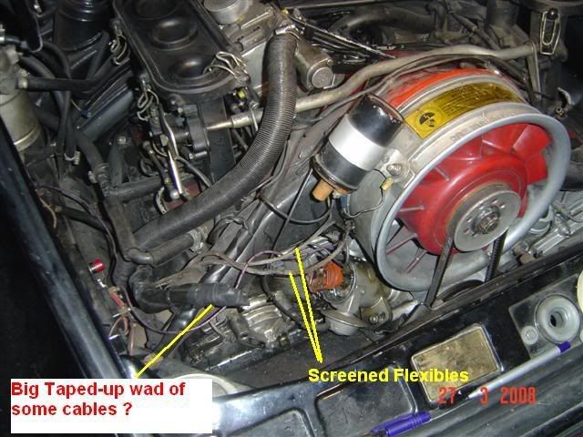

Ack, I posted a big long reply here and I'm sure it appeared but its gone now

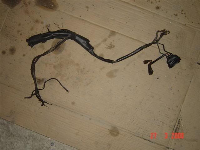

Basically, what I was saying was that I can't locate a Z-block here to measure the cams, so I'm going to order from our host Also going with an LM-1 & rpm to help with my adjustments.

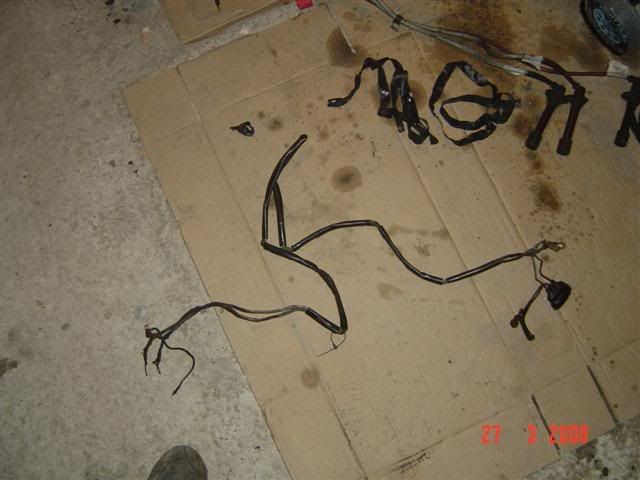

I decided to have a look at plug leads and in the process I noticed some other screened cables and "something" all taped up.
I found the screened cables were from coil & points back to CD unit.

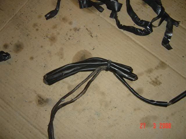

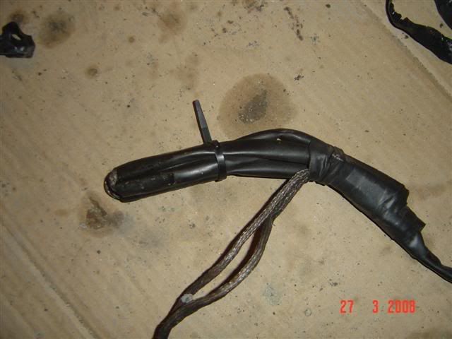

The "big taped up thing" had me puzzled. Some mysterious porsche technology I knew nothing about ?
I got the cable assembly out
untaped it
untaped some more
and ended up with this
Crazy !
Is there any need for screening of these cables ?
I noticed an unscreened cable from the CD unit spade connector over to the fan housing, earthed with the same earths from the other screened flexes. Does that make any sense ? Any reason for that ?
Staying on electrics, there is a push-button switch on that electrical panel, with a figure-of-eight cable (like thick speaker cable) that disappears off into the body work on the right hand side. What is the switch for ?

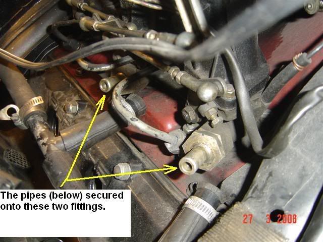

Lastly, there is a largish pipe which comes from two fittings on the throttle bodies for cylinders 1 & 2. I didn't trace the other end of the pipe. What is it ? Vacuum ? Why such large pipes ?
Thanks.

Declan,
OK, I can answer some of your questions.
The plumbing at the #1 & #2 intakes is originally for a Sportomatic transmission. Do you have a Sportomatic? Occasionally these vacuum ports are used for the ‘power brakes’ but those start in ’77 and aren’t normally on a ’75. Is the vacuum system hooked to anything? If not, we need to plug the ports in the throttle bodies.
If those vacuum check valve ports are open to the atmosphere, I think we found the source of the ‘popping’. They are drawing air at idle, causing #1 & #2 cylinders to be exceeding lean – thus lean pop. If this is the case, I suspect you will find only #1 & #2 cylinders popping through the intake.
This also skews the overall mixture readings. Two cylinders are very lean and the other four are too rich. First plug the air flow to these two check valves. I’ll bet the ‘pop’ stops and the mixture settles down – still too rich. This may be the ‘big deal’.
I’m somewhat surprised at the length of the harness to the CDI. I wouldn’t be surprised to find this was a harness for some other car. The shielded wires are necessary for Radio Frequency Interference (RFI) suppression. The 3-pin Bosch CDI has very fast risetime. Porsche (and Bosch) did this to overcome plug fowling. Fast risetime translates (with Fourier expansion) into very high (radio) frequencies. The braided shielding is to prevent interference with nearby radios, including the one in the 911. This RFI can even self-induce the CDI to fire multiple times.

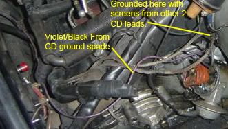

Please post images of the other braided cable from the CDI box ground to the fan housing. This may be an attempt to reduce RFI.
It is useful to check some other grounds (‘earth’ connections). Is the braided ground strap between the transmission and chassis in place? Is there a braded ground strap between the CDI and the ground connection on the left inner fender (behind the CDI)?
Regarding the wiring, the ignition pulse from the CDI box to the ignition transformer (‘coil’) is about 400 V! There used to be a warning decal on the ‘coil’. Touch the lead and it will knock you across the room or worse.
The push button switch on the electrical relay panel is not OE Porsche. I suspect it operates the starter or something in the cold start circuit. Follow the wires.
When your MFI is adjusted correctly, you will need the cold start enrichment to easily start at anything below about 70F. Without it you should not be able to start it at 42F. This is an indication as to how rich it presently is operating.
Change the oil. Smell the petrol in the oil!
Best,
Grady

Thanks Grady,
I do have servo assisted brakes. The rubber pipe from these disappears off into the body from the engine bay, haven't looked for the other end yet, but I guess its vacuum for the brake servo.
Edit: Confirmed. Pipe does go all the way to the front to the brake servo
OK, the multiple CDI firing is my only concern. I'm not at all interested /worried about radio interference.
I guess I just shorten those two cables to required length.
The other ground cable from CDI unit to fan housing is a simple violet/black flex, I'd guess about AWG18. No screening, and not routed with the other screend cables. (see pic)
I have not yet checked for braided starp from transmission to chassis Will check this evening. Any pointers on where exactly this should be ?
There is a braided ground strap between the CDI and the ground connection on the left inner fender (behind the CDI)

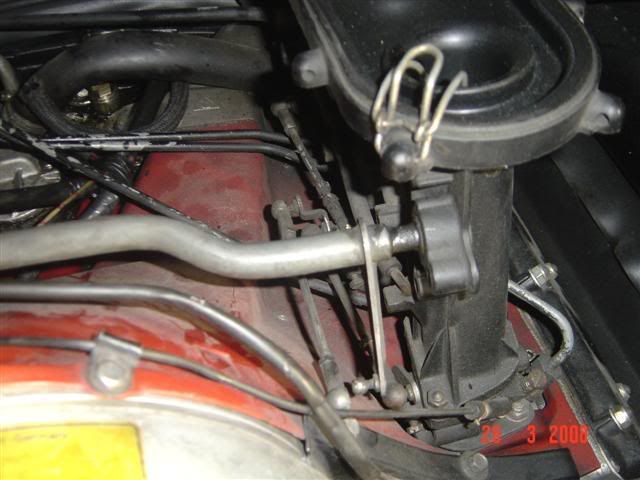

I checked the length of the link to the mfi pump. exactly 114mm centre to centre, so thats good.
I have a problem where the throttle linkage does not fully return to the off position. It returns almost fully, but not enough to operate the microswitch.
I disconnected the two links to the throttle bodies and checked them for binding, but all seems free.
I removed the throttle cable link also, and it seems very free to move by hand.
The deflection roller seems free enough to move, no binding, but the end of the helical (?) spring seems to pop out of its holder very easily, so there is no return effect at all.
Even with the spring reseated properly, it's enough to move the deflection roller back to rest, but not enough to operate the microswitch.
- Should it be enough pressure to operate the switch ?
I did try getting one more turn on the spring, but the end just pops out of the hole again when you move the deflection roller.
I noticed there is space for a second spring on the right hand side of the deflection roller, but none is there, which seems correct

I think you need a new spring to really fix this problem.
My spring was strong enough but the microswitch was not being triggered by the retuned trottle arm. I tested the switch with a volt/ohm-meter and it functioned electrically. I could hear it working mechanically so all I had to do was to adjust the screw which contacts the microswitch button. It is located on the end of the throttle arm. In a similar way to adjusting the valves, screw in the adjesting screw on the throttle arm. This will make contact with the button earlier and put the arm in a position where it recieves more force from the spring, solving the problem.
If the microswitch does not read infinate resistance when open and near zero when closed, the switch is bad. You can pick up a suitable replacement from Radioshack or Newark Electronics or similar electronic parts suppliers.
Don't go to the dealer It wll cost 8 times as much. Just take the switch into the local Radioshack and tell them you need one of these.
Edit: I don't have a spring on the passenger side of the throttle crossover linkage, either.

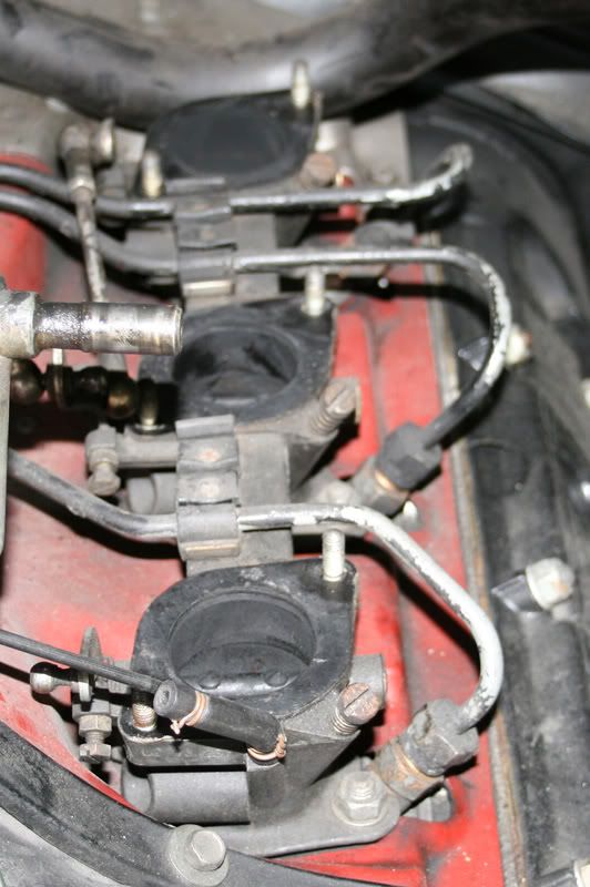

I decided to have a look at the throttle bodies, so started trying to remove the right side.
Got the stacks off but ran into a problem trying to take the pipes off the injectors. I cant budge them. I presume they are a "normal" thread ? (clockwise tighten, anticlockwise loosen ?)

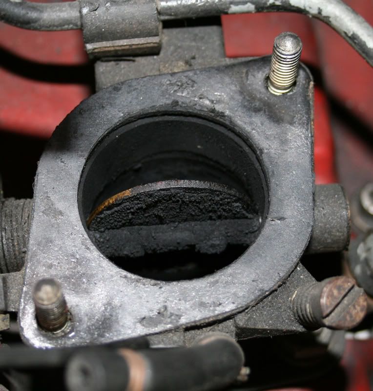

I did get a good look at the butterflies and the underside of all 3 are very dirty. (Pics below) I guess I need to persevere & get them off for cleaning ?
They do move freely, no binding, no sticking closed, so at least thats something.
I did notice, however, the spring on #5 is not as strong as the other two springs. It does close the butterfly, but not with the same force as #4 or #6

OK, Today I persevered, and managed to get the pipes off the injectors, and the throttle bodies off one side (4,5,6).
They are (it is ?) very dirty, and will take a lot of cleaning.
I Measured all 3 at around 37mm. mabye a point or 2 more edit : more like 36mm, see later posts ...

The main throttle return spring is the one on the pump itself. It is quite a stiff spring and, if it is not returning the whole works to the idle position, none of the other springs will, either. The one spring on the rack and the six on each butterfly are very weak, and are only really meant to take the slop out of the system that is inevitable with all those ball cups, pivots, and such. They are not meant to, and will not overcome any binding in the rack or throttles.
All throttle bodies are tapered top to bottom. You have the standard S/RS sizes. It's looking more and more like your motor was properly converted to an RS spec 2.7. That's good news.
Looking at the state of those butterflies, it's a minor miracle it ran at all. If they are that carboned up, the air bleed ports are probably all but shut. Soak those things in some Berryman's for a week or two to break up all the carbon. Don't stop cleaning until they are well and truly clean. Keep at it until the bypass passages are open and the butterflies move freely. That will solve a lot of your problems.
Make sure all of the stops are adjusted properly as well. The closing spring pressure should not be taken up by the butterfly resting on the side of the bore. They do have to fully close, but that is different than bearing on the bodies under spring pressure. If they do, they will soon wear grooves into the soft metal of the throttle bodies. Then they're toast. Anyway, unhook all of the short linkages so each butterfly will move on its own. Back off the stop screws until the butterflies rest, when closed, on the bores. Then turn the screws in just enough to take the spring pressure; you don't want the butterflies to move. You should be able to hold them up to a stong light and not see any light around the butterflies when you are done. Set the two short rods (from the center #2 and #5 to the fore and aft #1, #4, #3, and #6) so there is no preload with all of the butterflies shut.
