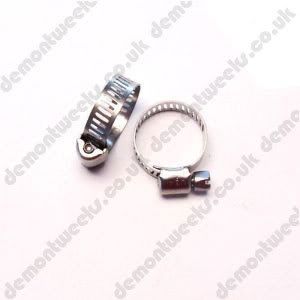

I forgot to add... re the Norma-Schellen clamps for the fuel hoses ..What exactly do they look like ?
I found Norma-Schellen like this :
compared to what i know as "normal" hose clamps:
Am I correct, (top pic) or are the correct Norma-Schellen clamps different again ?
1975 911 2.7 Coupe

Yes, these are the correct clamps for when you button everything up after testing.
Any clamp will do for the tests so long as your hoses aren't damaged and no leaks.
The 1 bar pressure is probably right at the service limit for these 'regular' hoses. Anything we can do to prevent a fuel leak may save the car someday.
The OE N-S clamps are one way.
Periodic hose replacement is another.
Best,
Grady
