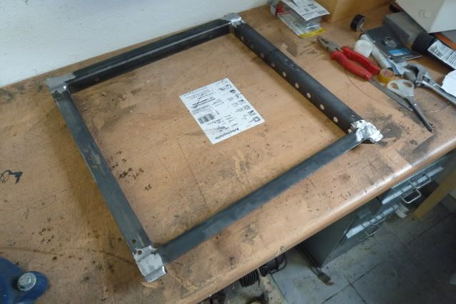

I eventually got round to picking up some welding gas. First job was to make the seat bases.
I kept the original early slider bracket (on the sill side) and constructed a basic square frame, with additional weight saving holes drilled
Clamped and tack welded in place...
Finish the weld and clean up
I got hold of some later sliders. They required alittle bit of drilling to fit the seat base, but now fit into the new frame and seat base a treat.

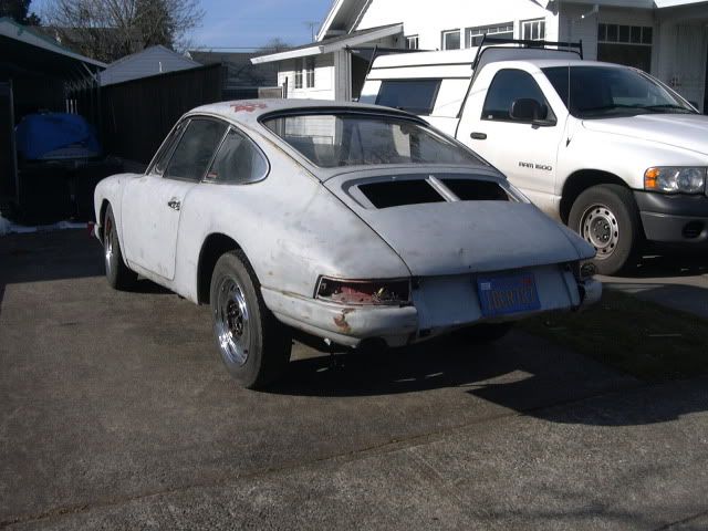

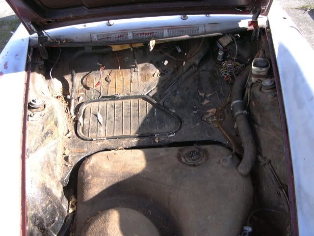

So I was kindly sent some pictures from David, aka 'earlyaircooled' of the car as it was when it arrived from California (California = no rust???).
This is how I bought it, what was I thinking!
Irony being, its now pretty much the same colour
Chris

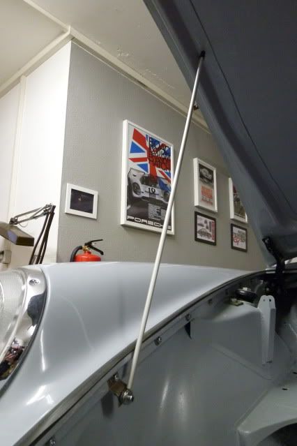

Not the biggest job in the grand scheme of things...but its looks abit better than the length of wood, and also allows me to get the petrol tank in and out easier during welding
Chris
Old 01-19-2011, 09:43 AM
  Pelican Parts Catalog | Tech Articles | Promos & Specials    Reply With Quote #255 (permalink)
Dave Hanning
earlyaircooled's Avatar
Location: Portland, OR
Posts: 4,396
That was just surface rust.......right Chris?
I like the hood prop, another nice invention.
Looks like primer gray may have been some inspiration for the color, good choice.
All of us with this "disease" see the diamond in the rough....I have a bad case of it too.

Me again....unless I am mistaken your seat bracket fab pics show the "L" shaped lever arm for fore/aft adjustment....to be on the tunnel-side slider of the driver's seat. Why?.....wouldn't it be better on the left-slider side, nearer the door?
Wil Ferch
85 Carrera ( gone, but not forgotten )
Old 01-19-2011, 10:11 AM
  Pelican Parts Catalog | Tech Articles | Promos & Specials    Reply With Quote #257 (permalink)
BoxsterGT's Avatar
Join Date: May 2004
Location: New Hampshire
Posts: 6,132
Its on the tunnel side so you don't catch it with your shoe while swinging your legs in & out.
Len
Old 01-19-2011, 10:50 AM
  Pelican Parts Catalog | Tech Articles | Promos & Specials    Reply With Quote #258 (permalink)
jury's Avatar
Posts: 323
Send a message via Skype™ to jury
Len
Yep, thats it. Good point
Seriously though, theres no particular reason. Its far enough under the seat that it does not interfere with the gear stick or hand brake, yet it works fine.
